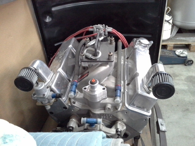

  2. DDDenny
    Posts: 22,956
    Like this?

  3. 54FISH
    Joined: Jan 10, 2011
    Posts: 425
    54FISH
    Damn ,that things breathing more than mine for sure! Lol. Never saw breathers on valve covers like that.
