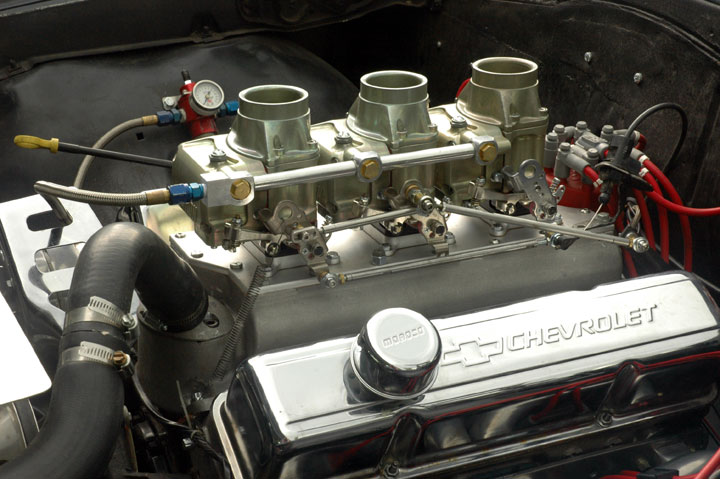

    If you go with dual carbs you will want to stay real small on the cfm on them but if you want to go with 3 of the 3 bolt carbs I think those would work fine on it. Here's a pic of our AeroRam with 3 of them on our Chevelle test car and definitely go with progressive linkage.

    That was the old Cross Fire Injection . I had thought the same years ago but when I got one of the intakes in my hands and pulled the top off the runners are tiny and I do mean tiny.

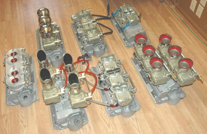

    Here are several different ideas for multiple stuff including a 6-2 .
