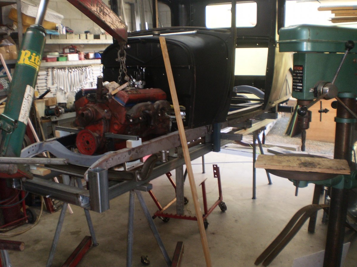

    I need high engine mount to clear the steering box on my A model. I found this picture in my file but can't remember where it's from but probably the HAMB. Anyone know if they are something available or custom made? Probably going to have to make my own that will do the job but they won't be as nice a job as these. So cal and a couple of others have a similar thing but the horizontal plate is too low for what i need. I have the engine as far forward as I can to try to keep the firewall pretty much uncut. Thanks, John. engine mount_o.jpg
    A couple of pictures of what I'm doing.

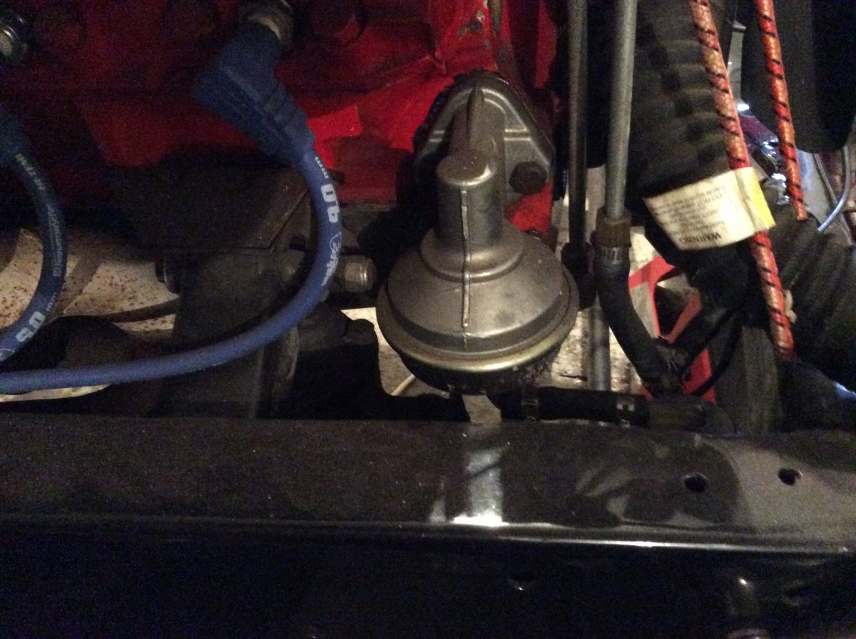

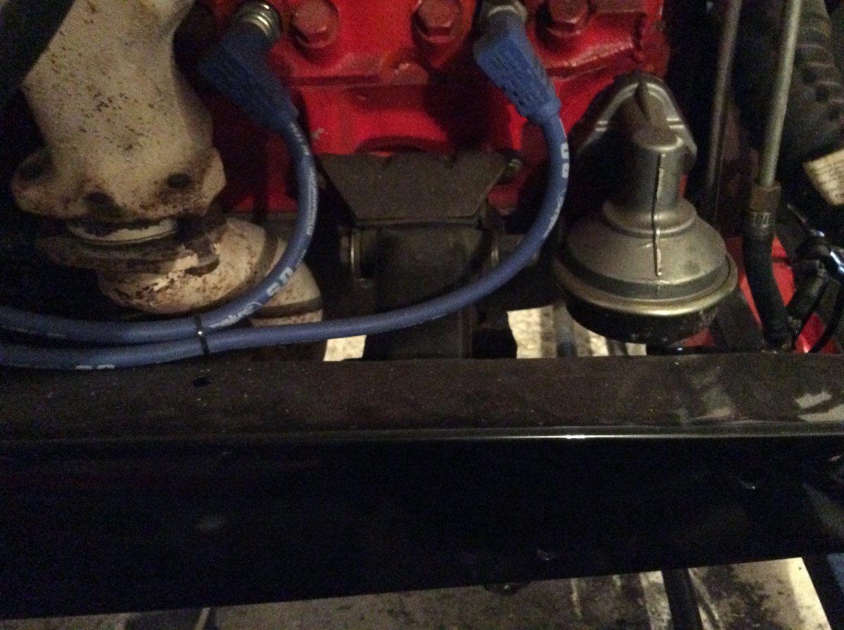

    I'd suggest a more conventional steering mount that places the box lower. You'll still have plenty of ground clearance. DSC06091.JPG DSC06094.JPG
