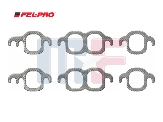

  2. Natural finish for me.. and back in the day the factory didnt use gaskets.. But I use the FELPRO ones myself.

  8. I have heard that the factory never used gaskets, but the heads and manifolds had better be damn straight to not leak. My luck is never that good. I use the FelPro gaskets mentioned above.

  18. I used gaskets on mine, they came with the Dart aluminum head set. I sprung for good stainless bolts and washers from Ace Hardware, $36 IIRC.

  19. Buy gaskets. They are cheap and work well.
    Do Not go for "header" gaskets but the stock ones with the tin on the outside and the gasket material on the inside.

    If you have gaskets that are the metallic style shown above, but don't have the same open bottom holes; just use a pair of tin snips to open the holes up. Then you can bolt up the manifolds loosely, and drop the gaskets in place, and tighten them down.
    I'd never run a SBC without exhaust gaskets, whether the factory did or didn't. Never lucky enough to not have them leak.

    New manifolds won't be warped, so install them without gaskets. IF they do leak, then install some gaskets that come in gasket kits, that most guys don't use on their manifolds, so a shop may just give you some. I am Butch/56sedandelivery.
    Just went to the Speedway site, the manifolds come with the gaskets, so use them!

    I'm another one that uses Fel-Pro exhaust manifold gaskets.... Including with headers with or without the 1 piece header flanges...
