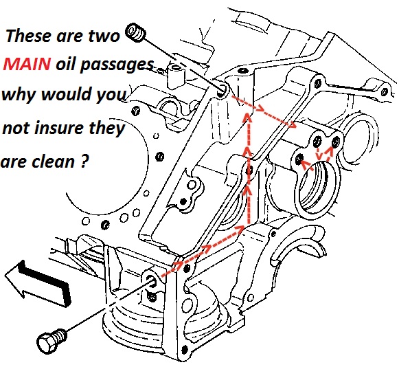

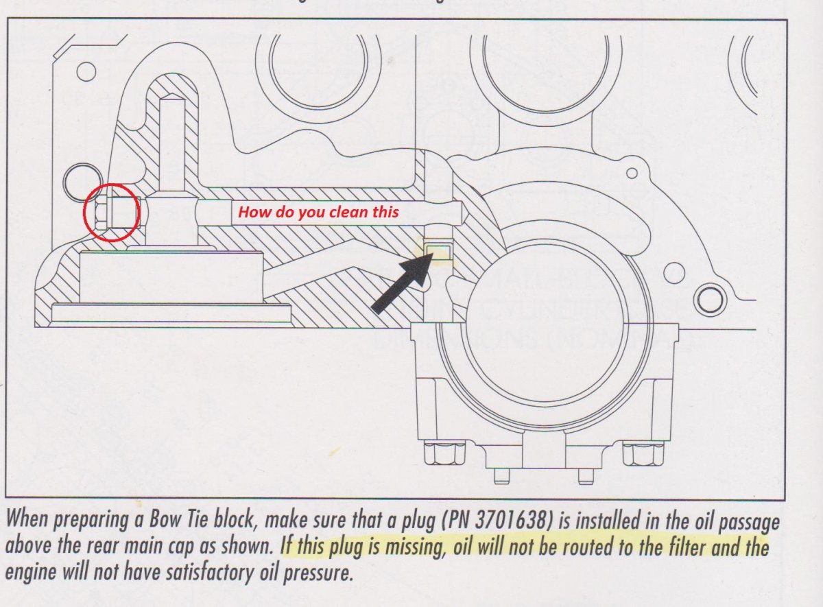

    I came across a picture of these same oil plugs in another block, possibly American made. In the picture, the plugs are threaded and have a square to allow removal. Probably most people don't remove them, but if I'm looking at things correctly, removing these plugs is the only way to get a brush inside to clean the passages......and they are important passages.
    Obviously if you want to clean the intersecting passages with a brush and also allow full circulation during any chemical cleaning process, the plugs must be removed. While not removing the plugs cause some residue to be trapped in the dead end of the sealed passage if you don't remove the plugs? The law of averages says "sometimes".......So if you want to be sure, rather than play the odds, the answer is to remove the plugs. If your engine croaks later on, would you even know that it might have been because of some trapped residue? The majority of the time, no problem......but not always. Thats my opinion anyway. ;)

    Whether some wish to admit it or not, everyone knows that cleanliness is the first priority when assembling an engine. The amount of detail and effort that someone puts forth and considers acceptable will vary, but NO ONE can ever say they got an engine TOO CLEAN. When an engine does fail because of some residue that a less than meticulous builder missed.......how does that builder identify the source of that residue? If the residue is simply some sand from the original casting process or some sludge with abrasive in it that resided in some unnoticed corner of the oiling system, or even rust that occured from storage........how does the engine builder know where it came from?
    He doesn't know. The only way to insure that this doesn't happen is to access ALL hidden cavities and clean them. The OP stated :
    Not sure who would think that flaky rust in one of the main passages from the filter should just be dismissed as inconsequential. The simple truth is that nothing may be gained in some engines, but there will be times when someones engine gets saved because they took the extra steps to insure the passages were clean.
    Now, I have provided information thats documented and available for everyone to make their own decision. Those who wish to believe there is no benefit to be derived from cleaning these passages should proceed accordingly. Those who can see a possible benefit are able to see why..........
