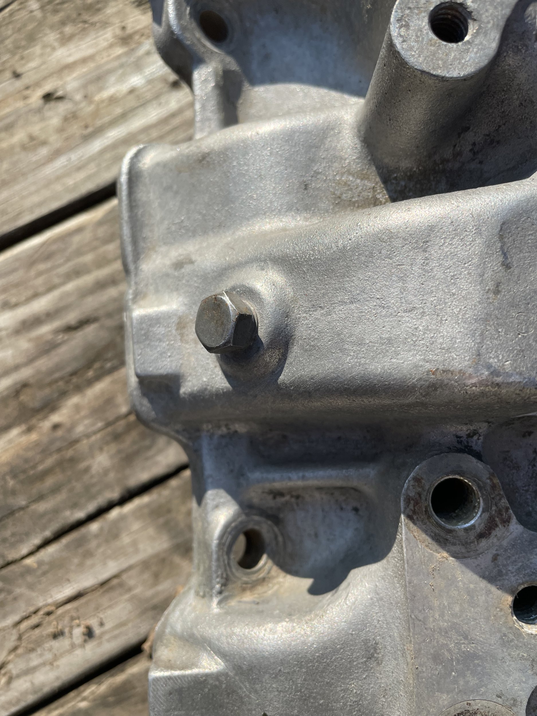

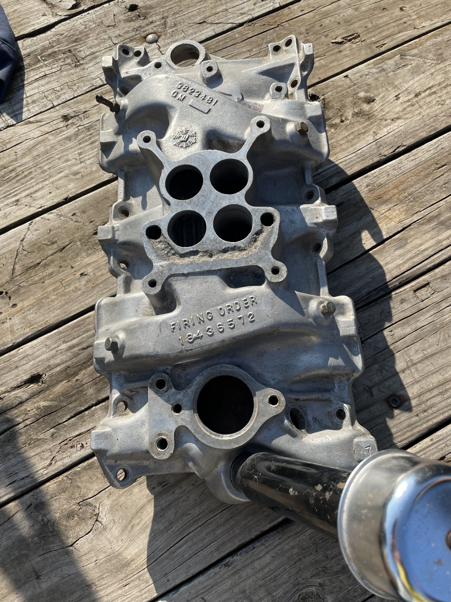

    Ok guys any ideas on this? There is a 1/8 npt vacuum port on each pair of runners IMG_4969.jpeg IMG_4970.jpeg IMG_4971.jpeg IMG_4972.jpeg IMG_4973.jpeg IMG_4974.jpeg

  2. Rumors are those are military.
    Maybe someone here knows why all the extra holes are there

    Posts: 1,060
    Hubnut
    Hey Mark, there was an old thread on these several years back where the unofficial decision was that they were military or possibly marine. Apparently the M114 was 283 powered and utilized some aluminum components according to someone on the tri-five Chevy forum who posted a picture of one of their engines.

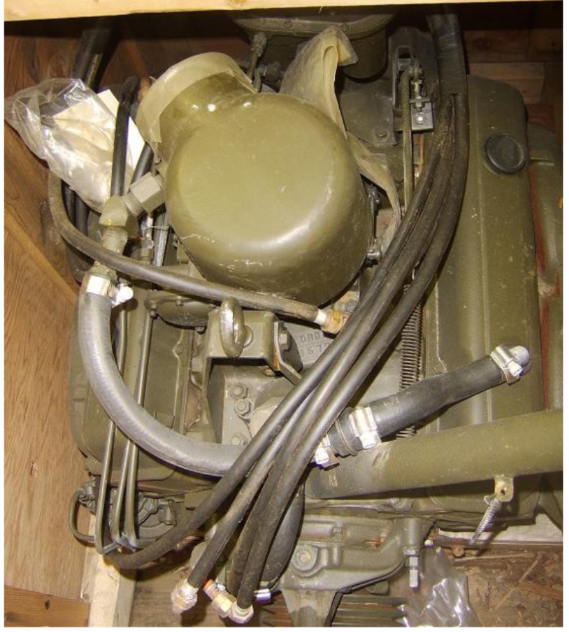

  5. Here’s a military gm v8
    The extra holes by the thermostat housing are for picking it up
    There’s a vacuum line coming from the intake runner. Or looks like it under the other lines. IMG_7554.jpeg
  6. squirrel
    Joined: Sep 23, 2004
    Posts: 59,919
    squirrel
  7. Internet rumors are a date code located under the heat shield.
    Rumors
    mad mikey, deathrowdave and Sharpone like this.

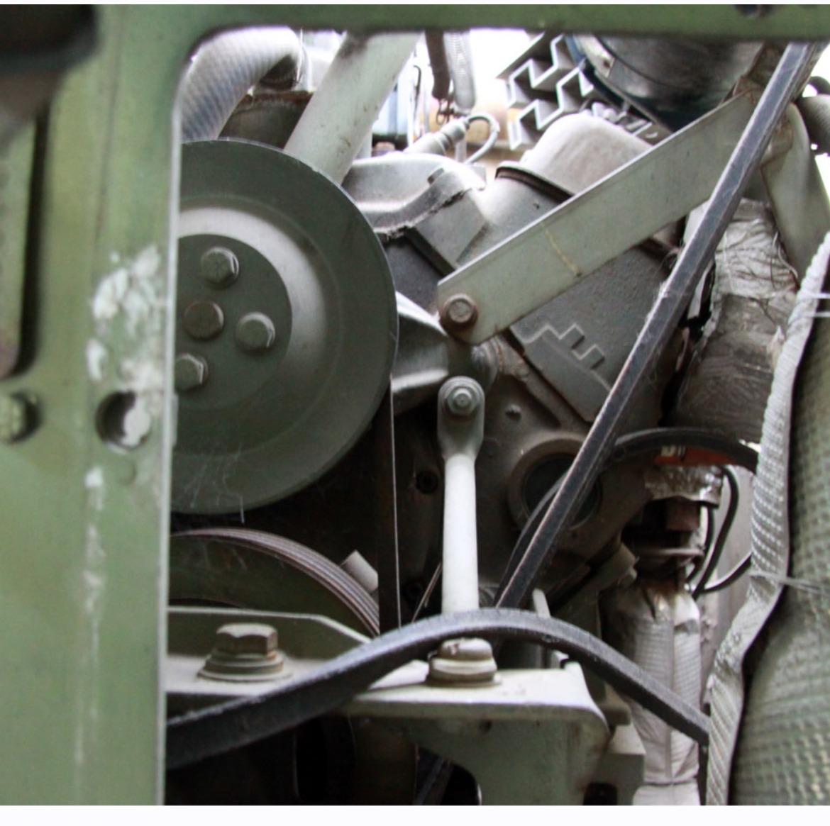

  8. M114 info.
    Engine diagram shows the ports in the intake
    not very good engine pic
    But the 2 holes next to the water neck and extra bosses behind the carb can be seen with stuff bolted to it
  9. JD Miller
    Joined: Nov 12, 2011
    Posts: 2,652
    JD Miller
  10. DDDenny
    Posts: 22,384
    Not a rumor!
  11. Fordors
    Joined: Sep 22, 2016
    Posts: 6,486
    Fordors

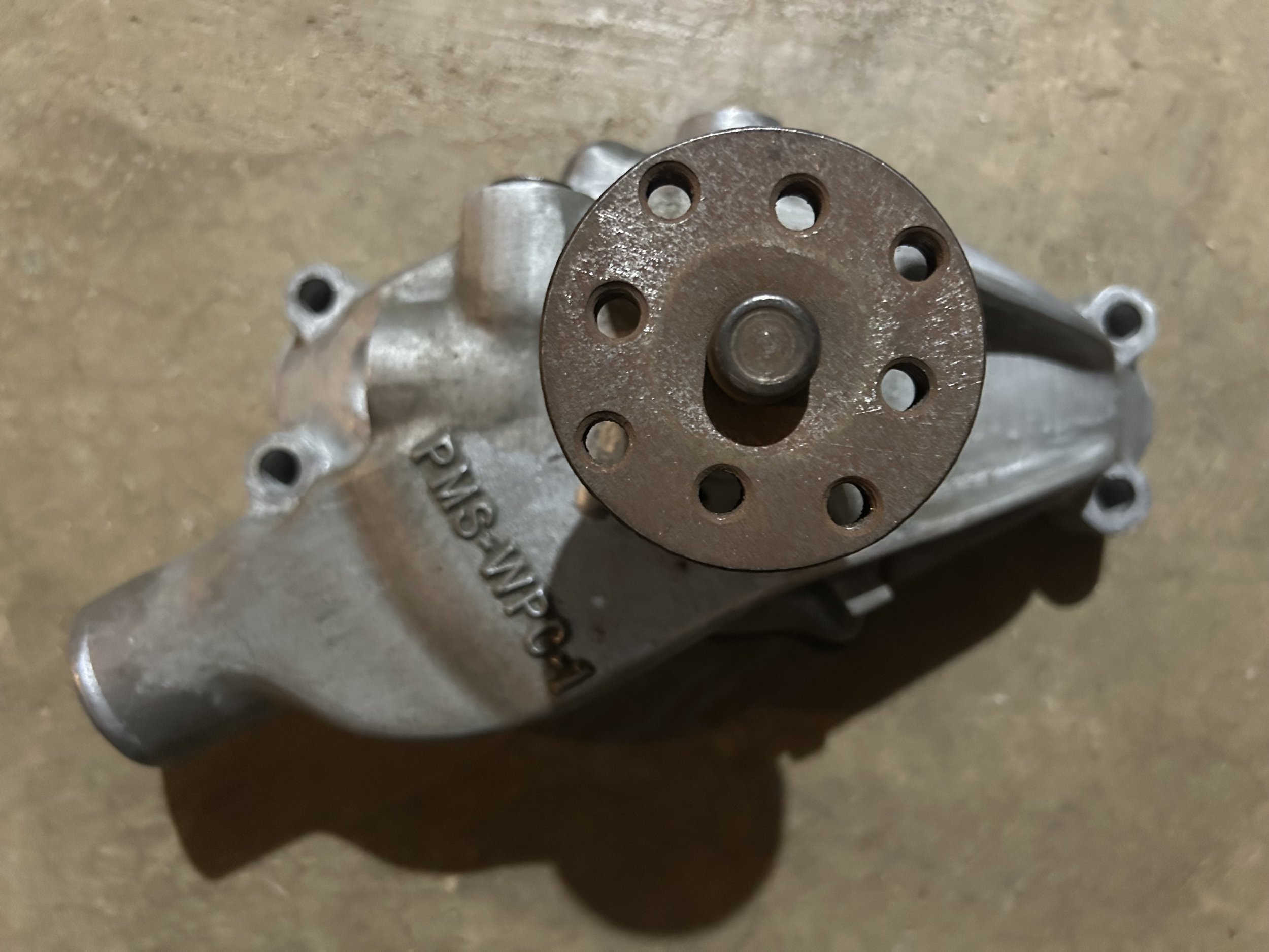

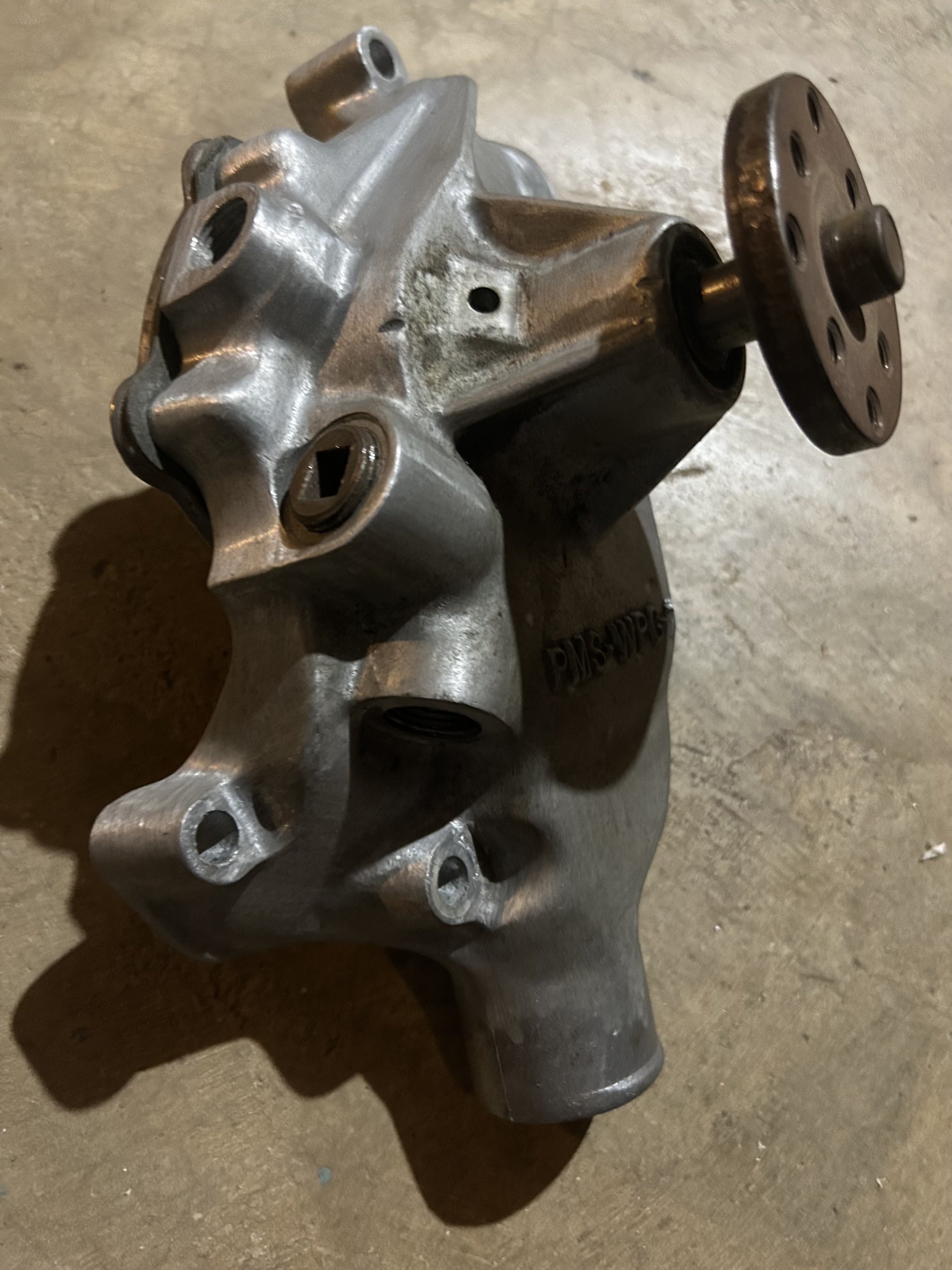

    I bought two of these pumps years ago, they were also described as being from a military application. No snowflake so they weren’t cast by Winters, but can anyone shed any light on the origin? I’ve done some prep work for polishing, it showed having been sand cast.
    Two things in particular are different, the byp*** hole on top is only 3/8-NPT and there are two 1/2-NPT (heater?) ports also.
    Bill Jenkins said it was military in one of his books.
    I just noticed another detail, the byp*** hole to the No. 2 cylinder was blocked.
  12. Sharpone
    Joined: Jul 25, 2022
    Posts: 2,910
    Sharpone
    I’m looking at the carburetor bolt pattern, What carb was used? Just curious.
    Dan
  13. Moriarity
    Joined: Apr 11, 2001
    Posts: 37,438
    Moriarity
    SUPER MODERATOR
    Wcfb
  14. Sharpone
    Posts: 2,910
    Sharpone
    Thanks
  15. Johnny Gee
    Joined: Dec 3, 2009
    Posts: 14,352
    Johnny Gee
    from Downey, Ca
  16. brigrat
    Joined: Nov 9, 2007
    Posts: 6,056
    brigrat
    from Wa.St.
    Rumors are Steve Mc Queen was in the Marine Core, ***igned to a tank, tried to hot rod the motor and it blew up, lost a stripe over the deal Did you find that tank and are adding to your collection?
  17. rusty valley
    Joined: Oct 25, 2014
    Posts: 4,325
    rusty valley
    Same engine in the M116 husky, aluminum hull amphibious troop carrier. I had one back in the 80's missing lots of parts so I moved it on.
  18. Fordors
    Posts: 6,486
    Fordors
    mad mikey, Joe Blow, Deuces and 3 others like this.
  19. Beanscoot
    Joined: May 14, 2008
    Posts: 3,635
    Beanscoot
    Too bad Gimpy no longer has access to the GM inside info.
    mad mikey, Deuces and Sharpone like this.
  20. redo32
    Joined: Jul 16, 2008
    Posts: 2,308
    redo32
    When I was a wee little lad in High School (cl*** of '67) working at the Richfield station in town, there was a guy with a yellow chopped '32 5w with what was claimed to be an original '57 Vette 270HP motor. My Corvette buddy pointed out the twin towers on his heads and commented on how rare they were. I have seen little info on the internet to corroborate.
  21. Paul
    Joined: Aug 29, 2002
    Posts: 16,956
    Paul
    Editor
    interesting
    and not all runners have them,
    only every other in firing order.
    must be to run multiple bells and whistles

    bolt pattern on the manifold is 4 1/4” wide by 5 5/8 center to center
