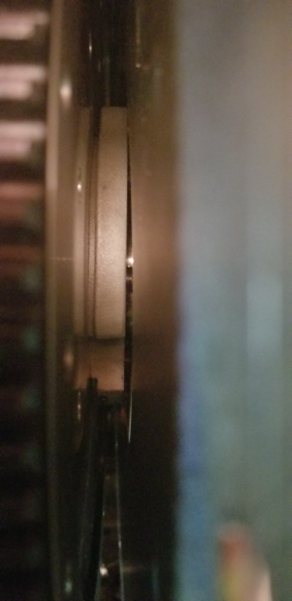

    I have a Manley forged crank 4.00 2pc. main and a mcleod alm. 168 tooth flywheel it seems there is about an 1/8th inch gap between the flange on the crank and the back of the flywheel? (back meaning toward block and not the clutch side) Is this normal was it fully seated? I used ARP bolts for hardware. When the flywheel was torqued it sat flush with the END of the crank flange and the FACE of the flywheel (clutch side) and the bolts went through if they go any further it would hit the back of the block. I only noticed the gap after I put the clutch on and starter on and thought... o_O that is strange?

  7. LTKMUNN
    Joined: Dec 8, 2013
    Posts: 49
    LTKMUNN
    from New Jersey
    20180917_142836[1].jpg 20180917_142836[1].jpg 20180917_142836[1].jpg 20180917_142945.jpg 20180917_142804.jpg

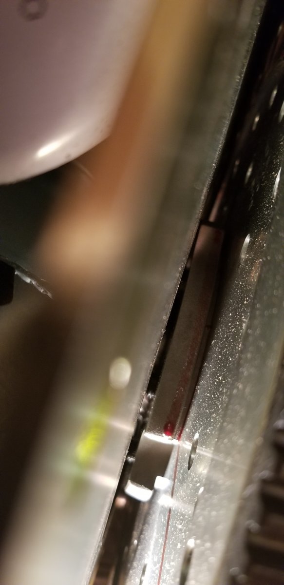

    Dont get confused with the block plate for the ****ter shield. But the Crank flange has the drop of lock tight dripping down on it on to the flywheel. you will see the gap.

    the bolts are tight and they they all went on easily they did not hit the block. I just took the PP and clutch off and the weird thing is the flywheel IS sitting flush up against the flange because there is no gap between the dowel/roller alignment pin. But why would there be a space in the rear? Does everybody understand now? hahaha 20180917_152408[1].jpg

    are you talking about the gap at the counterweight?

    Maybe it's just the chamfer on the crank? The gap I see in the pic looks like something on the block side, like back of the crank and something, I can't tell. It's like an illusion!!

    yeah the gap on the counter weight maybe its the way its machined. I know its hard to tell let me edit one of the pics. The block plate is just hanging on the dowel pins done worry about that that's why it looks crooked. Its seated flush.I just want to know what the gap is? flywheel updated Write.jpg

    The machined flange that the f/w seats against is proud of the counterweight, I believe what you are seeing is the gap between the counterweight and the flywheel. I think there is no issue.
    When I first looked at it I also thought the f/w was ****ed, but your photo with notations cleared that up.
