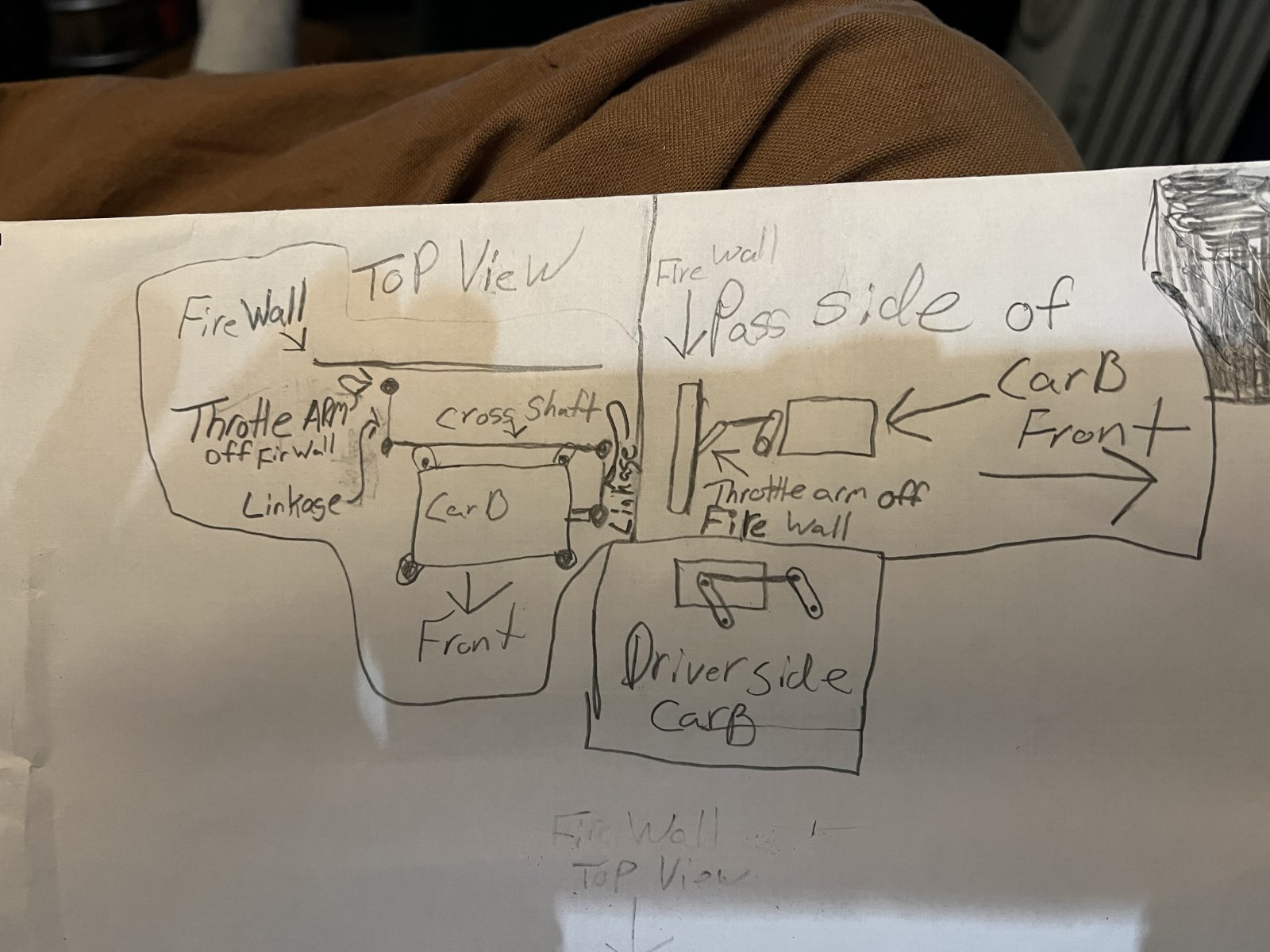

    Simple Bell Linkage can solve the gas pedal arm if like 32 Ford Leaver ball / arm on p***enger side off fire wall ,
    Here is a quick scribble of a drawing see if it makes sense to you for linkage
    Requires/ make usable

    Thanks for the drawing! I understand the concept and what it would take to make it, not a problem. The issue is there just isn't enough room. I could move the coil which is mounted between the dist. and the carb but still the distance is very short and then there is the issue of how to mount the pivots for the cross shaft. It would cause alot of clutter on the top of the motor. I think a better idea might be to get an extended throttle shaft , like if you were building a multi carb setup.Just mount a pivot arm and ball on the end that extends , which would be on the p***enger side ,and still use the existing throttle linkage . Thinking about it, i may just order the parts and get that question out of the way ( the question of carb orientation). I hadn't thought about it that way until you mentioned the bellcrank idea. Thanks !
