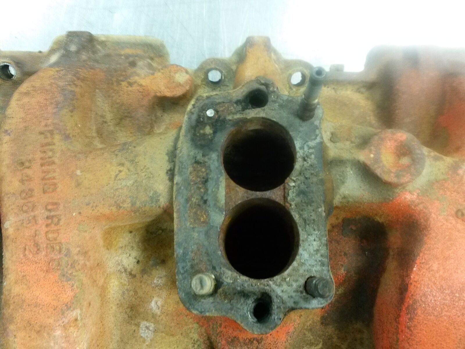

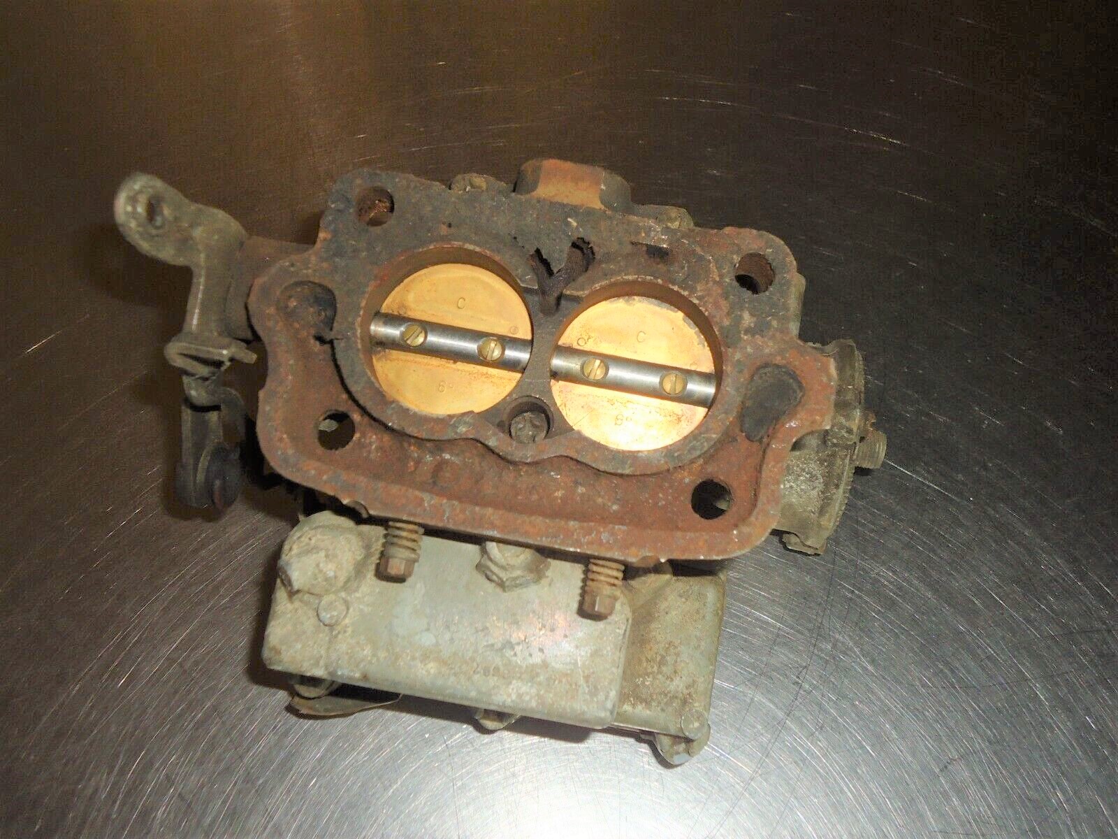

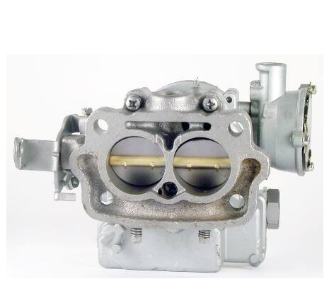

  7. Mr48chev
    Joined: Dec 28, 2007
    Posts: 36,023
    Mr48chev
    One thing, Can that carb actually be reversed on that intake and not have a hidden leak or not have exhaust get into the intake if you don't plug the crossover holes. Will the throttle plates open up all the way without hanging up?
    This is a collection of photos of a 62 283 intake and a crusty and a clean 62 two barrel base. I'm not positive that you can actually get away with reversing that carb on the intake and not if you don't plug the exhaust cross over holes in the intake.
    Last but not least, an unplanned restriction in the fuel line, squashedhose or tube, kinked hose or tube. Gas cap that isn't venting that shuts off the air going into the tank so that it creates a vacuum in the tank that overcomes the fuelpump, The more gas in the tank the faster it acts up.

  9. jailhousebob
    Joined: Jun 18, 2009
    Posts: 898
    jailhousebob
    from Illinois
    Thanks, i made an aluminum base plate that mounts the carb w/o any leaks.I don't know if there is any other reason why mounting the carb backwards but with the plate i made there isn't a leak and the hot air holes match the carb base w/o regard to the carb orientation.Throttle plates move full open.Checked fuel flow severel times and seems fine.On hard acceleration it initially dies out,just like running out of gas then i can accelerate a bit but engine is missfiring and breaking up.

    The only thing that isn't "NORMAL"...is the backward carb set-up.
    You seem pretty sure it will work but.........
    I'd go through the trouble to PROVE to yourself the backward set-up does indeed work well.
