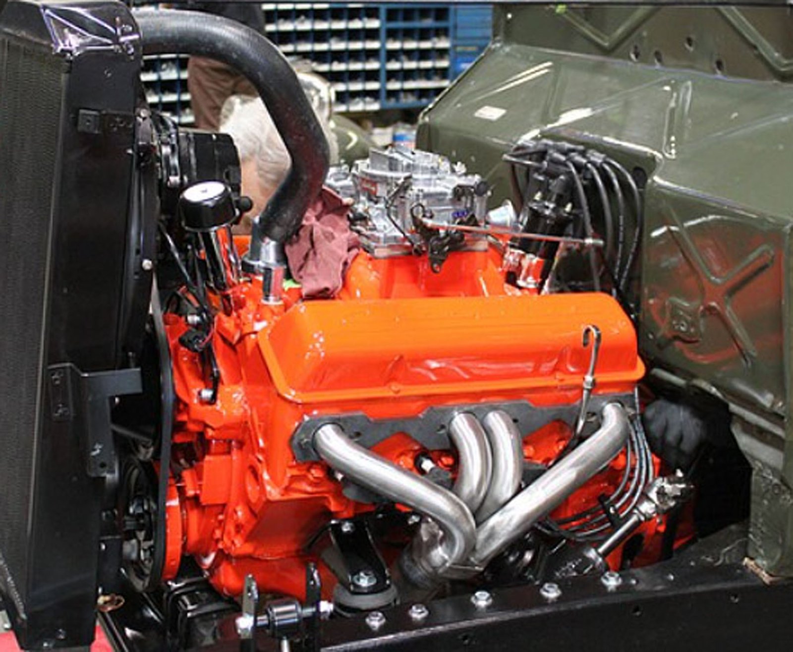

    I am searching for some tight headers like these where the driver's side angles forward to clear the steering box. It's for a '40 Ford with SBC. Does anyone recognize the manufacturer or know who sells them?

    That looks like the ones! Thanks so much!

    Sanderson is a good brand. However, if you are wanting to compare, search for "block hugger" headers.
    Many point straight down though, not that forward kick to clear the steering.

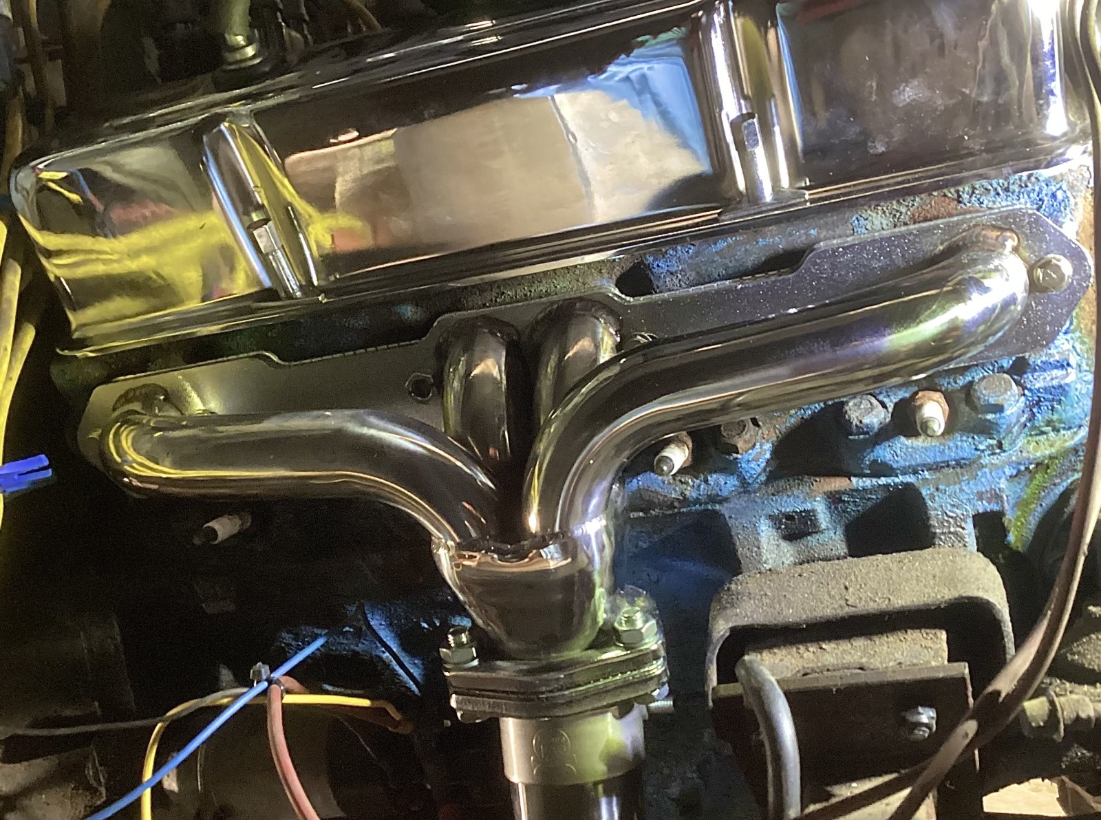

    I went with a “super short “ pair on my ‘40 Olds to clear the steering box on the other side. Regular “shorties” wouldn’t work… 2126CD9D-0093-46F9-BD5C-C9CAA97DD7B8.jpeg

    A lot of companies make shorty headers with an angled collector. So just get a pair that angles, and bolt them up so the angles are both forward instead of back.

    Sanderson will mix and match sides
