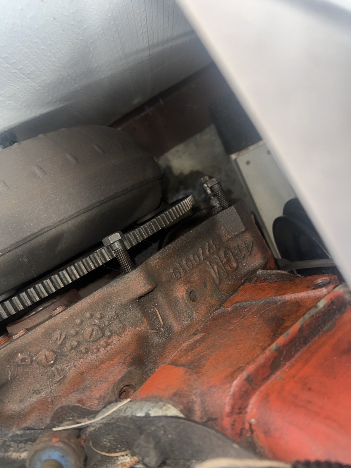

    For my 54 GMC project I was given a old SBC and a TH400 to keep my project alive.
    Date code F158 so June 15 1968
    Casting number 3970010. Usually seen on 350s yet a 350 was not available in 68? So 327????

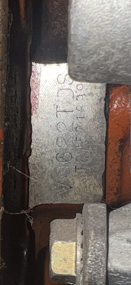

    Serial and Vin Code
    I know it's a Saganaw Cast due to the clock. Shift 1 7 hours in to the shift according to my Chevys By the numbers.
    The T8 on the serial tells me T= Truck and the 8 again for 68.
    Has a huge Harmonic Balancer and and equally large and pushed forward crank pulley
    Heads gave slightly angled plugs and rounded square ports on the exhaust.
    Has an aftermarket intake, has not had a vlave cover pulled yet to get head casting.
    The T?S is confusing is that a D or a backwards C? Nothing I have found notes a TDS if it's mis stamped.
    Also having the stamp above and below is not like any I've seen, usually it's all along the edge in a line.
    I know it's not a 78 motor as again according to my book in 70 they started stamping 70,71 etc to note the year not just the last number.
    The 3970010 is equally strange being a 68 block.
    Far as I can tell this might be a Large Journal 327 C10 motor??
    What says the actual experts of the HAMB?
    Unknown what it really came out of as buddy who got it rescued it from a crashed SBC swapped Jaguar.
    All I know it's no DZ. Lol!!!

    1978. Not 1968. The two digit year on the casting date was a random thing, you can find single or two digit years over several decades.
    The short number pad is a big clue that it's a later 010 block, not an early one.
    The three letter suffix TDS is another big clue, they started using three letters in 1970, and most of the Chevy cars started with C, most of the truck motors started with T. This is a GMC engine, since the first character of the partial VIN is T, not C

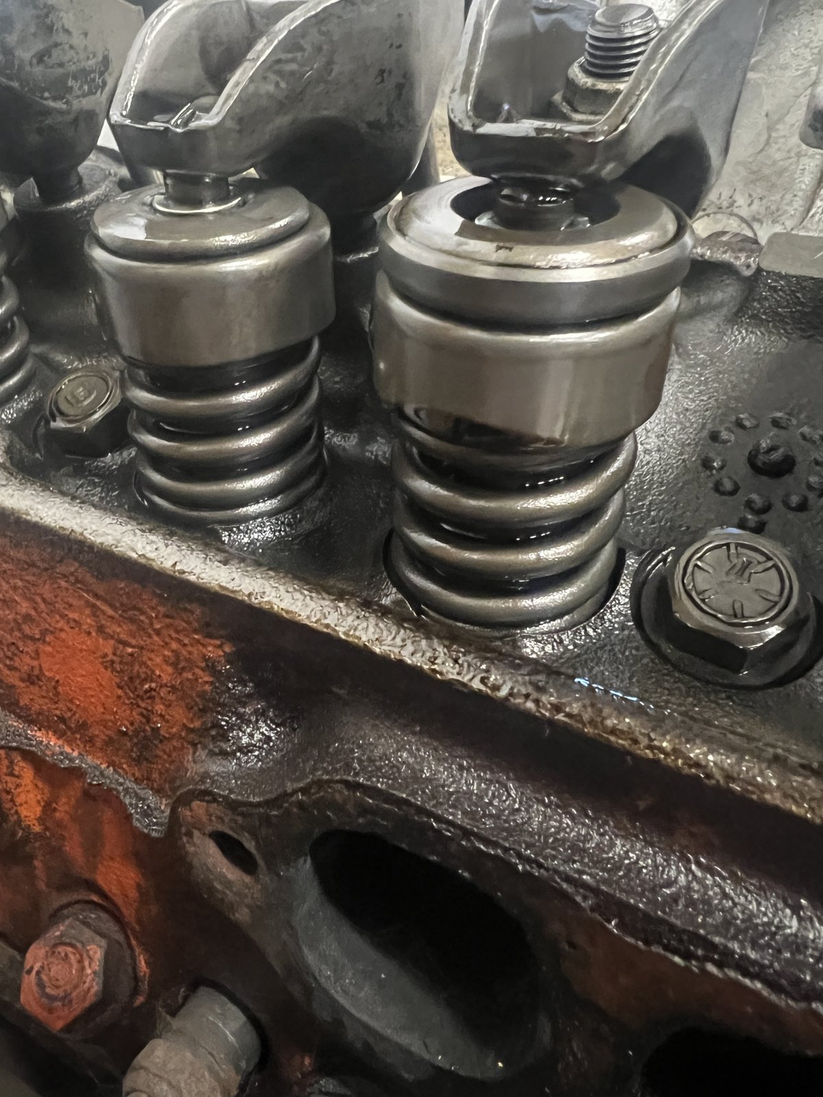

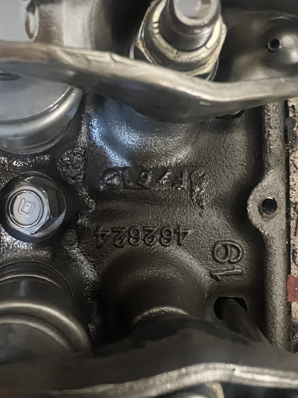

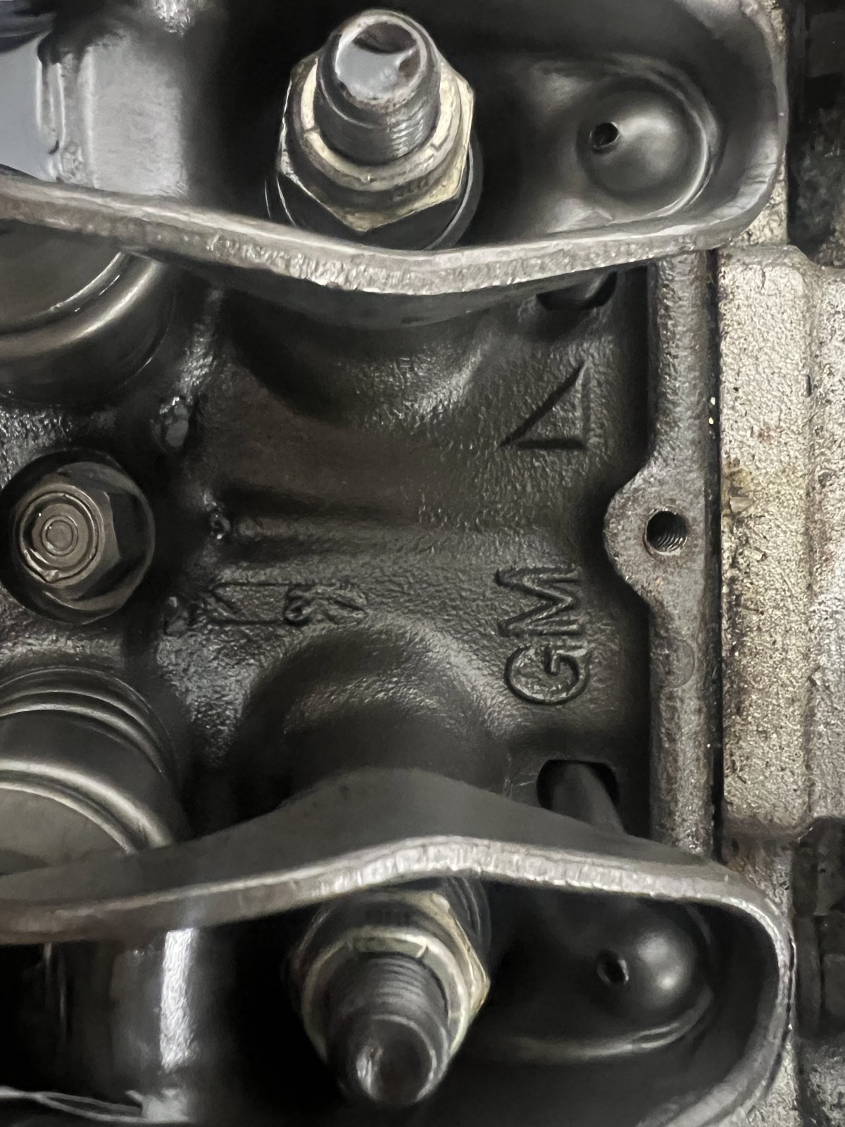

    Head stamping

    that last picture shows why you should not use gaskets with manifolds on chevy engines... :)
    624 heads are pretty ****py, as chevy heads go. But they'll work ok if you're not too worried about performance.

    I have read the heads are prone to cracking. So I am probably going to have to find some aftermarket heads if I want reliable power.

    @squirrel eighten me on the gasket thing. Truly curious as you are not the first person I've heard that from over the years.

    Joined: Sep 23, 2004
    Posts: 59,964
    squirrel
    Chevy didn't use gaskets between the head and manifold. They're not needed, and all they do is insulate the parts from each other, limiting heat transfer, then the manifold gets too hot, especially between the center exhaust ports.
    but gasket sets come with the gaskets, so people install them.
    Headers need gaskets...

    Fords also did not use exhaust manifold gaskets, somehow I got the idea to use graphite grease as a sealer.
    I think a lot of broken manifolds can be traced to the use of gaskets, and the uneven disintegration of those gaskets combined with retightening of the bolts.
