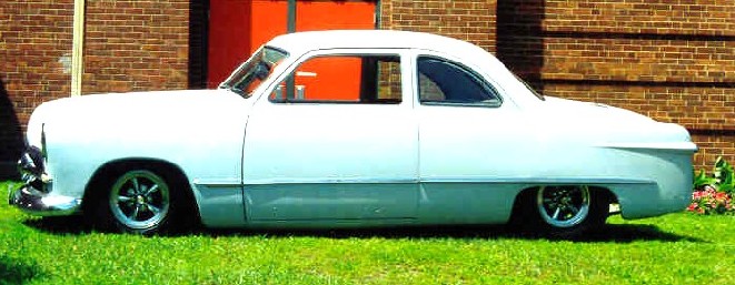

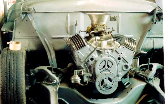

    Welp, here's what I did: First off, let me say my floor was badly rusted. I removed the floor's center hump because I knew my driveshaft would rub, as low as I wanted to go with the suspension.
    I dropped the 350/350 in place after I'd flipped my spindle supports. In doing that, I'd heated and bent my steering arms down to get the tie rods back down on a level plane with the pitman and idler......More on this in a minute.
    I used the original 49 ford 6 cylinder mount brackets welded to a couple pieces of s**** 2"X3" boxed tubing which was in turn, welded to my front crossemember. In the photos the ends of the tubing are still open. I closed them in before I put the front sheetmetal back on. The spacers allowed me to sit my engine above the stock 49 ford inner tie rod using the old 77 camaro oil pan. They cleared each other by 5/8ths inch.
    Yeah, I had to completely rebuild the floor including a new floor hump but I benefited by having much more oil pan/exhaust/****** pan clearance. No problems clearing the stock steering box either.
    Back to the heated/bent steering arms: Doing that effectively shortened those steering arms, causing quicker steering. I suppose there may have been a little more force needed to make sharp turns afterward but face it...shubox fords have super slow steering from the factory. The short steering arms really speeded up the steering and after I bolted up a 1.25" trans am front stabilizer bar, the little coupe drove/steered/cornered like a corvette! And no bump steer with this setup.

    I used the Nova, or Chevy II oil pan on my sbc install in my 50. I used Jamco's motor mounts, it was all a bolt in deal. The Draglink clears without modification. I had to raise the transmission hump to clear the 350 trany.
    In the last picture you can see the draglink and Nova oil pan.
  24. SloppyEggs
    Joined: Jan 10, 2012
    Posts: 197
    SloppyEggs
    This is exactly what I needed. What exhaust manifolds did you use?

    Mr48chev
    It looks like he used some style of ram horns. That's a pretty clean swap he did too.
