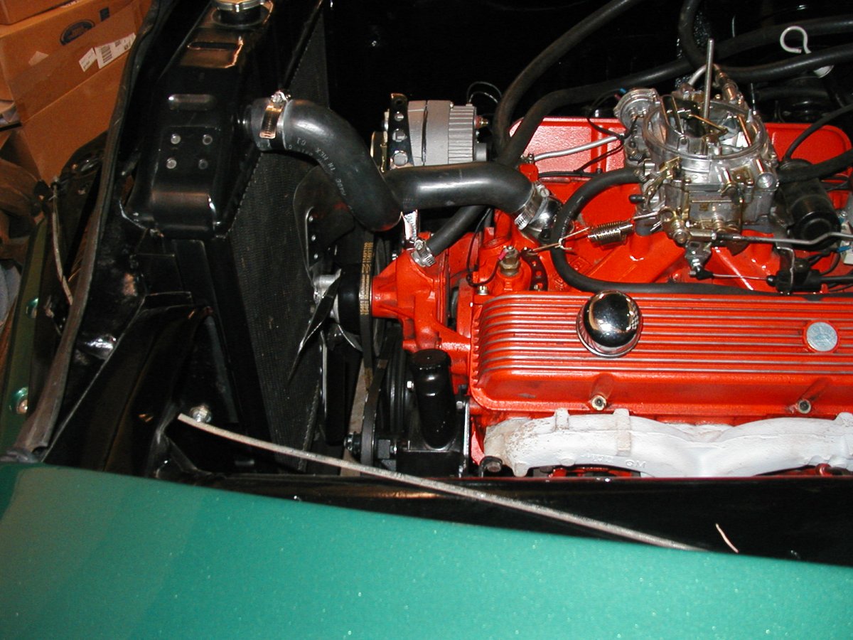

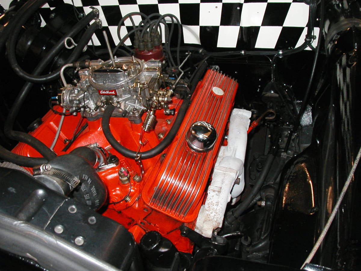

  4. That's Krazzy. I did nothing to the Tin anywhere, firewall or tunnel. This is a 350 and a 700-R-4. Rad and core support are in stock location and I run a long water pump with a manual fan. It's also not the first time I've done this combo. Now 49-50 will need a bit of Floor work being the Automatic didn't come out till 51 and that gave a bit more tunnel room. You probably need to pull the motor forward a bit. I hate Kit's. That seems to be where a lot of issues stem from.

  6. Well when what you have is hand built and don't work figure out why and what it takes to make it work. That's the Cut-n-Weld part of Hot Rodding. Kit's in general are just a way to get you close, seldom a good solution. Sad as that is it's been that way as long as I can remember. The #1 reason I don't buy parts like mounts, I build to fit what I need. From my point of view and what I see in your Photo a simple Drill motor could fix your issue.
