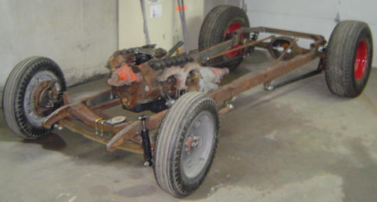

    heres a shot of my a coupe chassis going together now.....not even close to what your probably talking about.....but ....here it is anyway .....the motor is set back enough so i can run a mechanical fan ....with a short pump.....i usually raise the motor up enough so that it won't ever hit the ground ....or even one of those manhole covers in detroit.....well that may be a stretch ....but anyway ....its probably set back 4 or 5" ....used a pair of used speedway tubular motor mounts i bought in the hamb classifieds.....worked slick with a 4" drop tube******* crossmember ...though a 6" would have put the crossmember up in the chassis more....the steering is a vega "hd" (cursed gm engineers....) that is mounted just under the front motor mount tab ...the car is going to be fendered so i have to keep the stock w/b to make it look right...using a pair of speedway full length under chassis headers ....which fit the steering perfect....and get ya the advantages of the full header......brandon

  9. Here's a picture of exactly what I was talking about---the radiator has been moved foreward about 4" to make room for the engine. The original front crossmember has been removed, and a new pipe crossmember added about 6" foreward of the original crossmember position, just enough to clear the front of the radiator. A "bulldog perch" or "suicide mount" has been added to support the spring. Thid setup will extend your wheelbase 6", but it looks fine on a fenderless car, and no firewall recess is needed.
