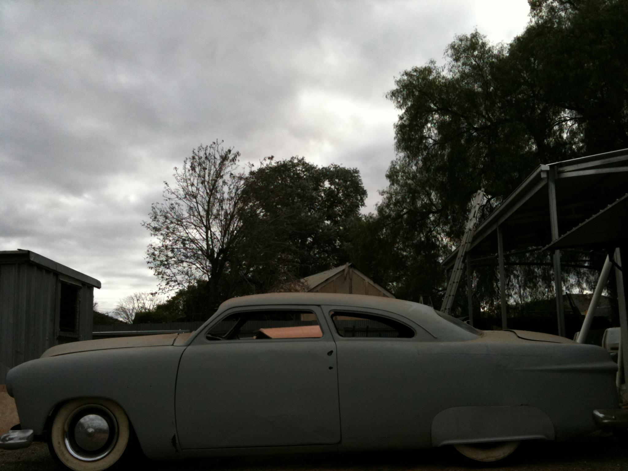

    I got her in a bit of primer before i left. Almost a year ago now that she left me and miss her every day! haha heres a pic-
