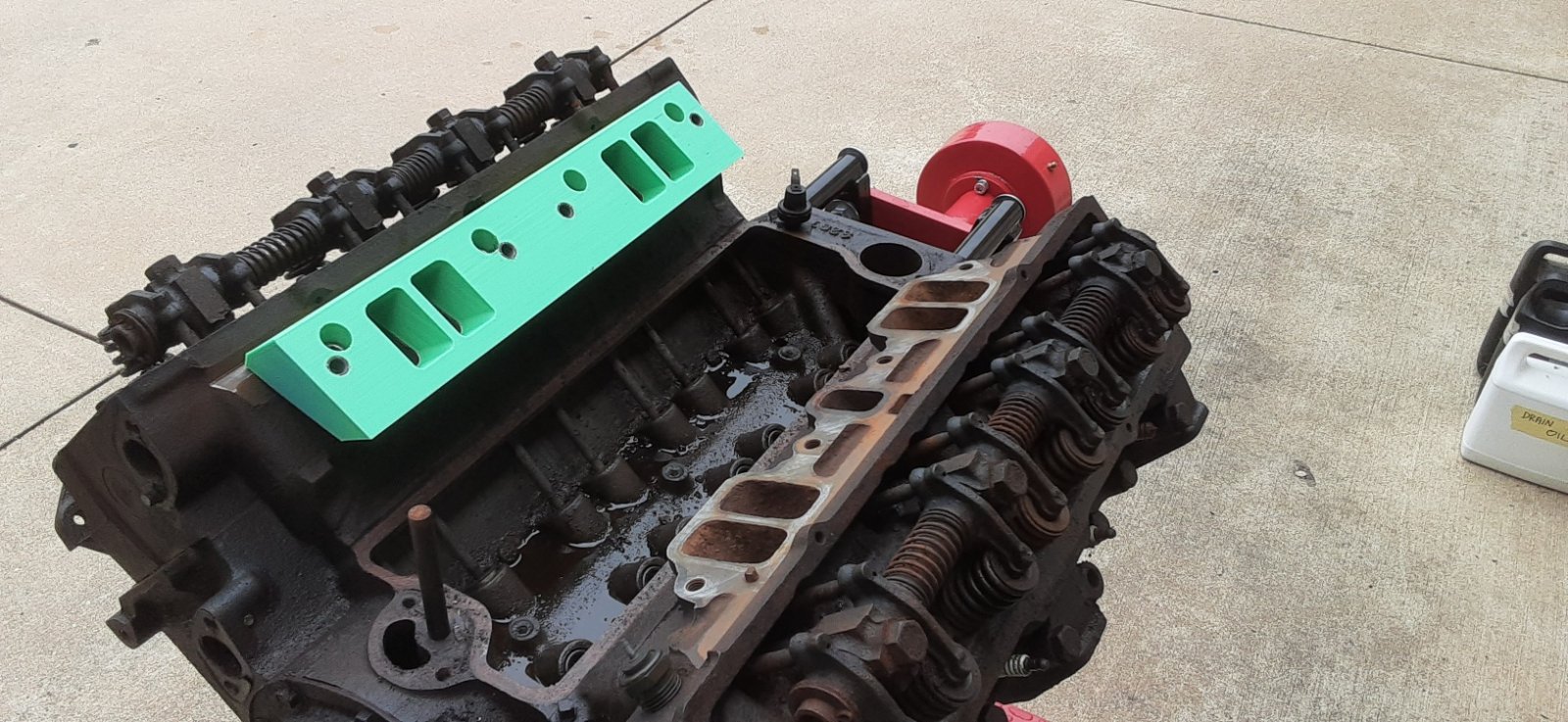

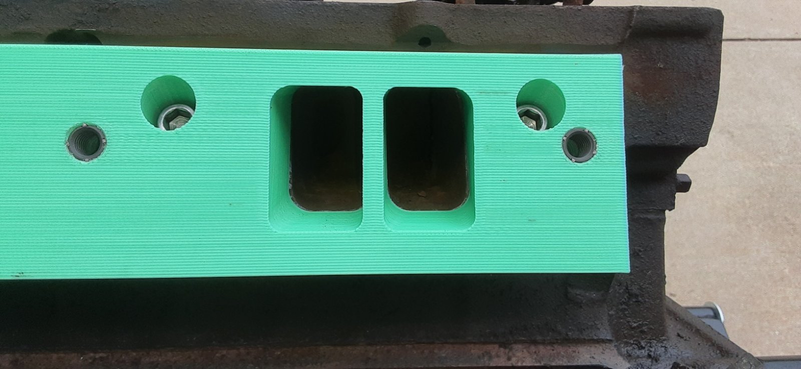

    I am in the process of making adapters to put a small block Chevy intake on the early Caddy V8. I have one 3D printed and I need a motor to test fit it. I have a yard nearby with motors but I have no room for another motor in my shop. Anyone near me have a block with heads that could help with the trial fit? I live in Fort Atkinson, Wisconsin. I already make a similar adapter for the SBC to a Stude V8.

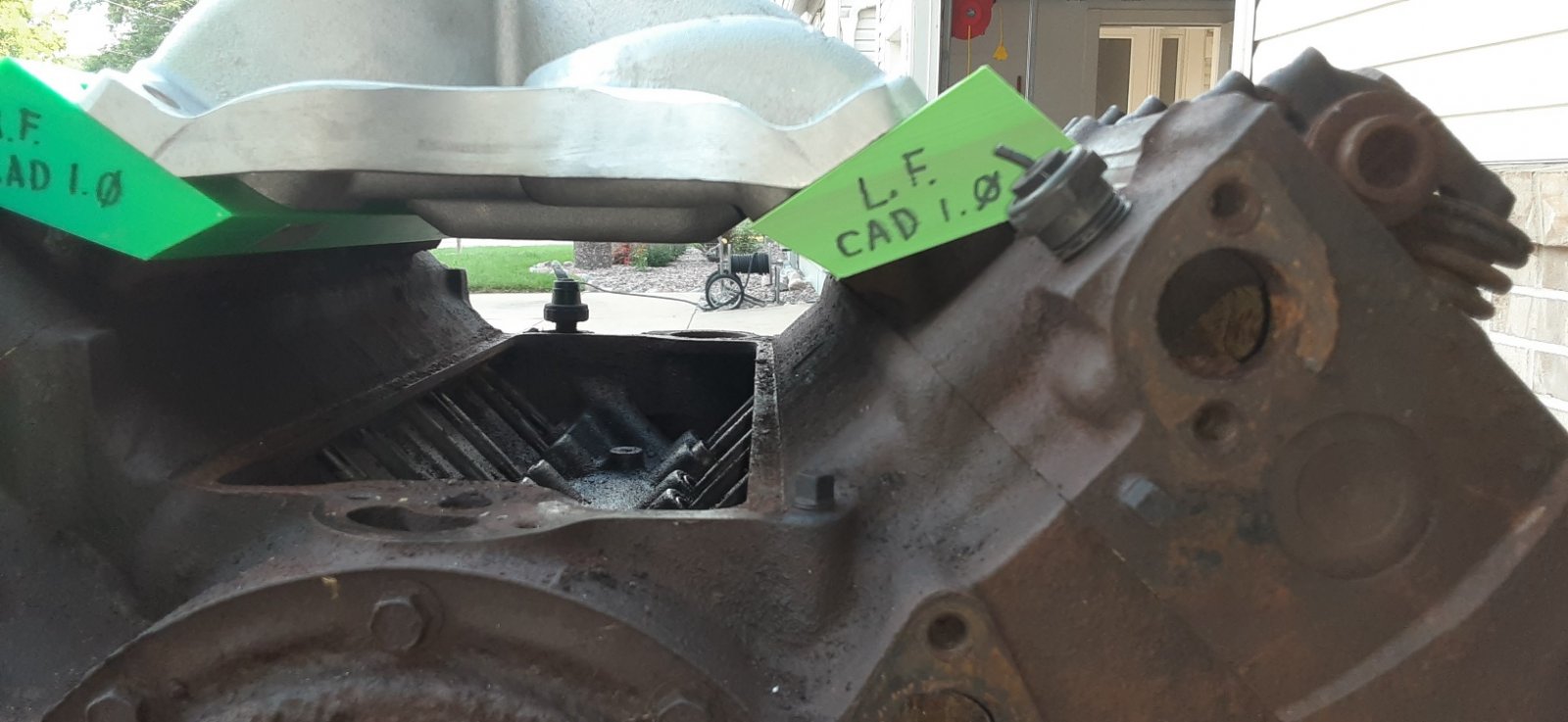

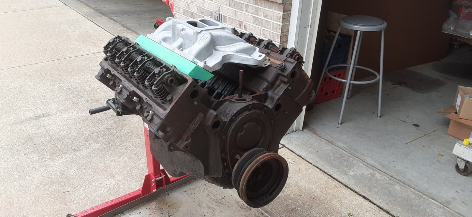

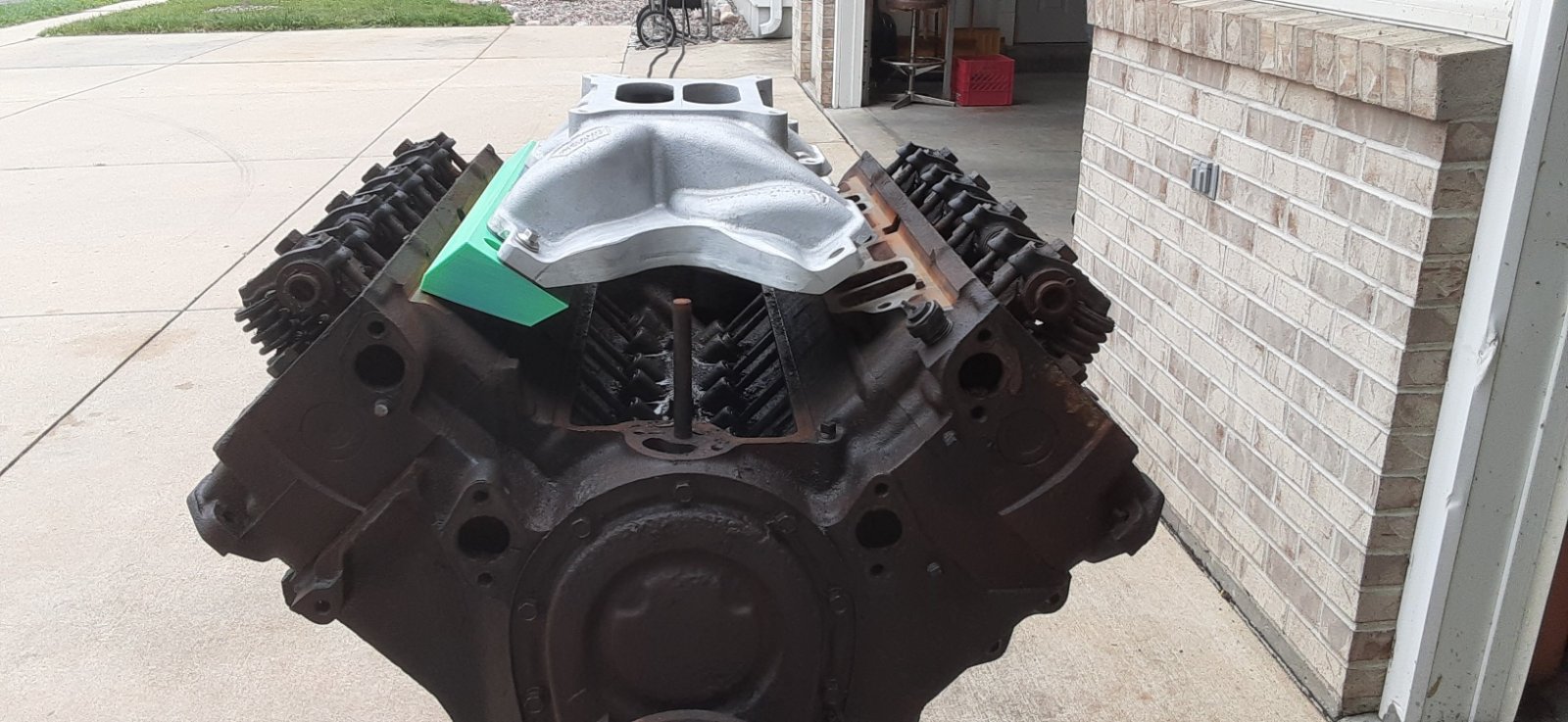

    I finally got a lab rat test motor from a local yard last weekend. It's a 1960 390 Caddy. It is crusty and froze tight but it will serve as a test bed for fit up of the adapters. I bolted the one adapter on with a Chevy intake and the alignment looks good to the head. The manifold sits level with the motor and is equidistant from the edge of each head so I do believe I am spot on for the fit. I did order another 3D printed adapter on line last night, delivery should be by next weekend. If everything still fits well I will order a set machined from 6061 aluminum. 20210807_120032_resized.jpg 20210807_120051_resized.jpg 20210807_120104_resized.jpg 20210807_120110_resized.jpg 20210807_122434_resized.jpg 20210807_122459_resized.jpg 20210807_122518_resized.jpg 20210807_122536_resized.jpg 20210807_122610_resized.jpg 20210807_122642_resized.jpg 20210807_122657_resized.jpg 20210807_123004_resized.jpg 20210807_123047_resized.jpg

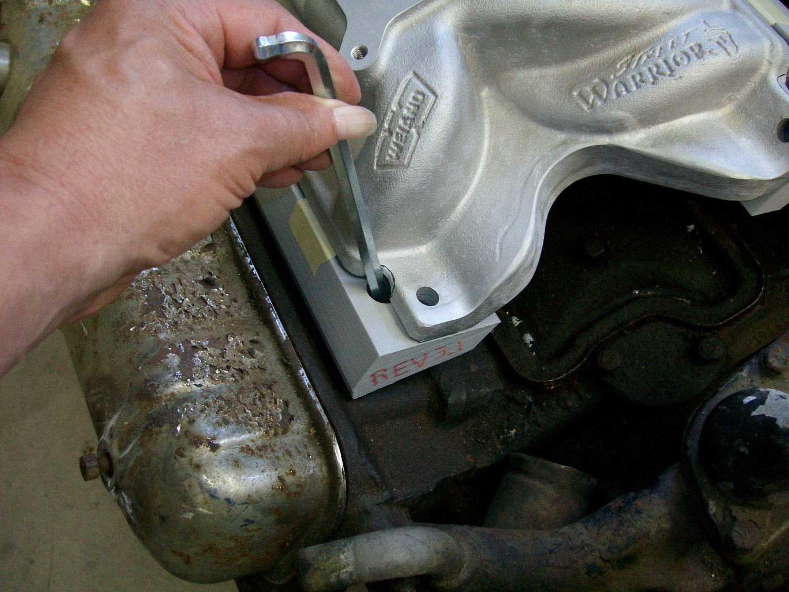

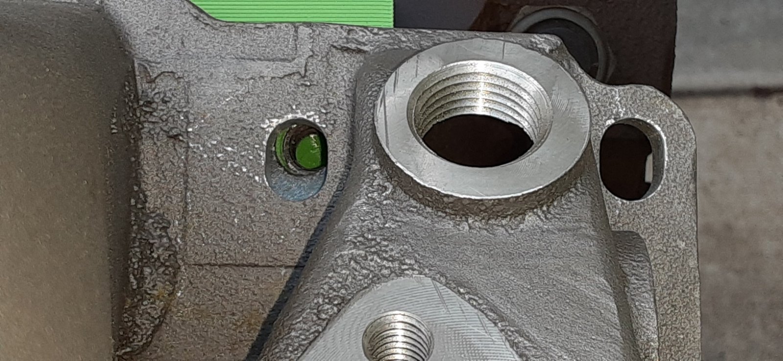

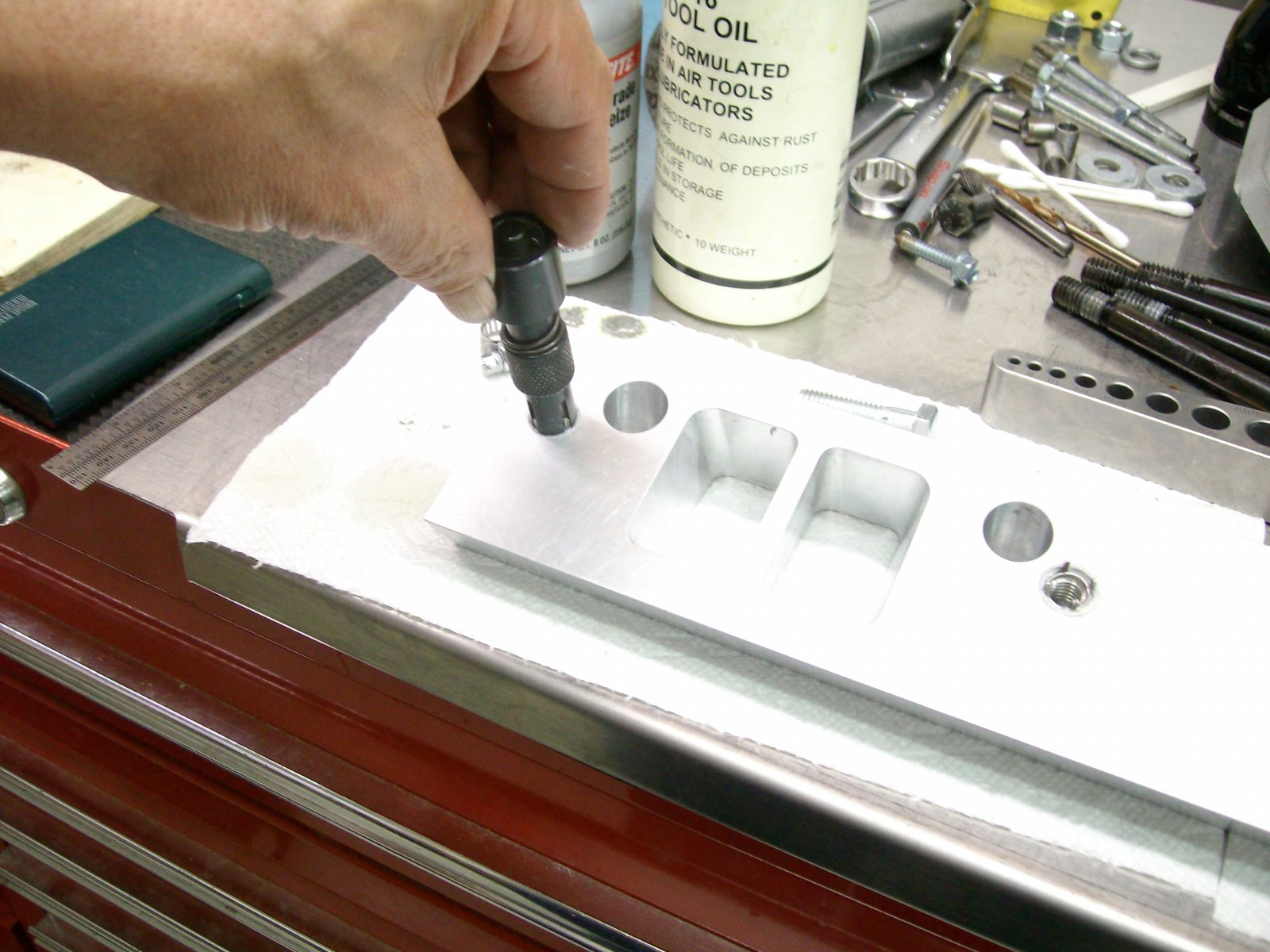

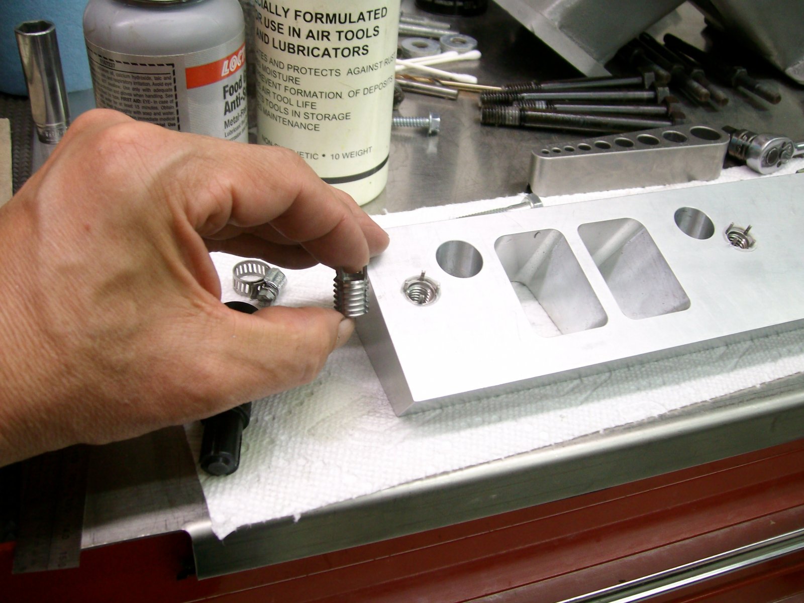

    To be able to port the intake to the adapters you add the small notch added to the edge of the intake. This allows you to mount the adapters to the heads using only the four outboard corners, add the intake and then by using a "wobble" type Allen you can remove the adapters with the intake still in place. These are the Stude version, The Caddy would need the notch a bit farther to the right.

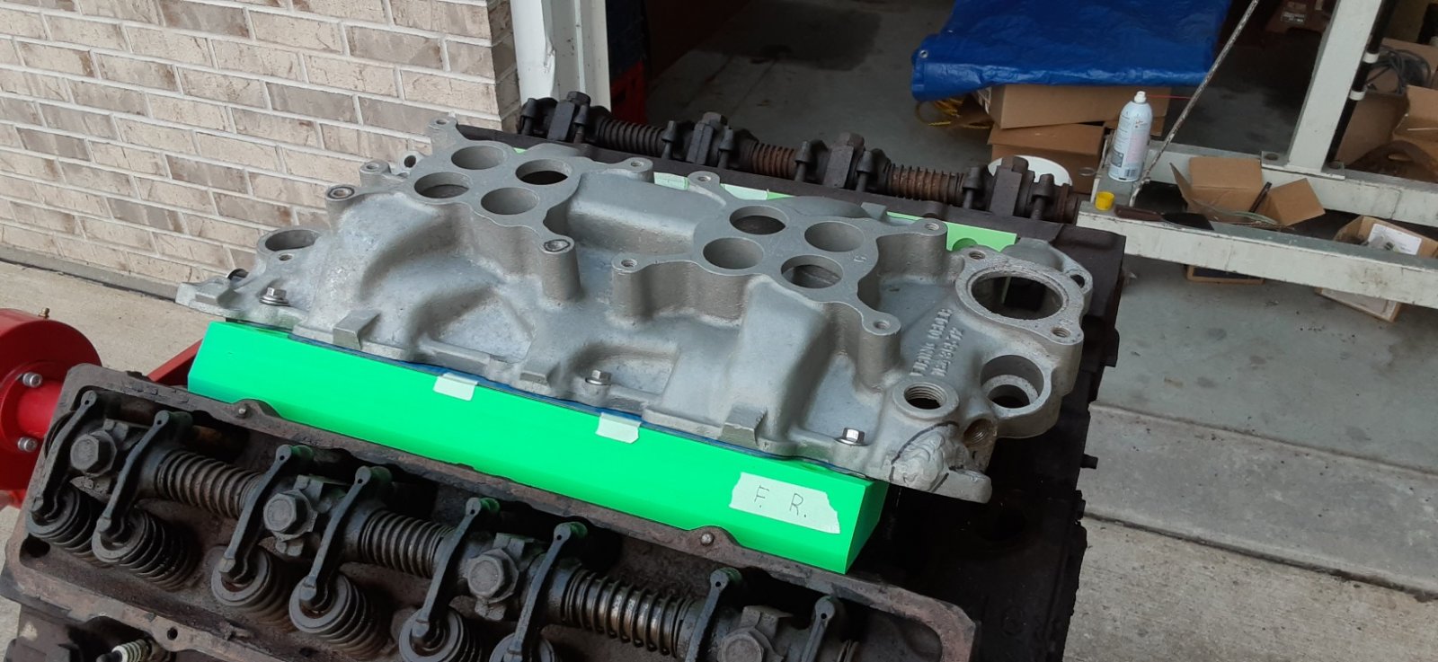

    The SBC options are plentiful. You can go old school, say a 1956 Corvette aluminum dual quad. I picked one up for $125.00 because the water p***ages are really corroded but who care as you're cutting them off! A DCOE crossram, mine is shown on a Stude. A modern Tri-power, TPI, an old Martin turbo set up. It goes on and on.

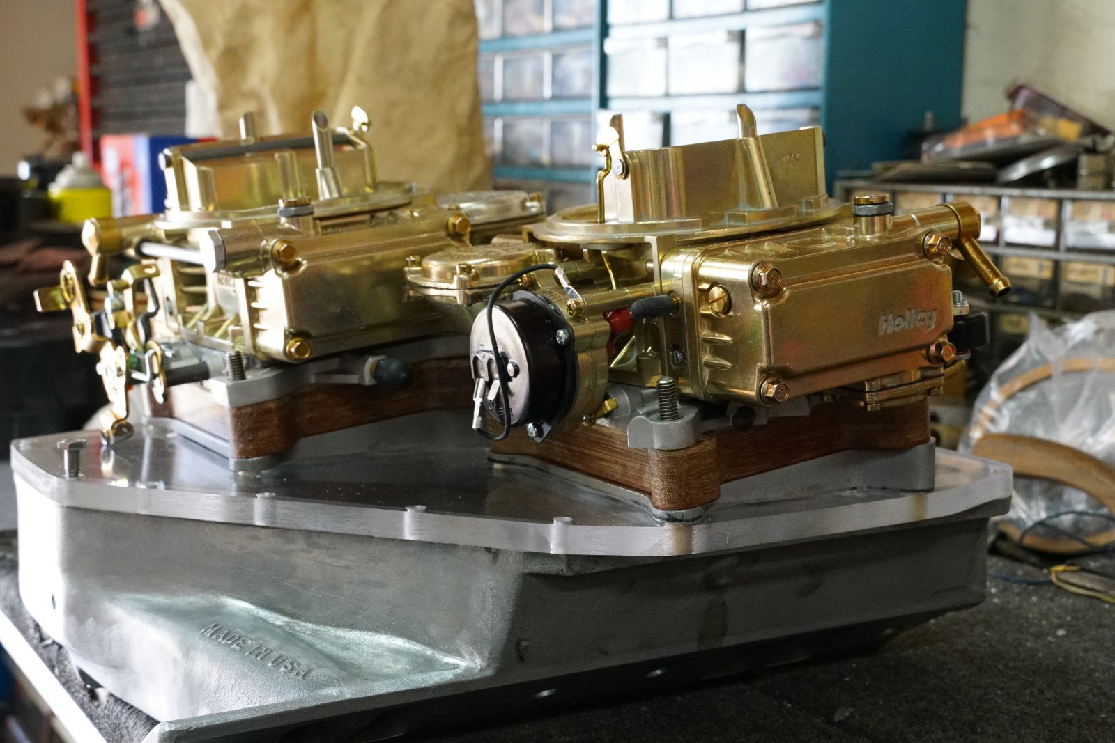

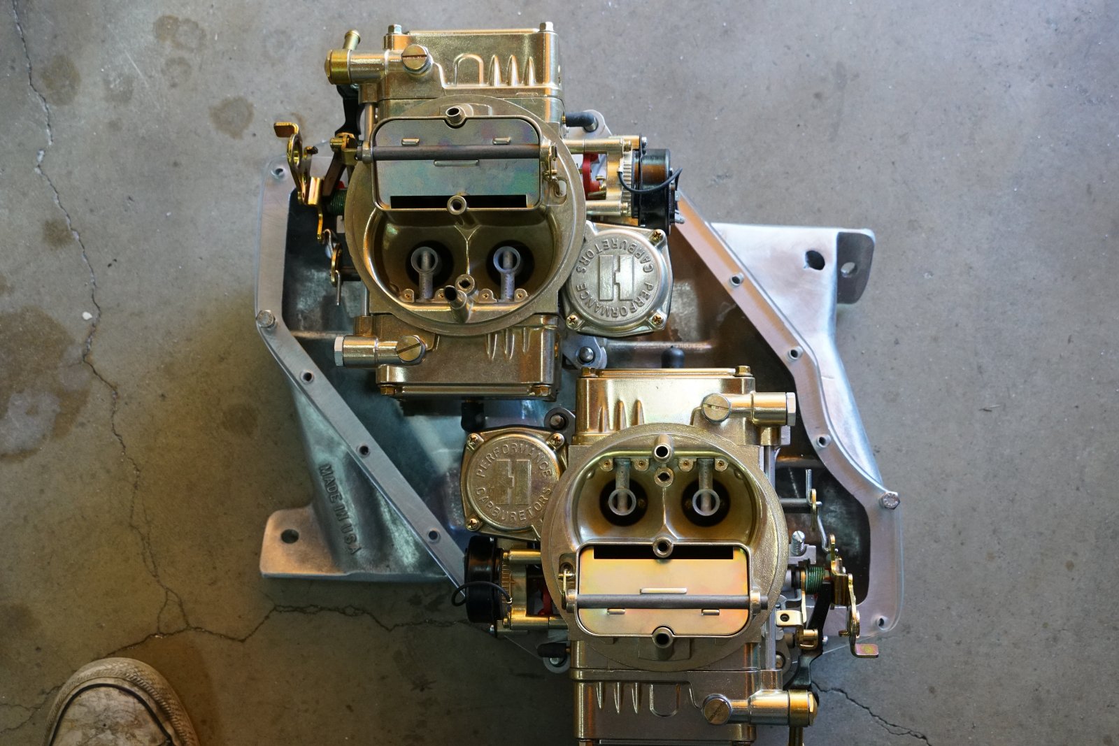

    Here's my Small Chevy manifold to Studebaker, since we're showing off...
    This is a shot from the front. The thermostat "used" to be in this location.
    This is an aftermarket replacement for the mid-80's Corvette manifold, the Renegade,
    The shot below, the left side is where the thermostat used to be, on the right is where the distributor location used to be. The odd shaped hole is the remnant of where the EGR port used to be.
    What it used to look like.
    Mike

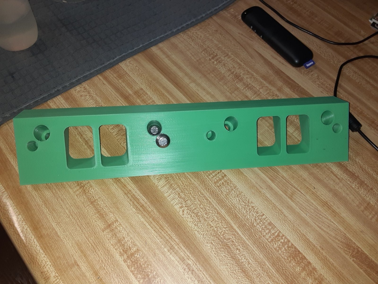

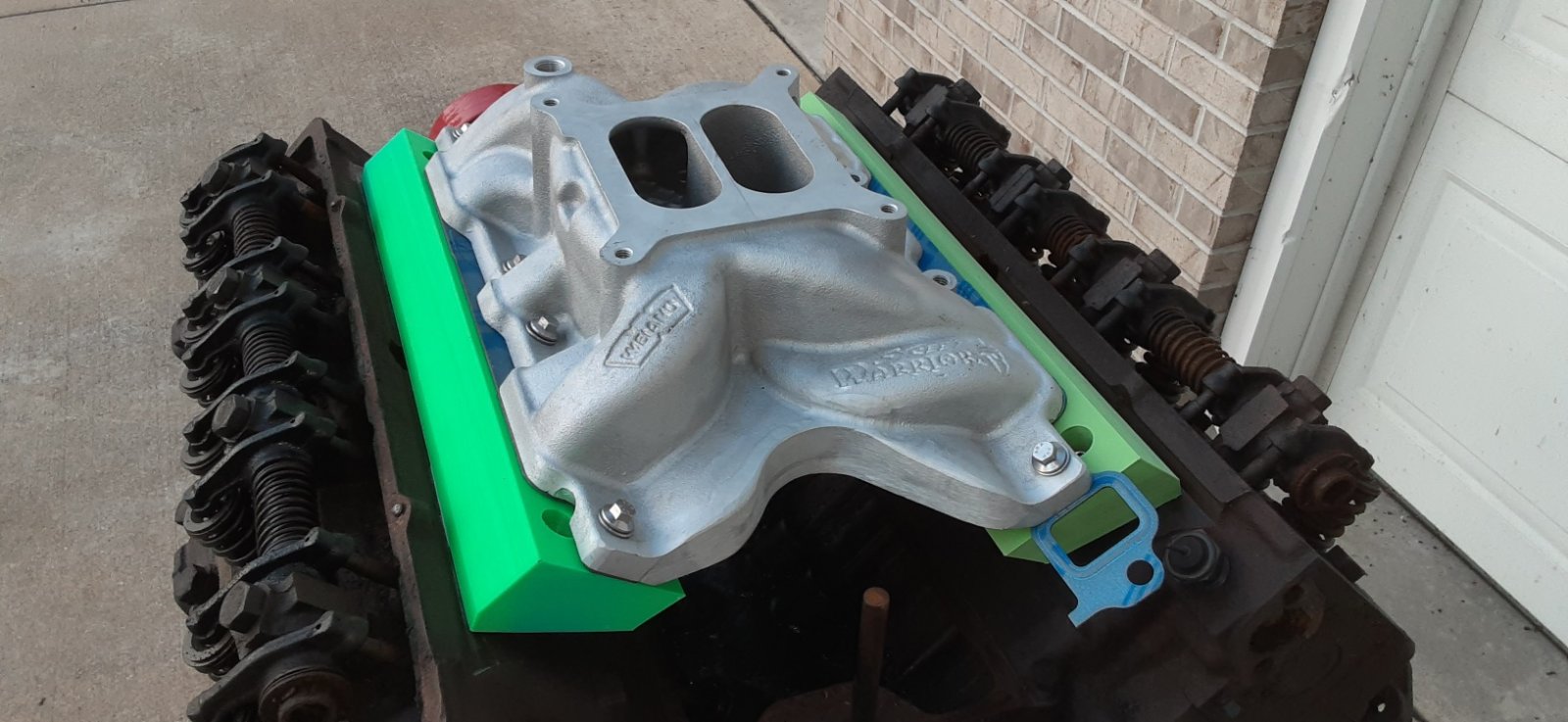

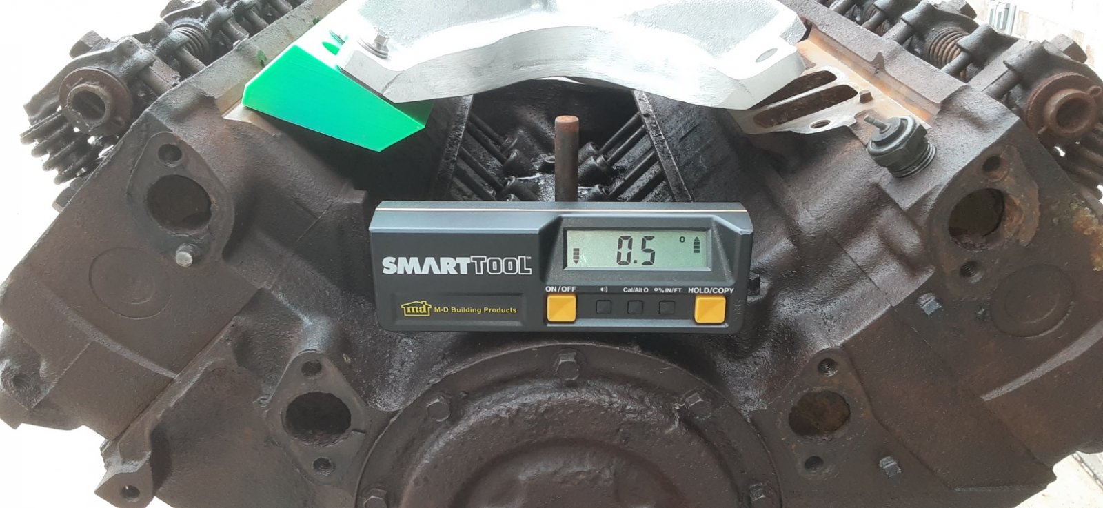

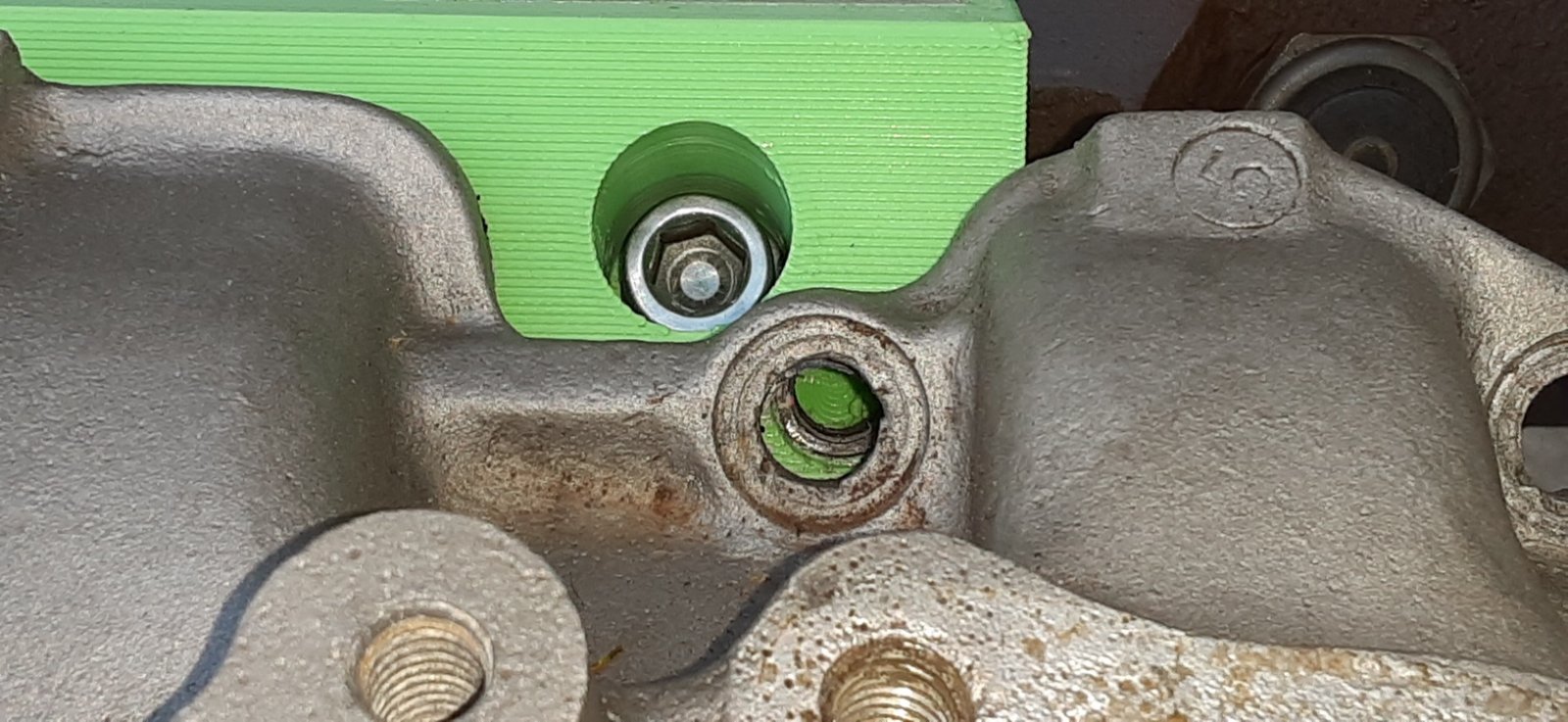

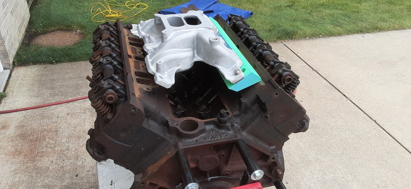

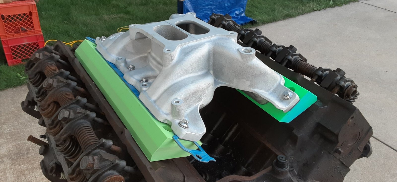

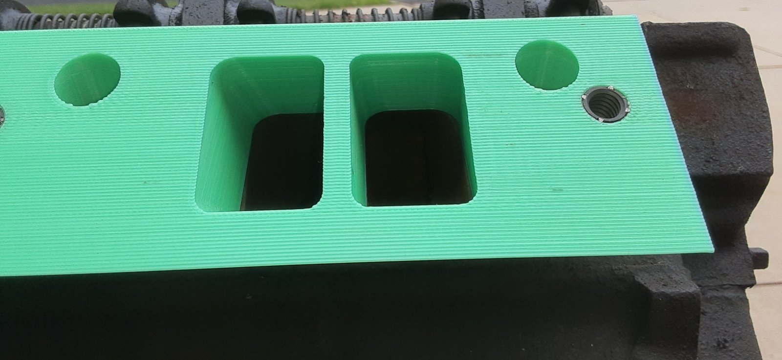

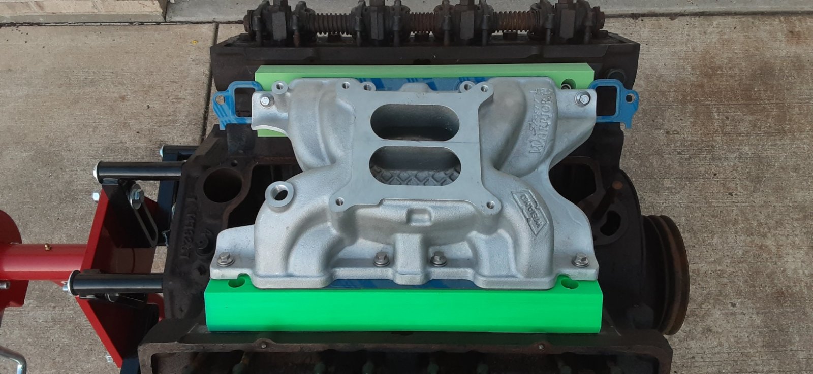

    I got the second 3D printed adapter today. It fit well. Tomorrow I need to take it all off, re***emble it using only the end bolts to hold the adapters to the heads. That way I can remove the intake with adapters attached to the intake and verify the Chevy to adapter alignment. I will also need to bolt the adapters to the heads without gaskets and lay the intake on, (also without gaskets), to verify that everything is in fact parallel. It is difficult to see any taper between the surfaces with the gaskets in place. If the SBC alignment is good and we are parallel I'll start to push the machine shop to get me the quote. I try not to be too much of a pest as they have always treated me well and it is hard to find a quality shop that will do short runs. The bonus is that they are only 40 minutes away.

    I tried some additional manifolds early this morning and found that a small adjustment is needed on the Chevy side. The intake from Thursday being an inexpensive aftermarket item has oversized bolt holes so it bolts up but the port alignment is not perfect. I put on two different GM aluminum manifolds and it appears I need to shift the Chevy pattern about 0.020" towards one end and down about 0.062. I had to make similar adjustments to the Studebaker version twice to get it right so I am not worried. I will get the 3D model tweaked this week, re-print and refit. I also tried an offshore Weber cross ram and observed the same adjustment are required. The last pictures are with the adapters bolted to the heads with no gaskets and the intake resting on top also with no gaskets. This shows we are spot on for parallel so that's good. 20210821_072420_resized.jpg 20210821_072439_resized.jpg 20210821_072503_resized.jpg 20210821_072933.jpg 20210821_074150_resized.jpg 20210821_074239_resized.jpg 20210821_075459_resized.jpg 20210821_075513_resized.jpg
