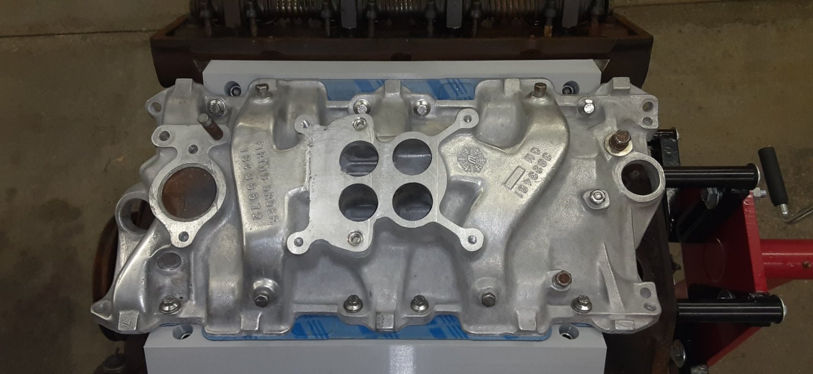

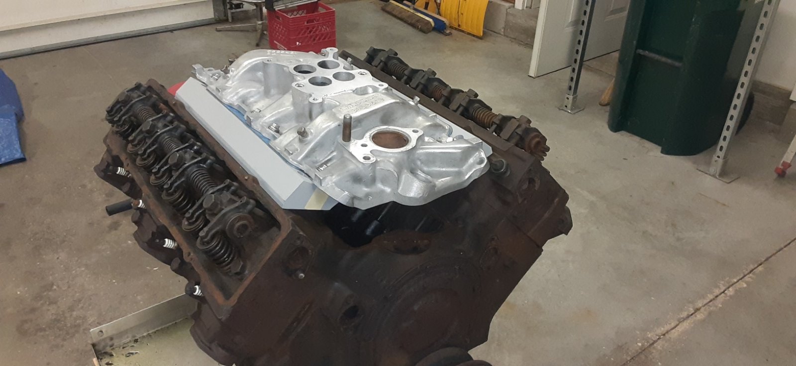

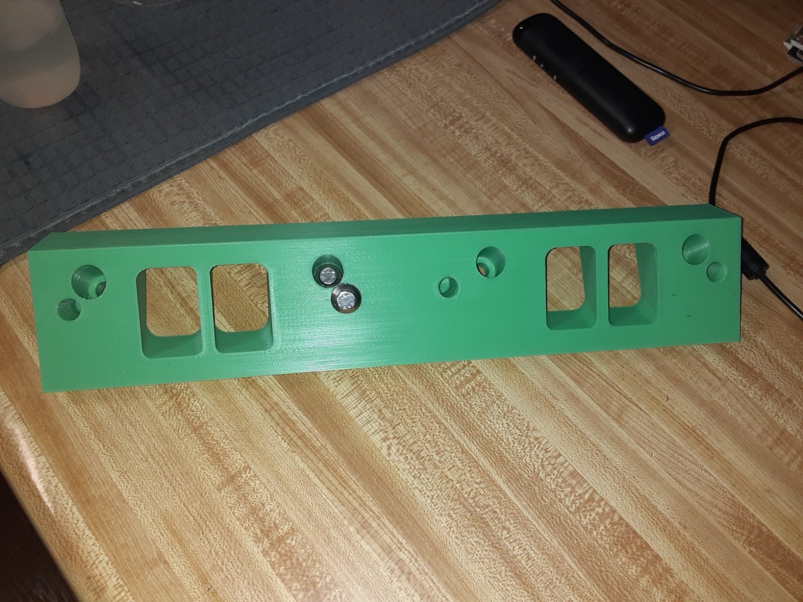

    I finally got A good REV III adapter set printed and they are a great fit. I had a REV III printed by a different vendor than the first and they were so bad I set them back for a refund. The ones we're looking at here are from the original vendor and have a fine fit and finish. I still fit it up with the GM military intake as the bolt holes are quite tight with little slop. I was able to spin all eight bolts for the intake easily with just my fingers. I also put the adapters on the engine with just the end bolts so I can remove the intake with the adapters still bolted to the intake. The line up is acceptable, the alignment is only as good as Chevy made it. Remember this is a '62 early intake with smallish ports so that's the reason for so much metal around the perimeter. I will get out one more later GM intake Saturday and if it fits as well I'll get a P.O. off the the machine shop to get one set done in metal. Photos below.

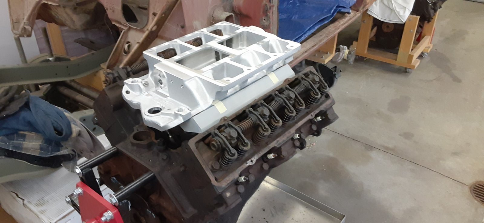

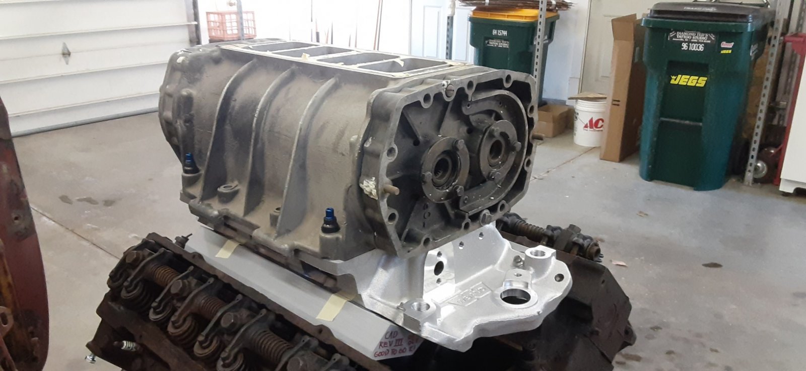

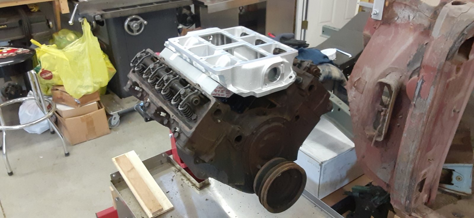

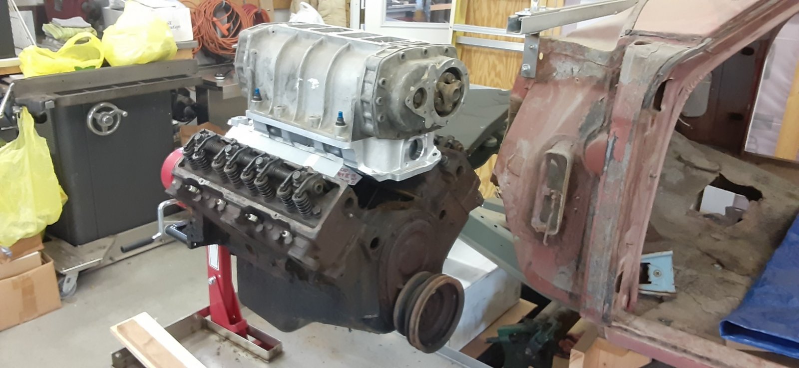

    I blew all my extra funny money on a 671 intake and a blower. It all fits quite nicely. The blower has been on someone's shelf for 25 years just as it came off the Detroit diesel. The blower will need a little lovin' to convert it to gas but that is a whole different thread. I am still waiting on the machine shop for the aluminum prototypes. I am not necessarily set on building a blower motor, I just wanted to show what you could do with the adapters. You could do a tunnel ram, a cross ram, with the SBC intake you have many choices. Once I get the prototype adapter checked for fit I'll tear down the greasy old girl and take it to the machine shop. If the block and heads are OK I'll figure out how radical I want to get with the build. Ross Racing has some very interesting parts and machine services available for vintage engines.

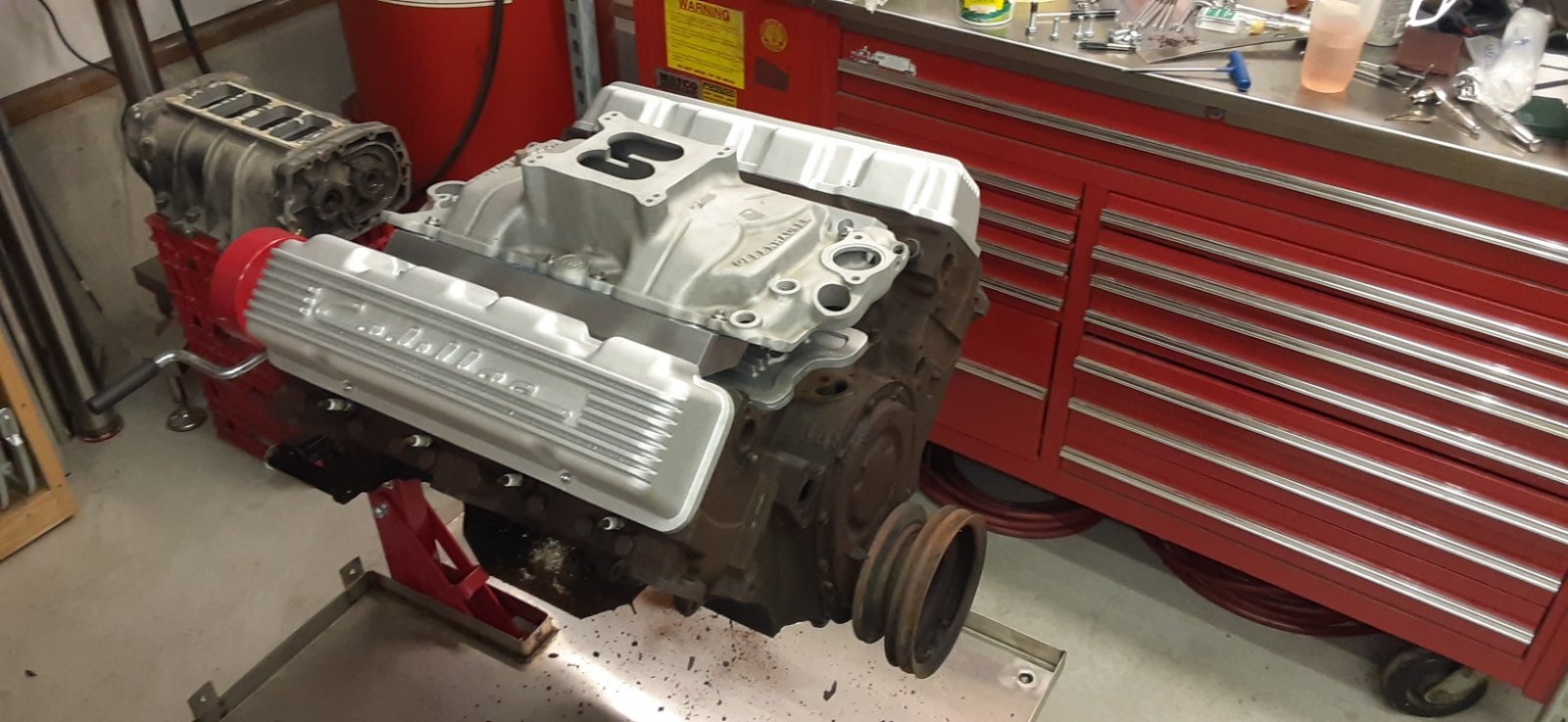

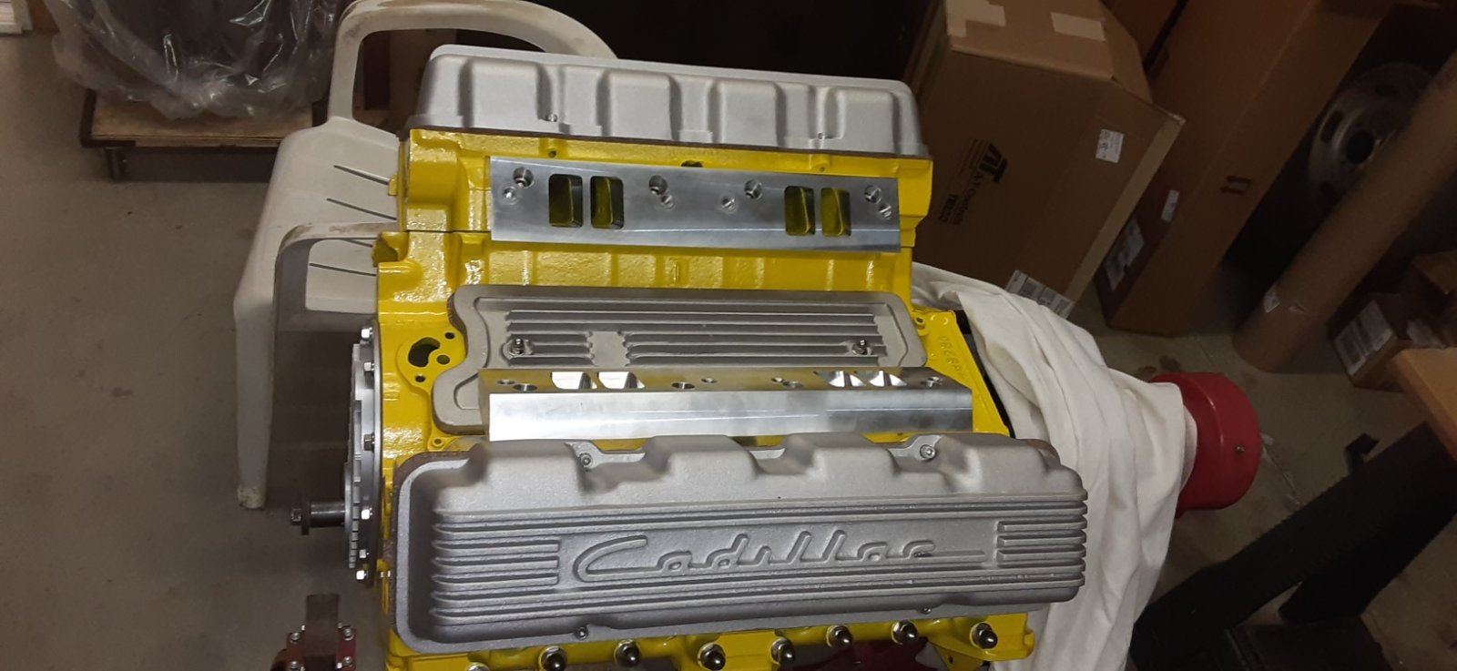

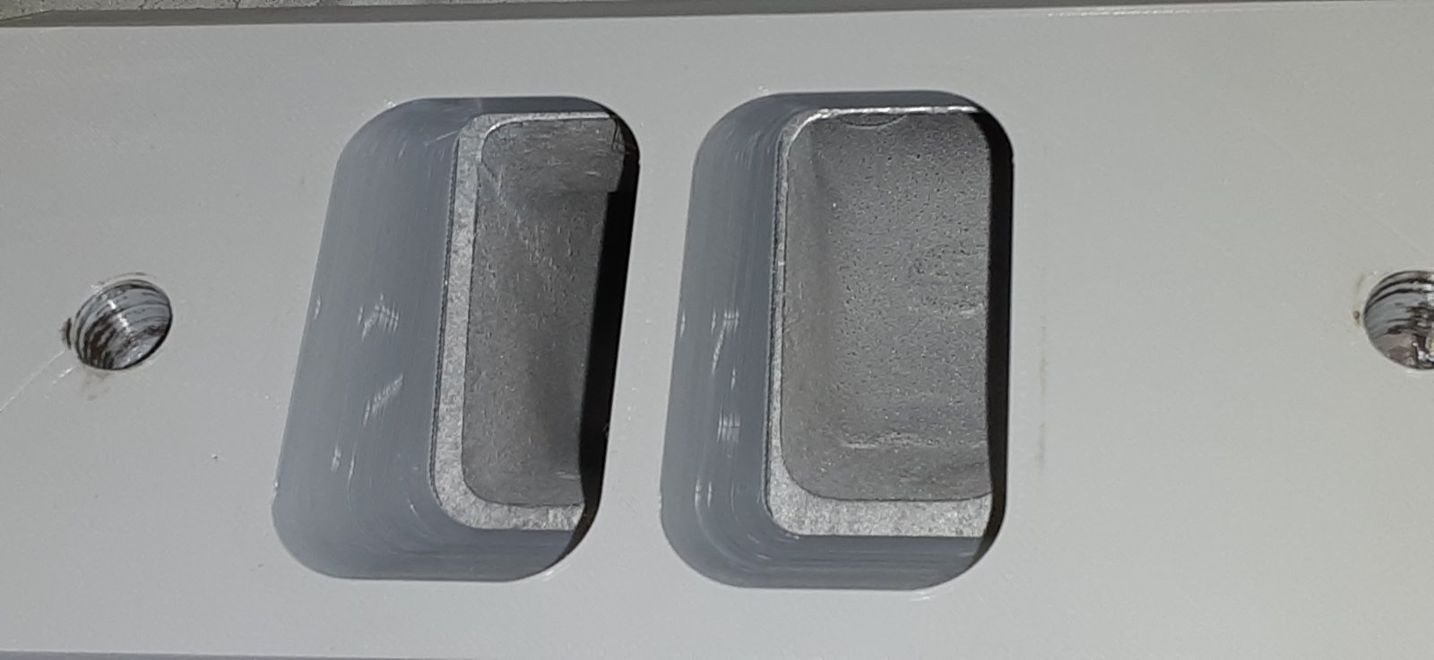

    OK, I finally got the real deal back from the machine shop. They fit sweet. Photos attached. I will make more if there is interest here or not. I will need to look at the current costs and what a production run of 20 pieces would need to sell for to make it worth my while. As with the Studebaker version, I just get a kick out of making cool, useful hot rod parts for others to enjoy. Once I'm ready to offer them I will put them on the appropriate section of the forum. If you are interested let me know, we just won't discuss selling or a price on this thread. The intake is an OFFY "360" open plenum type, just an idea for now. Sorry it is still displayed on a greasy old motor. 20220122_120150_resized.jpg 20220122_134500_resized.jpg 20220122_134534.jpg 20220122_135118.jpg 20220122_140759.jpg In a couple weeks I'll start teardown for rebuild.

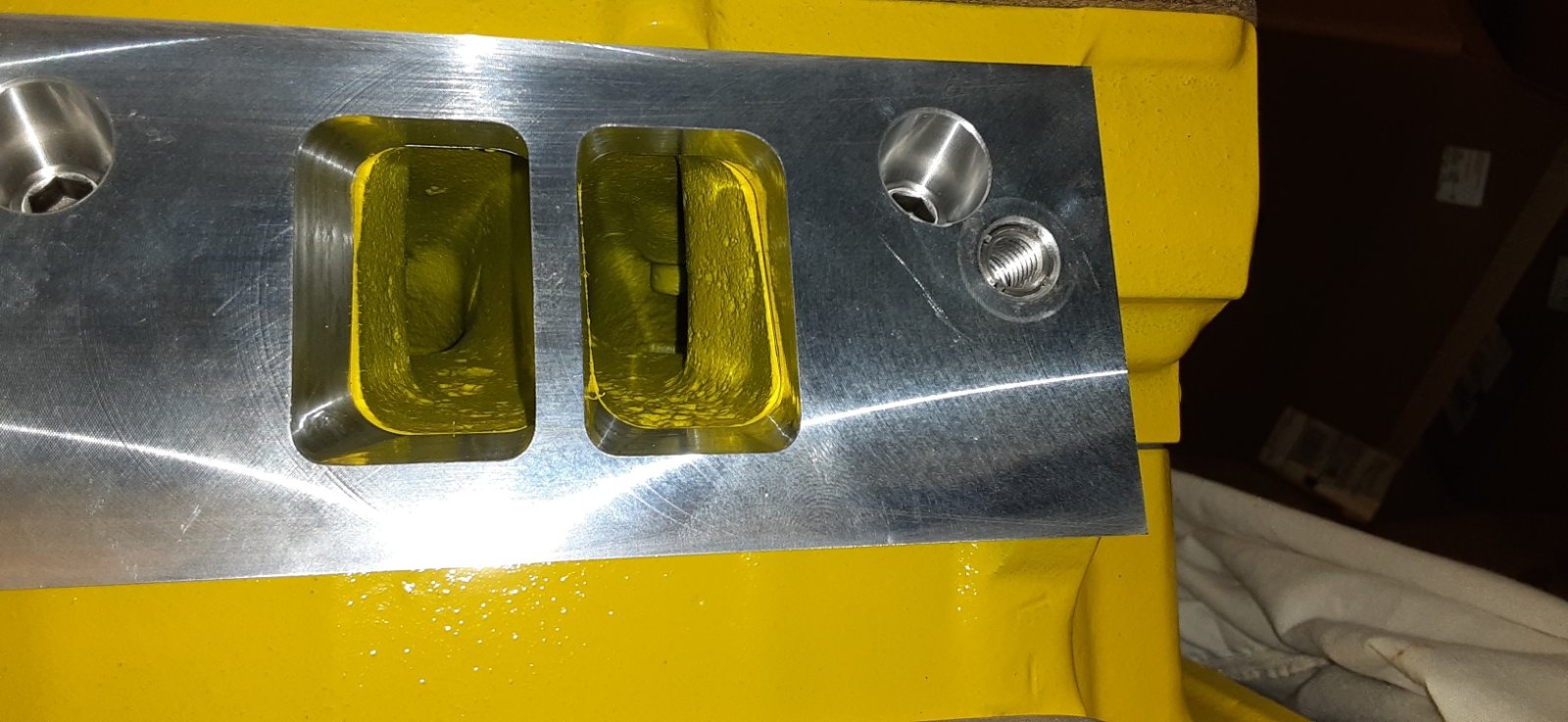

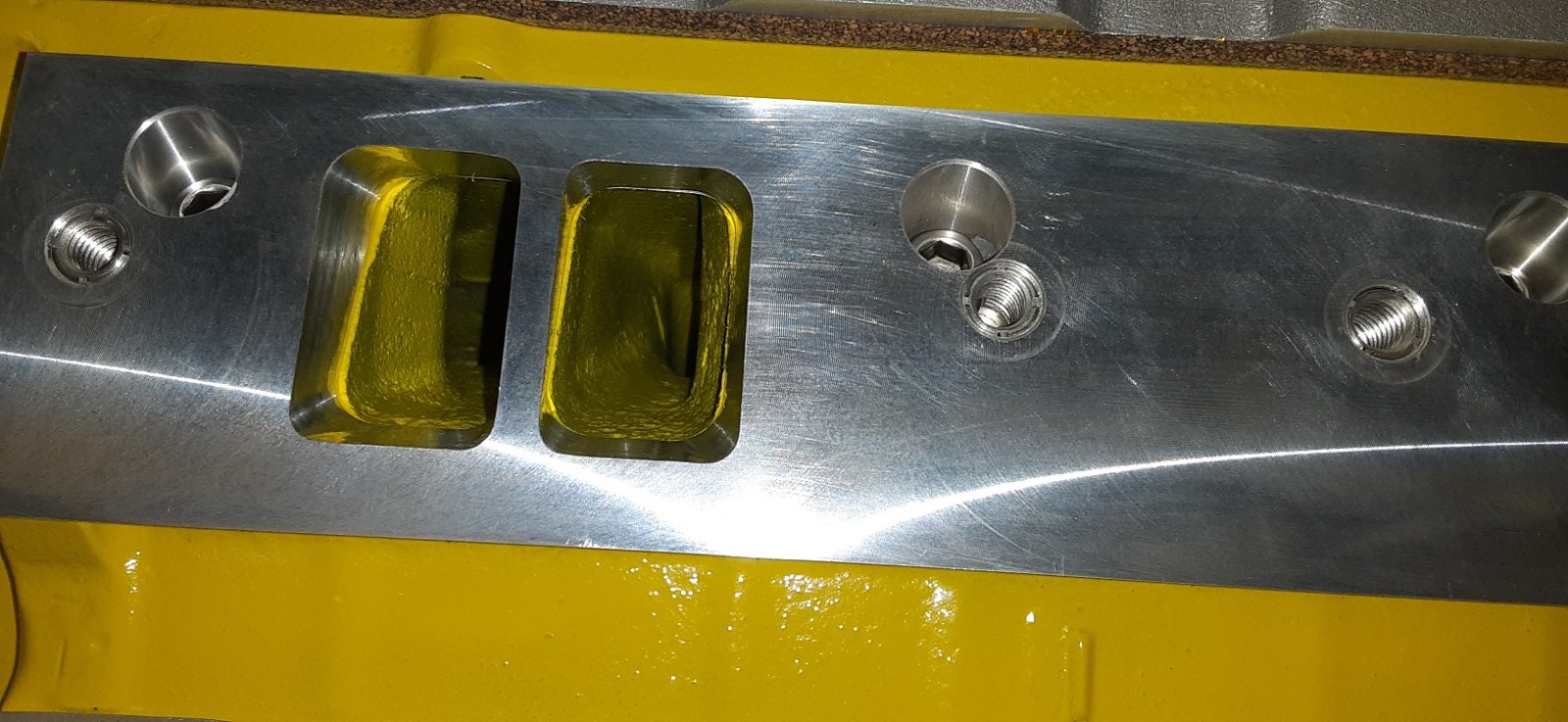

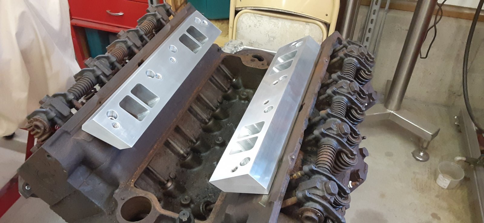

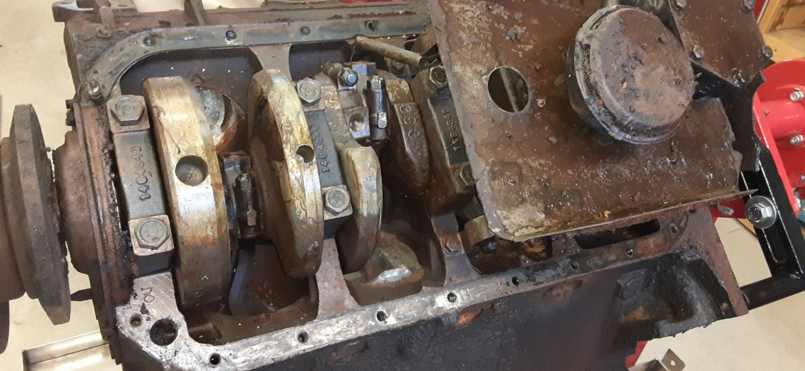

    I have good news and bad news. The good news is that I placed and order for 10 sets of adapters from W/S Machine. As soon as they're available I post them on the "for sale" page. This meant that I could tear down the "test fit" motor. It is a seized up '60 I got from a local salvage yard. I knew there could be issues upon disassembly and that is where the bad news comes in. The motor is toast. I hope I can save the crank. If you have a good block or know of one send me a note, please. I want to build a serious motor to showcase the adapters on. Hopefully I can find something close to me. Maybe the block fairy will leave one under my pillow.

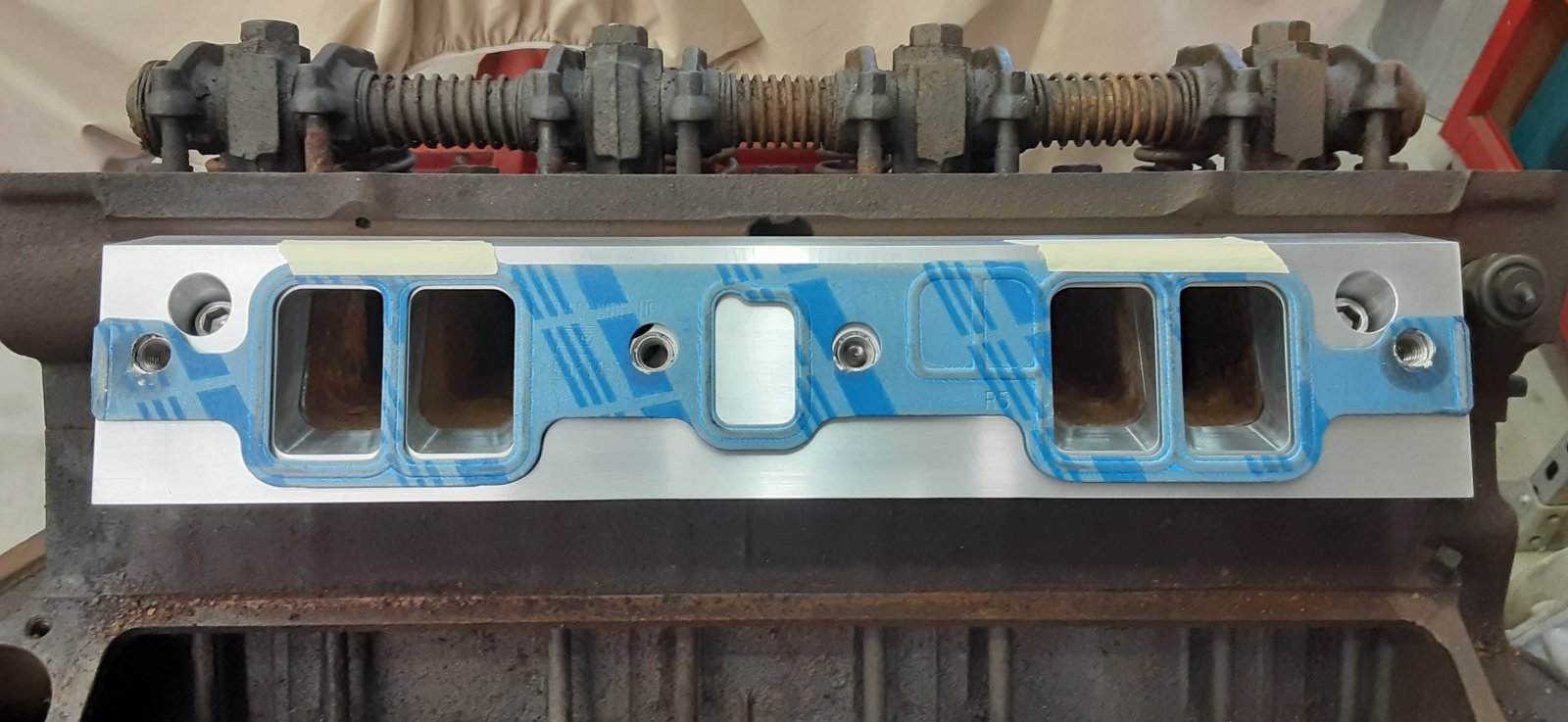

    I back burnered the adapters for a while. Not so much the adapters but the display motor to advertise them on. It's a '59 block. The blower intake still needs the water passages trimmed back. The Pullies are BB Buick. The top pulley is fine as is. The lower pulley has the Caddy bolt pattern machined in between the Buick pattern and the original Buick pattern was 20231113_01.jpg 20231113_02.jpg 20231113_04.jpg 20231227_01.jpg 20240201_02.jpg 20240201_03.jpg enlarged to fit over the balancer rivets. The lower adapter for the blower pulley is out being machined.
