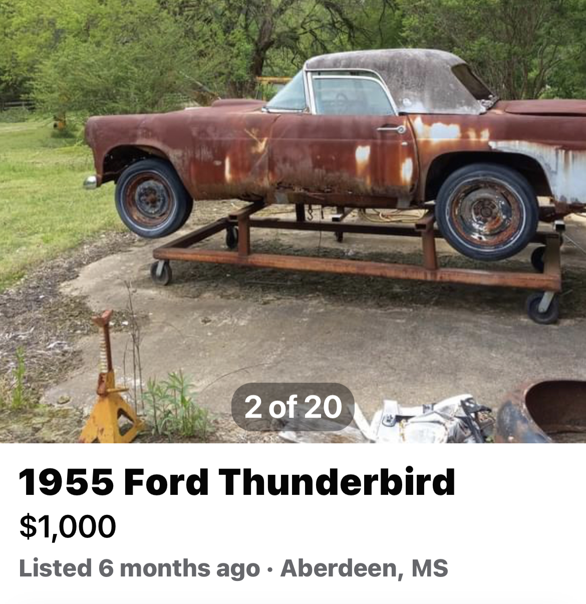

  21. Here’s a beater bird
    Okie Pete likes this.
  22. jimmy six
    Joined: Mar 21, 2006
    Posts: 17,142
    jimmy six
    I think you better get this one dipped!
  23. where is this junk 56? is it in ohio by chance?
