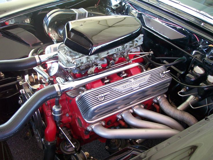

    Doane Spencer didn’t have any qualms about modifying his 55 when new, or years later with a major upgrade. The original and highly modified car sold (see link) for F bird prices, and the “clone” using the original parts sold just afterwards for slightly more ($102K, if my memory serves). The name “Doane Spencer” certainly had a lot to do with that.
    https://www.jalopyjournal.com/?p=20055
    My favorite photo of the original engine with the dual quads, air cleaner, and headers.
