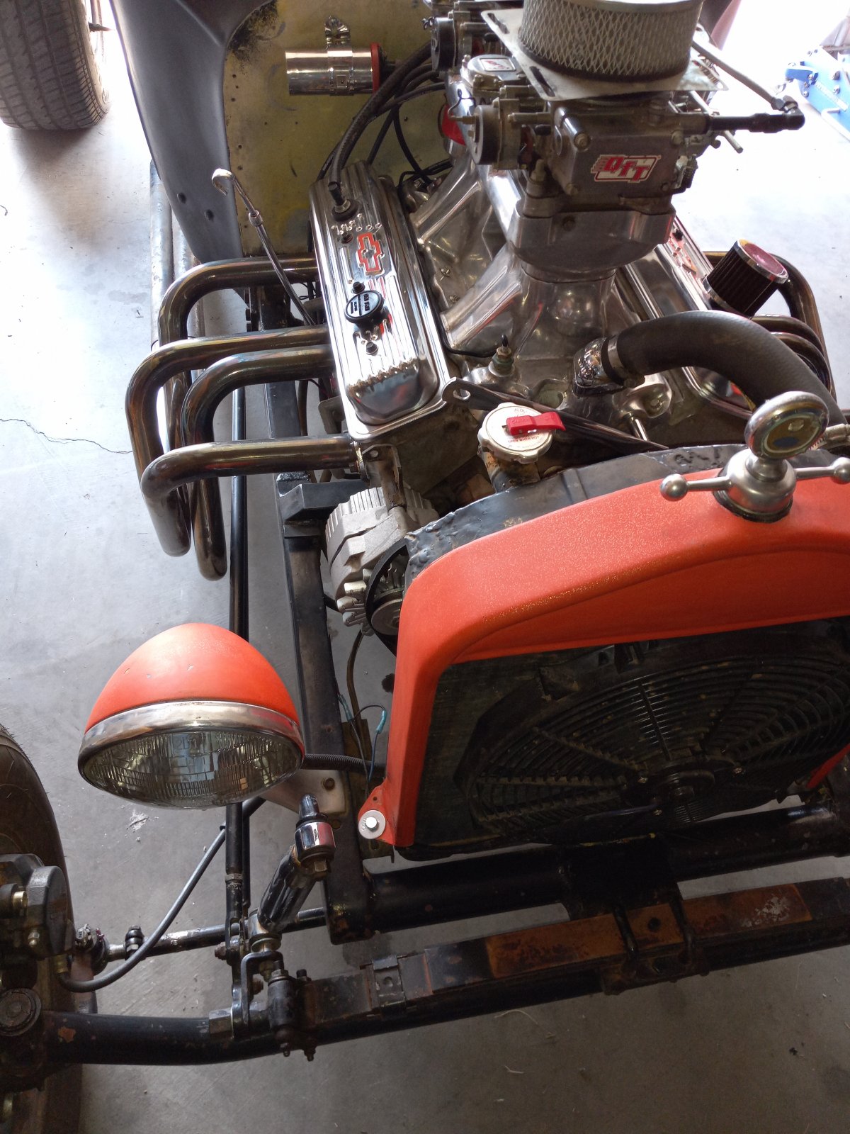

    It bolts to the inside of the frame rail and has a bit of a bump out welded at the bottom of the channel to pick up the lower bolt. It also leans back some. All part of the old school charm! :p
    I guess I could shim it to vertical, but it is okay where it is. Straight would put it over closer to the body. Some pics from a few weeks ago. I think the pic accentuates the angle. It's not noticeable at all when driving and is really solid. It's one of the things you grab to get up and in and out.

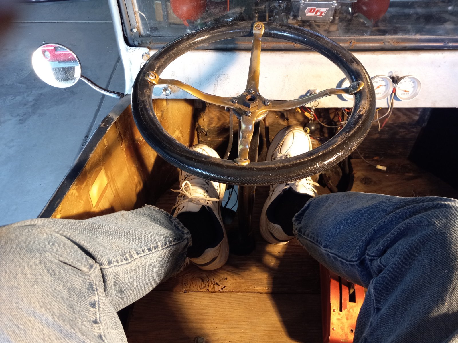

    It's funny, the front shot looks like it's leaning out, the interior looks like it's leaning in! Just remember, the body is currently sitting on some chunks of 1x1 and the cutouts in each corner, and the floor is drywall screwed to a 'ledge' inside the body that isn't perfectly flat or level.
    EDIT: just went out and checked. Have one of those old bubble angle finders.
    Garage floor was 0-1 degree to the left depending on where you put it.
    Frame and top of air cleaner 1-2 degrees left.
    Windshield area of body 1-2 left, rear of body level, bed is 1 degree left.
    Steering column is level! So it's within a degree or 2 of exact.

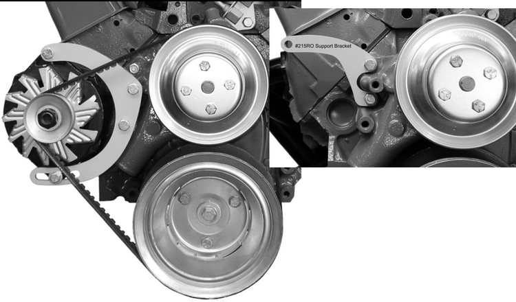

    The current water pump does not have the threaded bosses needed for the mid-mount bracket. It will have to be swapped out. Must avoid slapping more chrome on (front cover, oil pan).

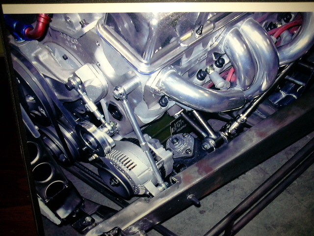

    Again. The picture of my '39 shows the alternator above the bracket, not below. When I later hung the alternator below the bracket it hangs below the header tube, and since the block below the head is narrower it also tucks in nicely. So it's not hanging outside the header tube, and isn't much wider than the tube.
    Don't worry about it though, since you've got another solution. I was simply offering an option, and thought you had read what I posted, not just looked at the picture.

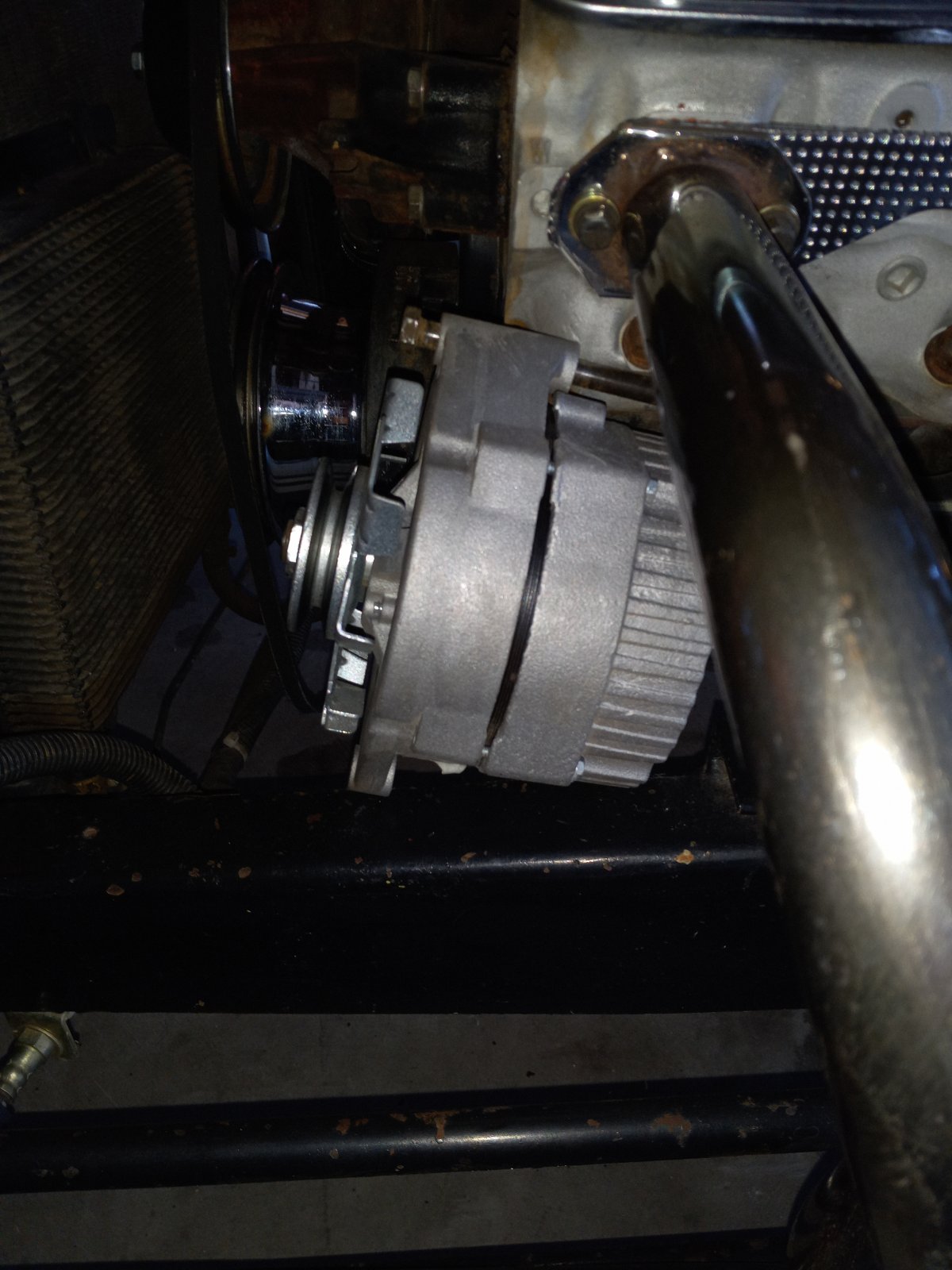

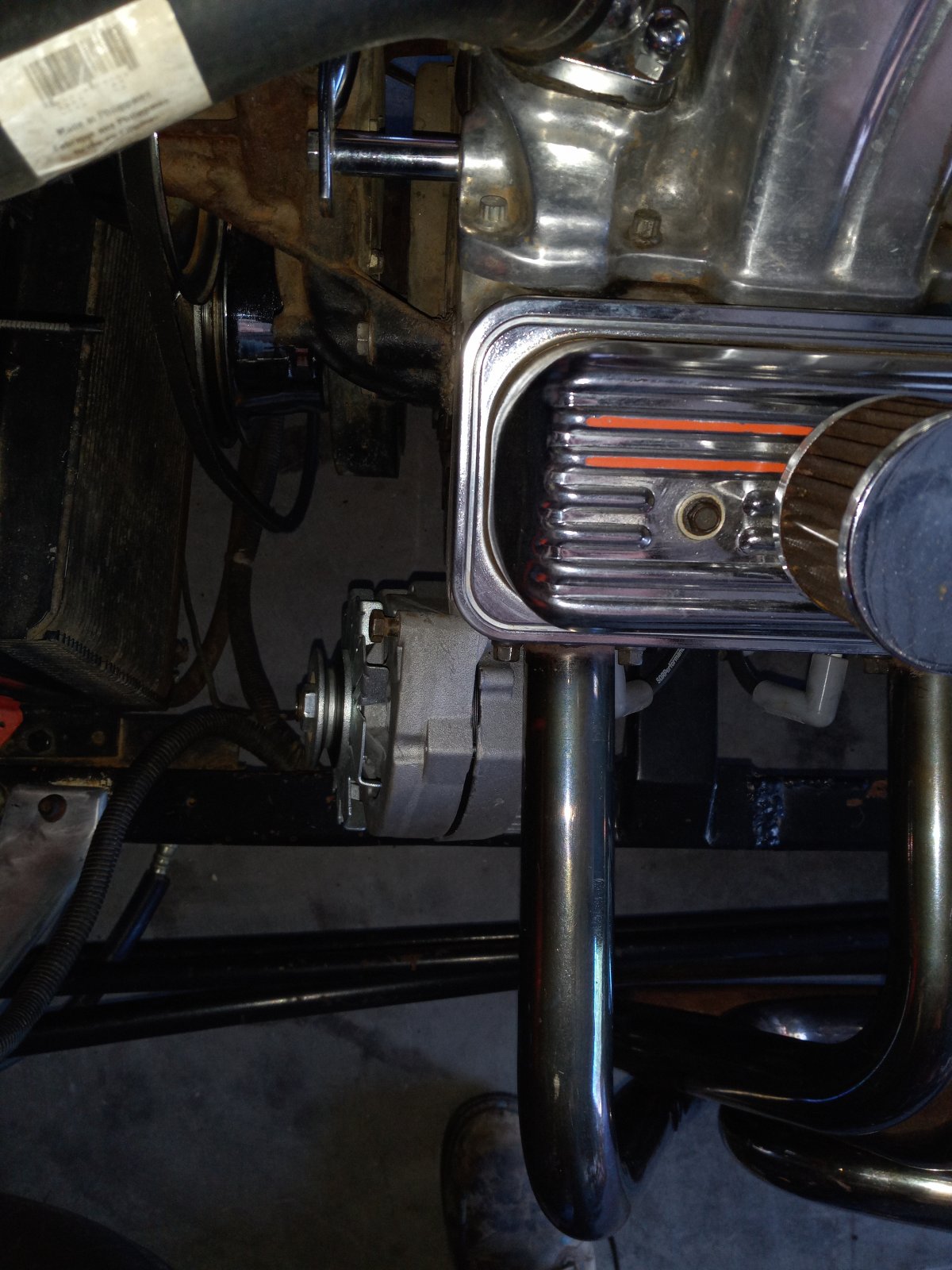

    Can we agree that if I used a standard GM alternator with ANY mounts that align with a single pulley short water pump, the depth front to rear on the alternator is too much to tuck in front of the block and heads? It must be placed outside this area to clear. The back of the alternator must be outside the Orange.
    Yes, it could be below the exhaust, next to the block but still outside.
    I wanted to show you how that works on the T, so I started removing the alt. The pivot bolt is not happy coming out of the aluminum head, so I'll work on that later. Instead, I grabbed an air pump that's roughly the same size and tucked it in as you describe. Sorry I couldn't place the exact same part in place.
    First as I got it.
    As I hope to attach it.This is when the bolt started to seize. I've soaked it and will work on getting it out. Note the wiring is disconnected. I tried to show you.
    The air pump filling in for the alt on the left side, back end outside the V8, below the exhaust, pulley roughly aligned with the front of the balancer. Again, sorry it's not the exact part, but it sticks out.
    So, it is on the left when I want it on the right, it bolts to the header, which I prefer not to do (yes, many have been done that way) and it sticks out more than either current or planned. This also shows why the mounts for the low mount Alt that is even lower will cause the alt to run into the frame on a T.
    So it is not going to improve things FOR ME. It may be great for you and many others.
    squirrel likes this.

    Got the bolt to come out cleanly. @1971BB427 I hope these explain that I have read, heard and understood.
    Alt on frame, directly below header. It's resting on the frame and engine as tight as it can be inward.
    It would require an outward swing to tension belt.

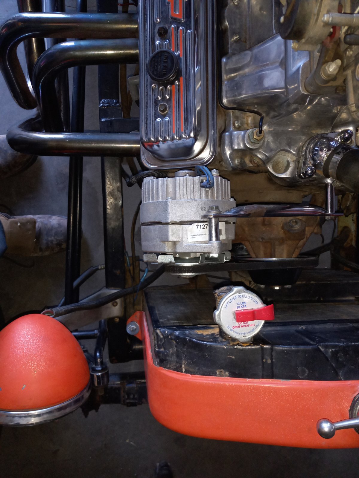

    20240714_092208.jpg Trying the low mount location, where brackets bolt to front of block. This looks good, but left side not right (run power lead over to the starter lug is more length under engine or around frame) and the length of travel to service belt is close to an inch. Must be perfect length belt and perfect travel in bracket. Good solution for others, requires more parts ($$) more wiring, and has narrow range of motion due to tight frame. Just trying to explain WHY I'm not going this way in my case.

    I think the issue is that the short pump uses a flat lower pulley, which means the belt is right up against the damper. And the alternator thus has to sit pretty far back, and there is no way to put it in front of the head/block, like you can with the long pump. So, it'll stick out the side more than he wants.
