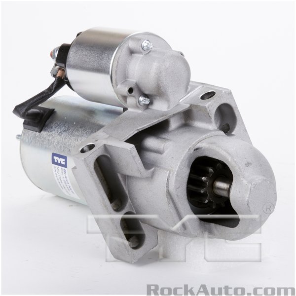

  11. squirrel
    Joined: Sep 23, 2004
    Posts: 60,164
    squirrel
    if you use the later model OEM starter, make sure you get the right bolts for it...they have the normal US threads, but a metric size shank.
    this is the starter for a 99 truck with a small block, $60 plus shipping from rock auto.
    That's probably what I would do.
    wraymen, scotty t, BigDogSS and 4 others like this.

  13. Have never yet wore out a late model GM starter like squirrel showed a picture off. Started a stout 468 for many years without a hiccup. Heat soak never seems to bother them. I haven’t used one of the old style started in close to 30 years.
    BigDogSS likes this.

  23. 270ci
    Joined: May 17, 2010
    Posts: 488
    270ci
    Would that one perhaps also work on an 1987 Caprice 350?

  25. 2OLD2FAST
    Joined: Feb 3, 2010
    Posts: 6,063
    2OLD2FAST
    from illinois
    The GM starter pictured appears to require the staggered block bolt pattern vs the straight across block bolt pattern . It also has only one set of mounting holes which leads me to believe it fits either 168 tooth OR 153 tooth flywheels , but not both . There may also be an issue between the starter nose cone & some bellhousings , someone ,I'm sure , can verify....

  27. squirrel
    Posts: 60,164
    squirrel
    The one shown is the stagger bolt pattern for the 168 tooth flywheel. The nose cones work just like the full size ones, regarding 153/168, etc. But the bolt shank holes are metric, so you need to make sure you use the correct bolts.
    I'd do some double checking if I were you. The bolt holes in the SBC are not metric! they are 3/8-16. But the shank on the special bolts to use the metric starter on the SBC is two different sizes, it changes at the point where the bolt enters the block.
    This has been discussed before on the HAMB, with part numbers...
    https://www.jalopyjournal.com/forum/threads/mini-starter-sbc.1156161/
    05snopro440 likes this.

  29. BigDogSS
    Joined: Jan 8, 2009
    Posts: 982
    BigDogSS
    from SoCal
    153 Tooth --> straight bolt pattern starter.
    168 Tooth --> staggered bolt pattern starter.
    mad mikey likes this.
