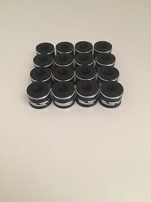

    Should be about the diameter of a Nickel, or just slightly larger.

    That looks about right. Thanks Gimpy. Good thing it’s already this far apart. I’ll get some new seals in there while I’m at it.
