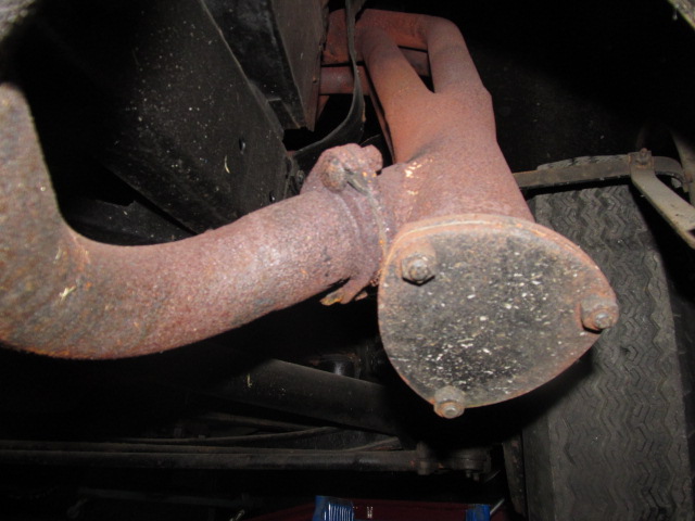

    These manifolds are very simular to the 305 malibu units. but no heat riser.

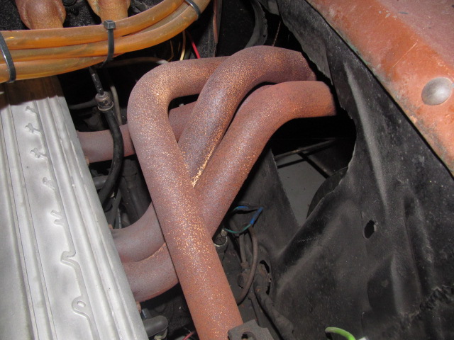

    Im not sure who they are made by as I didnt install them. They were put on the car in 1965 when it was first modified for street duty. They seem to be made for the car and not something that has been repurposed. heres a couple more pics of the headers and the collector ends too.

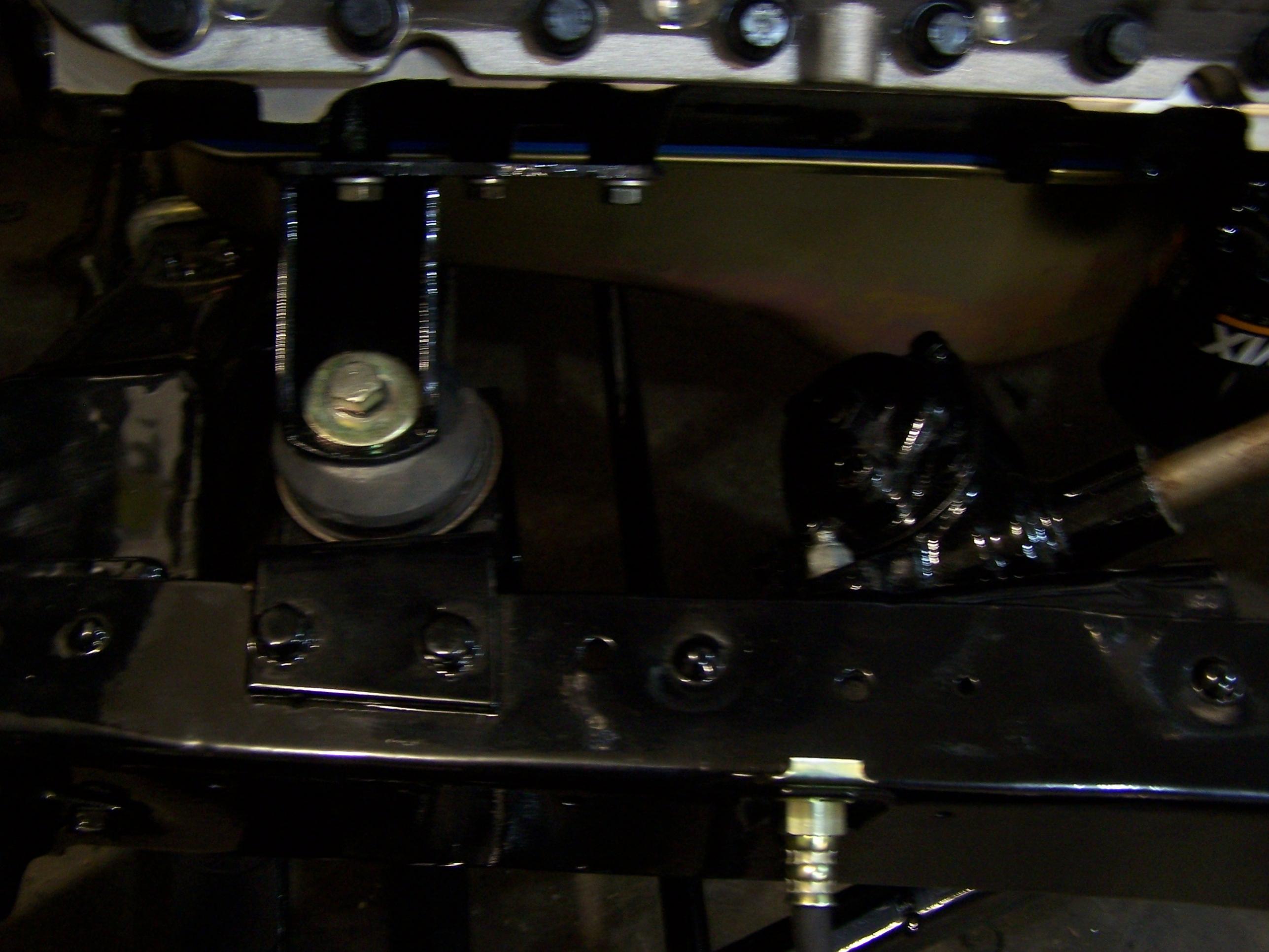

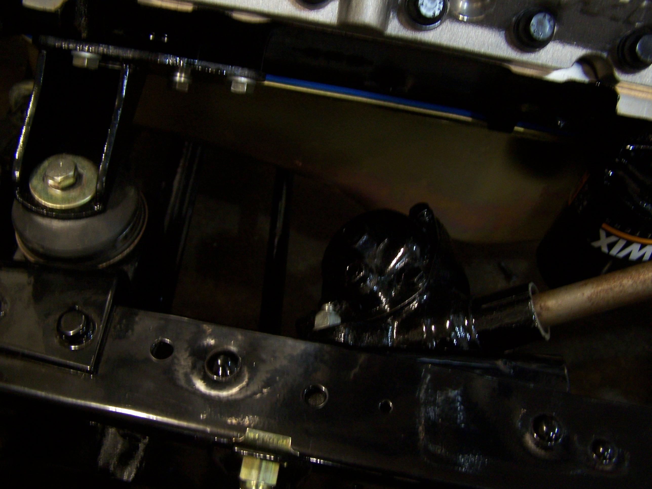

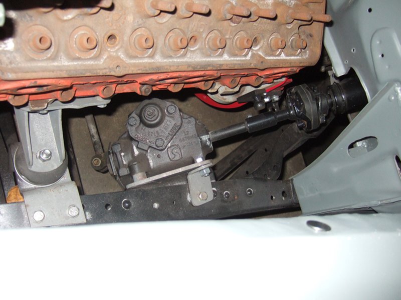

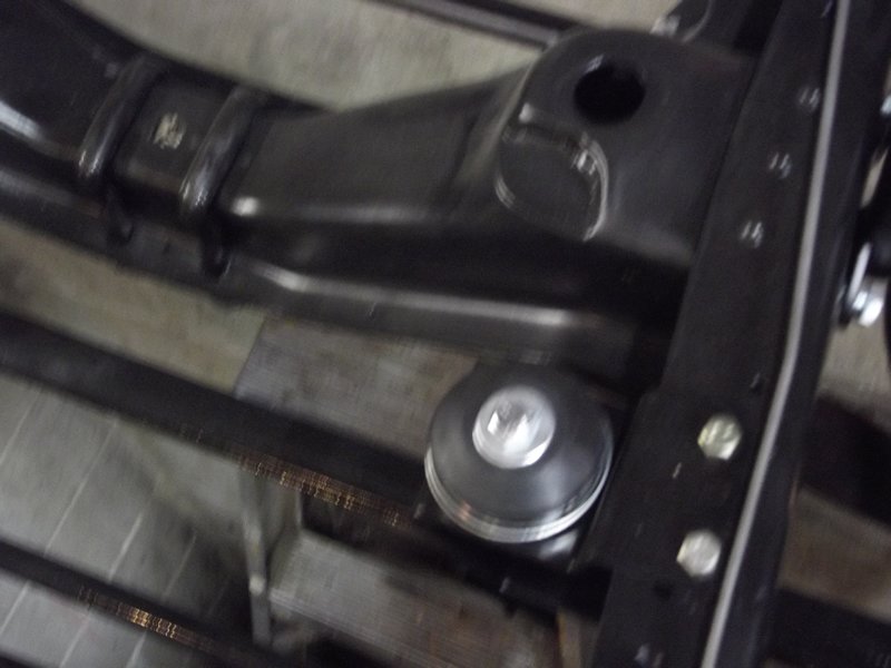

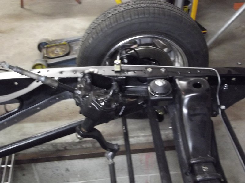

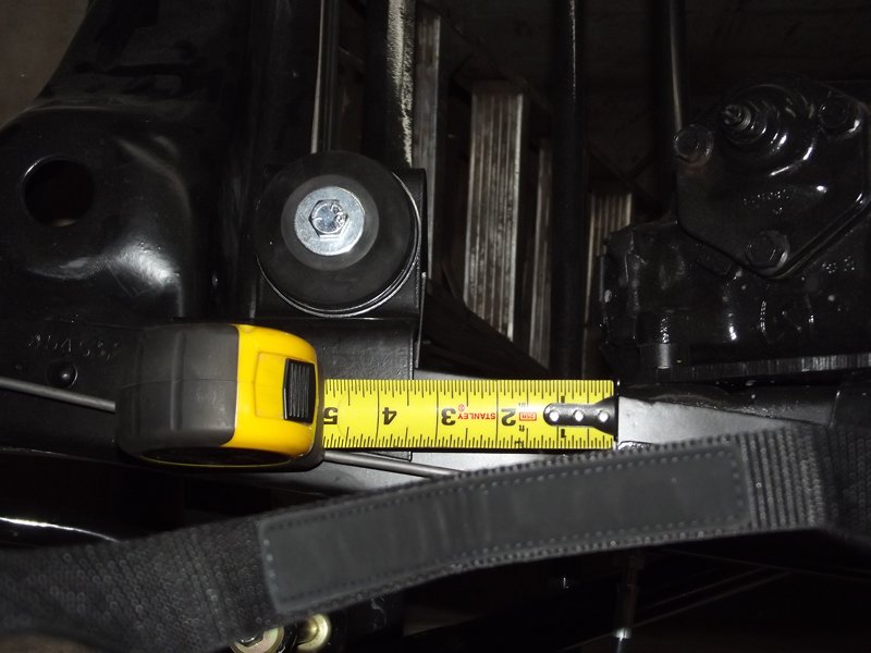

    Here are some pix of my mech fuel pump clearance and mount for sbc in a 40. Also a couple pix showing the space available with a 525 saginaw box using CE adapters and engine mounts. Notice the left mount is closer to the cross member to allow for the exhaust. The truck manifold already mentioned will work.
    olscrounger likes this.

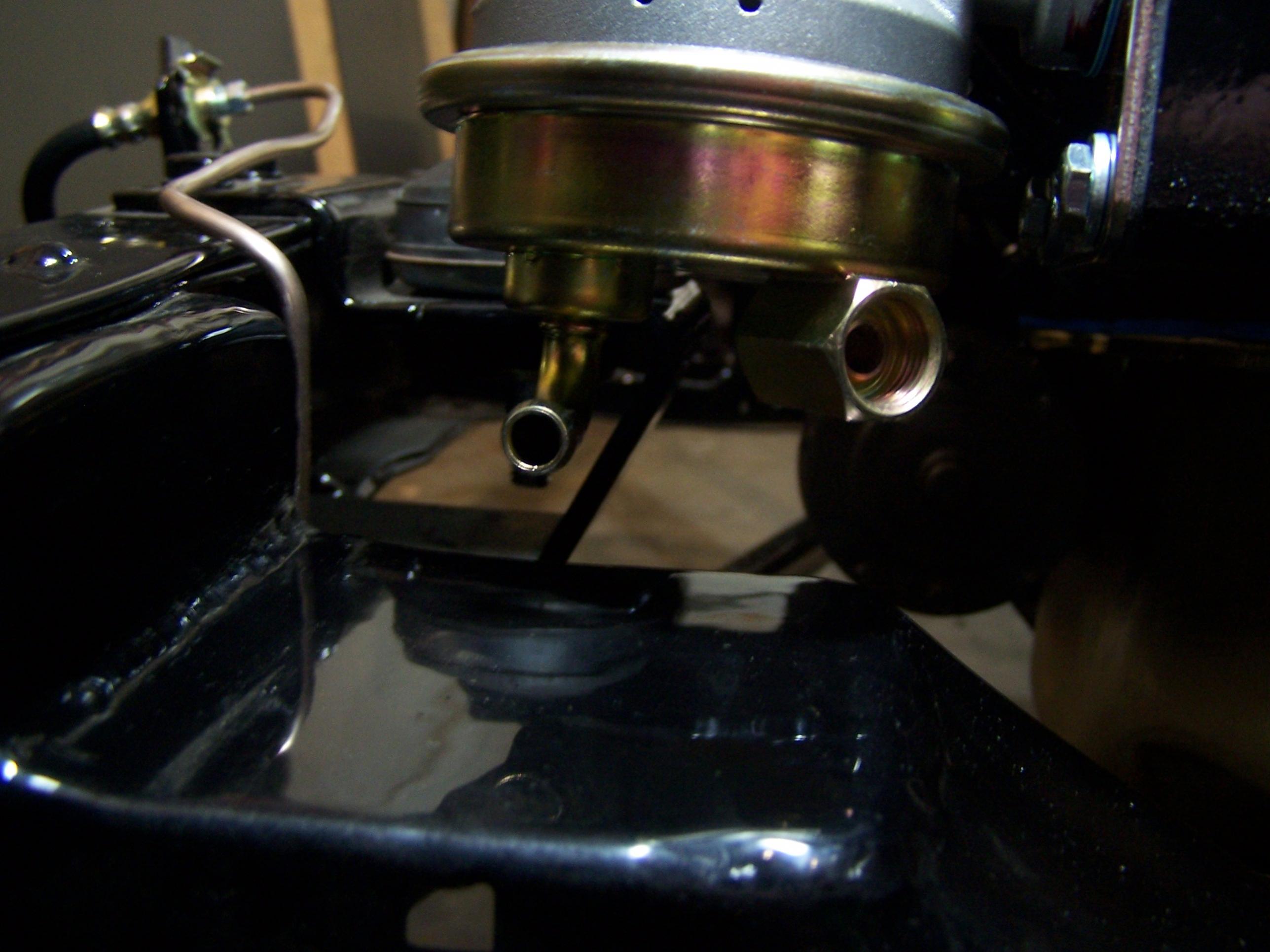

    I originally wanted to use a Hurst mount on my '36 but because of the fuel pump issue went with side mounts...only to discover that a stock GM still won't fit because of the crossmember. I did not want to alter the crossmember so I went with an electric pump, which I'm not crazy about.
    Recently I came across a mechanical pump at Summit that I can clock to relocate the fittings and I'm pretty sure it'll fit correctly.
    On the exhaust..?? I had an exhaust guy look at the tight fit and he said "can't be done...use 265 manifolds that dump at the front". I didn't want that so I just made the connector myself....

    Joel and Rich, those are some great detail shots, very helpful!

    good shots and some DAMN good looking pipework!

    I'm OK with the side mounts so I won't be changing them. But I am planning on installing the mechanical pump this winter. As with others, the issue will be interference with the crossmember, which I think this pump will resolve.
    It may not happen for another month, but I'll make sure I PM you or at least bring this thread back up with the results.

    Posts: 2,744
    Kan Kustom
    I Like those. Thanks
  19. Kan Kustom
    Joined: Jul 20, 2009
    Posts: 2,744
    Kan Kustom
    I like the way you did that pipe.

    I got my motor and trans in now with the CE side mounts and stock steering gear. It seems to me that with ram horns or some type of center dump block hugger header there is plenty of room to work exhaust thru there. My problem is that I've built a pretty serious 383 and don't want to kill the performance by putting restrictive manifolds on there. I'm also considering fenderwell headers if I can get them back under the car for full length exhaust. here are a couple pics for future reference in the side mounts vs. the Hurst type mount.

    I put my fuel pump on today and took a couple pics. I think Rich has the right idea with the other pump, It might just clear without notching the cross member. You can see in these pics there is plenty of clearance with the notch. I also went with the Sanderson headers that angle forward on the drivers side but they haven't arrived yet.
