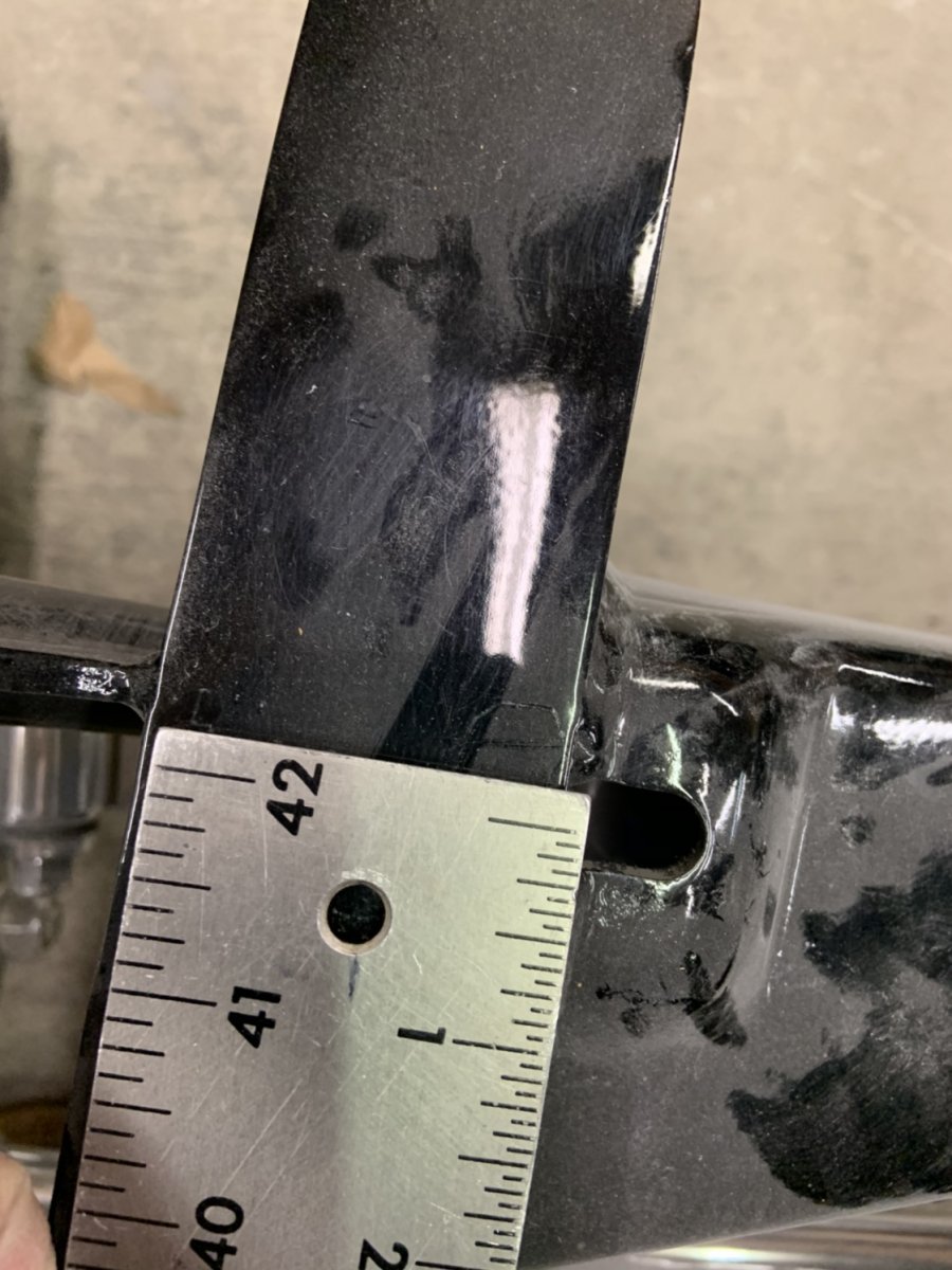

    I have a Brookville 32 pinched for an A with biscuit mounts for a SBC. This is bracketed done by Brookville so this is where they calculated it should be. I agree mocking everything is the best route but if you want these measurements I’d be happy to send them[​IMG]
    Just Gary likes this.
  13. jeff020571
    Joined: Nov 9, 2011
    Posts: 72
    jeff020571
    from france
    It is exactly what i'm looking for, i'll really appreciate your measurements. Centre radiator mounting holes to centre of biscuits mounts if possible.
    Thanks
  14. Dino 64
    Joined: Jul 13, 2012
    Posts: 2,539
    Dino 64
    from Virginia
    Glad I can help, I’ll go out the garage and measure
    Right back
  15. Dino 64
    Posts: 2,539
    Dino 64
    from Virginia
    Looks like 15 1/2” Measured a few times, real close if not exact. IMG_0449.JPG IMG_0447.JPG

    Yes, 14 3/4”
