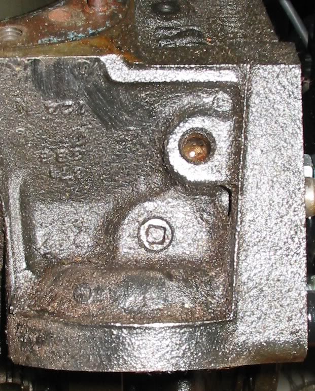

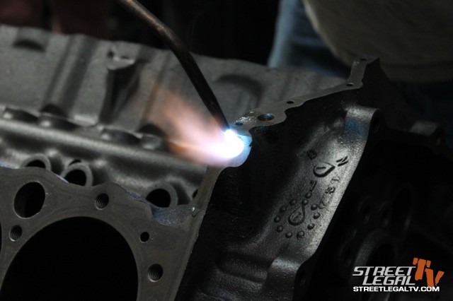

    My 1967 283 has plugs in these holes with out the square keyhole, on the china rail and just above the oil filter. Do they need to be removed for a rebuild? This looks like a PITA to remove them, but if I drill them out with progressively larger drill bits and then try to torch the remains out, have I really gained anything? Should I have the machine shop do it? Experience-based advice please. plug 2.jpg plug 1.jpg

    the first picture..isn't that the threaded hole for the clutch Z bar support? (the thing about two inches above the square hole plug)

    No, I'm talking about the square hole plug. The one I have has no square hole, or any hole, in the plug. I get that the other was for the Z bar.

    I agree what Baumi has said. Also in the second pic. When you finish cleaning the block,Don't forget that top plug. you can not put it in after the head is on and it makes one heck of a mess if you forget . Also in small block chevys in the oil passage in the block where the oil pump bolts on there is a plug. Leave this plug out, you WILL HAVE OIL PRESSURE but you will not know you have no filtered oil. Some times when a block is hot tanked the shop will not put this plug back in. The filter will fill with oil and you will think everything is ok but it is not.

    oh...you gave us pictures of someone else's engine! that's confusing, eh?

    Sorry squirrel, I'm at work and don't have my iPad.
    The other plugs are all out of the block, even the hidden one.
