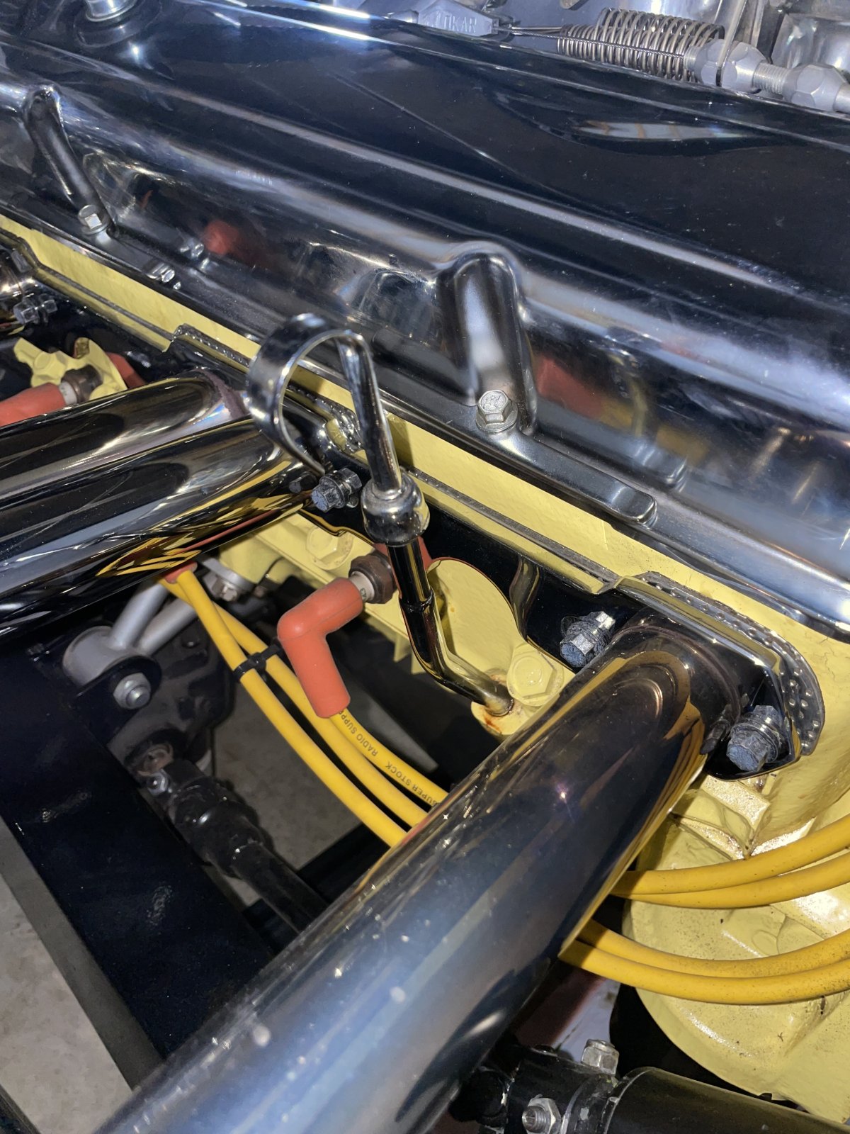

    I have researched a good bit and understand that the small block Chevy is 5 Qt (or 5.1) for the 350, but this is with a stock pan and stock dipstick.
    My issue is that I have an unmarked pan and a Mr Gasket aftermarket dip stick reading well over full after 3.5 Qts and this can’t be right.
    Does anyone know 100% what the oil max height distance should be in comparison to the bottom of the block where the oil pan bolts up? I’ve seen a few answers but I’m hoping someone here knows the true answer.
    It’s a 73’ Camaro block and I need to do the 2pc rear main and the pan gasket anyway so I can mark the dipstick where the oil max should be and use the standard distance on there now to make a new minimum line as well.
    This looks like a speedway or other brand aluminum cover but the bottom portion is slanted for better draining and the new finned aluminum models I see around look parallel to the block without this ‘drain taper’. I don’t want to do any damage running it overfilled (like wiping out bearings).
    Thank you for the help!
