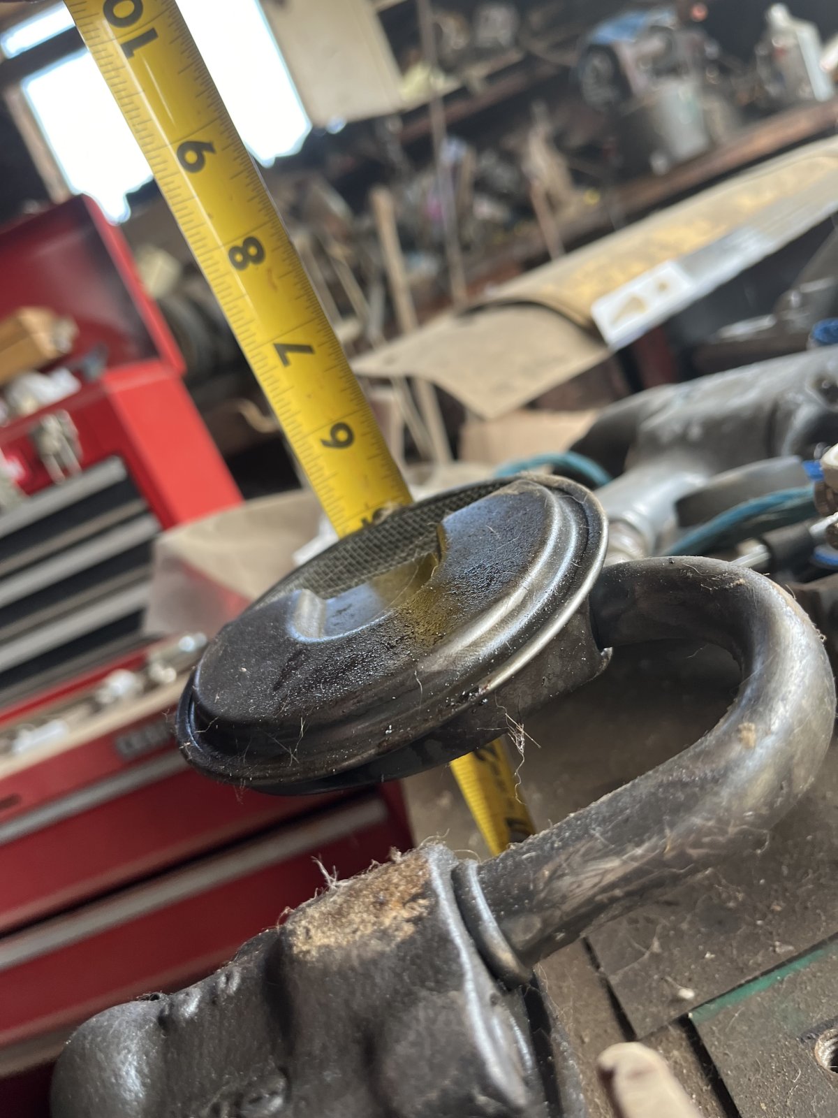

    So let’s see if the below pics are better. Do not there is a speed bump dent in the sump of the pan.

  8. Budget36
    Joined: Nov 29, 2014
    Posts: 15,305
    Budget36
    So 2-3/8, 5, and ***ume Eddy is right and my pan should be 7-1/2, not the 7-1/4 I have with the dent.
    Puts the bottom of the pick up right where Jim and yourself said.
    See, I can admit to bad eyeball measurements and mistakes!
