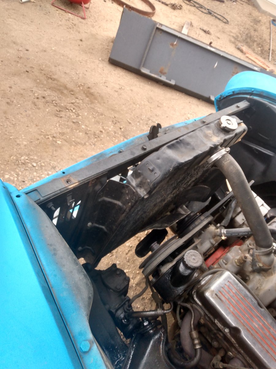

    Fan is on right. Engine turns clockwise when looking at it, so that fan will pull air through the radiator
    wraymen and Happydaze like this.

    Plugged radiator either inside or out and possible air flowing around the radiator rather than through it. 57  from back side_LI (2).jpg

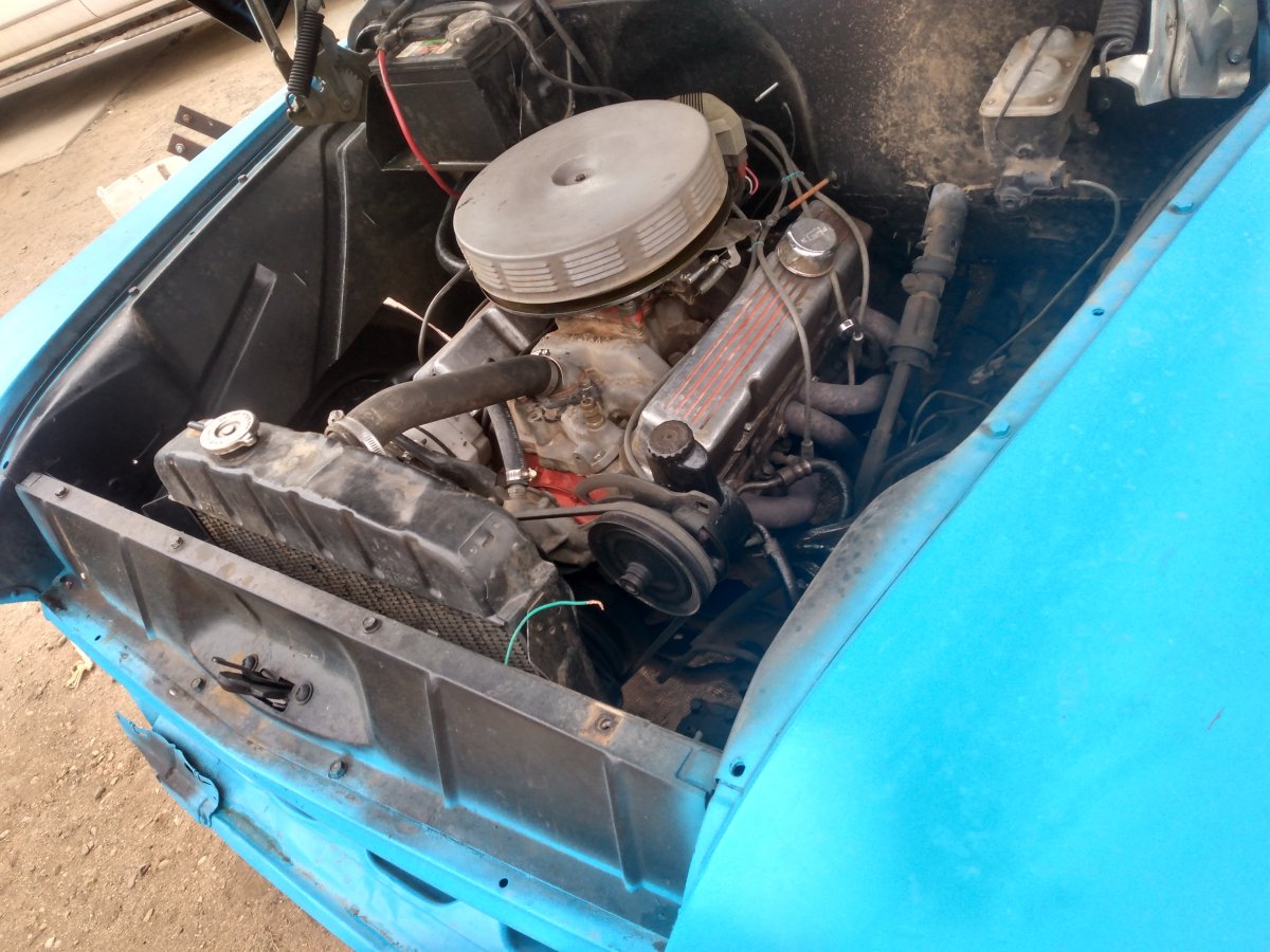

  26. FRANK GRELLE
    Joined: Oct 15, 2018
    Posts: 158
    FRANK GRELLE
    I the pictures of the moter i see were the temp gauge goes in at the manifold ,but there is nothing hooked to it,were is your sender for your gauge?
