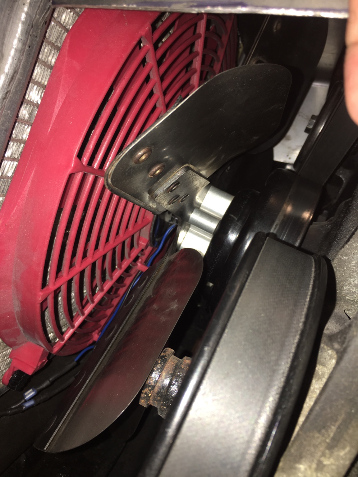

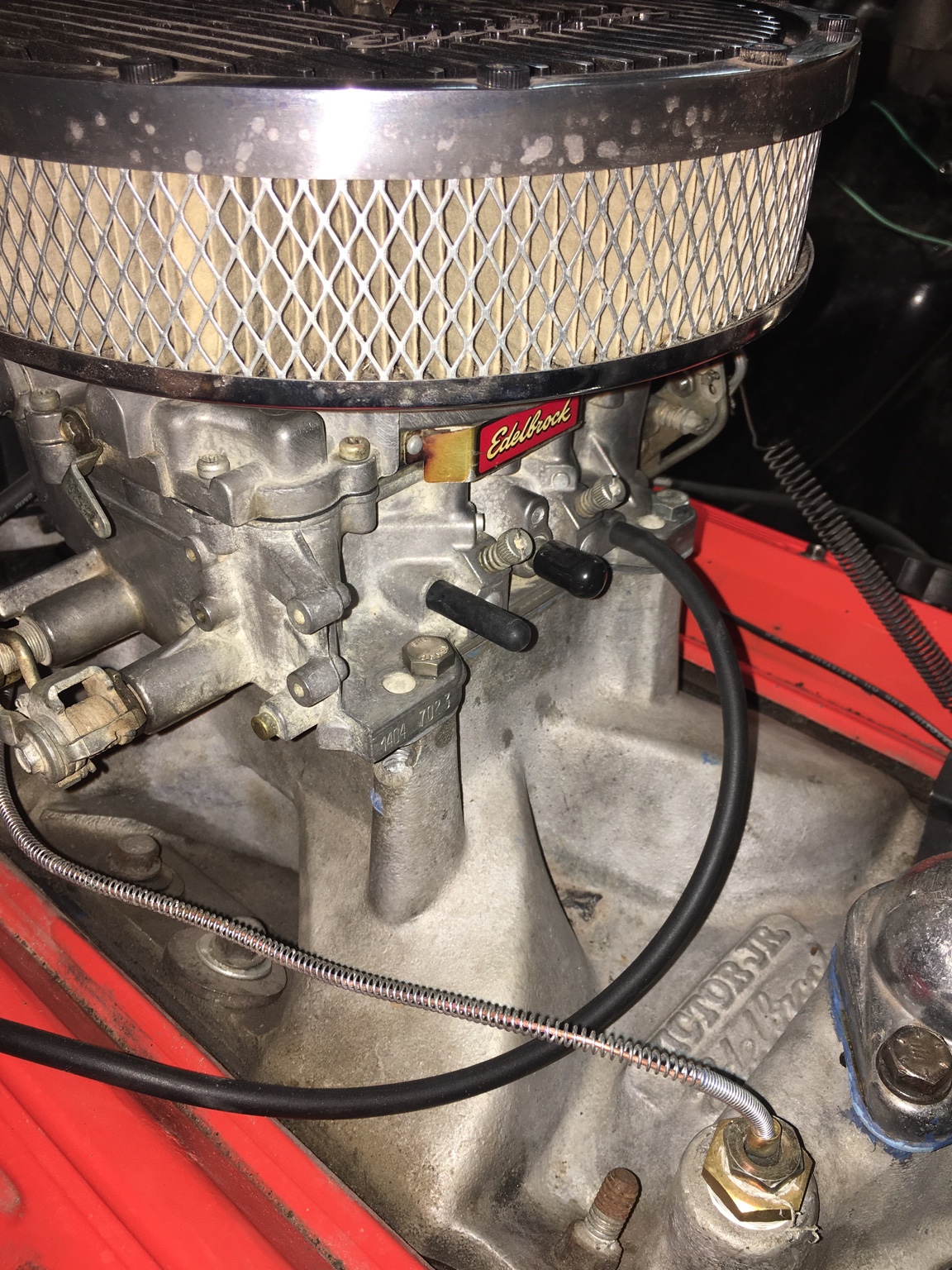

  10. 55panelwagon
    Joined: Apr 28, 2017
    Posts: 62
    55panelwagon
    Here are some pics, guys. I included one of the carb to show the vacuum advance hook up location.

    Gman0046
    Electric fan in front of an engine driven fan? Whats with that? I'd ditch both of them and install a 6 blade steel engine driven fan.

    SUPER MODERATOR
    you have a reverse rotation water pump and a normal rotation fan. those two things will not work together. the elec fan and mech one are fighting each other.

    55panelwagon
    So this fan will not work regardless of how it's mounted? Also, the electric fan should be mounted as a puller I thought? Aren't they more efficient that way? I really do appreciate all the help guys. Please don't be harsh on me, here.
  15. squirrel
    Joined: Sep 23, 2004
    Posts: 60,039
    squirrel
    buy a reverse rotation fan blade. Remove the electric fan.

    Ebbsspeed
    I'm surprised the fan blades haven't laid back at high RPM and hit anything. The blades on those fans are supposed to bend into a flatter airfoil at high RPM, but since yours is spinning backwards the blades are actually biting bigger chunks of air and pushing it towards the radiator. You put the right rotation fan on it, it's gonna be quieter and probably give you back a couple horsepower.

    55panelwagon
    So I'm guessing the flex fan I have know is normal rotation?
  22. Moriarity
    Joined: Apr 11, 2001
    Posts: 37,747
    Moriarity
    SUPER MODERATOR
    yes
