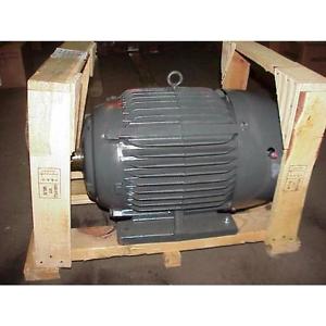

  10. I've seen these tests before.
    I won't argue their findings but I certainly would like to know how a 1/3 hp electric motor that almost fits in your pocket can do it.
    Ths s a 30 hp electric motor

    That's an 30hp Induction Motor....maybe 3000RPM and about 80% efficient. My work life couldn't be further divergent from my hobby. In my work life I do product development and business development for high performance, high power density EV and HEV's electric motors. Change to Permanent Magnet motor at 97% efficiency, Spin at high speeds (6,000RPM-12,000RRPM), incorporate water cooling and push the thermal limits, and an you can get 175hp out of a motor the size of gallon of ice cream.
    You can see it right in front of the rear tire. Crazy thing is the reliability........, and this technology is being worked into pump motors, fan motors, to reduce weight and space claim on all types of vehicles.
    Don't get me wrong I still prefer my caveman shop and old hot-rods!
