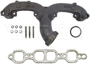

  10. Do you know which application that had the ram horns that point back and in?
    Can you upload a picture of them?
  11. squirrel
    Joined: Sep 23, 2004
    Posts: 59,927
    squirrel
    I've only seen the one that angles back, as used on 67-72 trucks....
    Chavezk21 likes this.
  12. 55 Ford Gasser
    Joined: Jul 7, 2011
    Posts: 762
    55 Ford Gasser
    This is the one I'm using on my '57 Nomad. I tried new ones from Speedway and couldn't even get them in between head and steering box. I'm using 500 series box.
  13. DDDenny
    Posts: 22,393
    These are off of 64-67 Novas.
    Chavezk21 and squirrel like this.
  14. bobss396
    Joined: Aug 27, 2008
    Posts: 18,736
    bobss396
    Same as a '65 to '70 Impala/ Belair. But takes bracket attachments at the front.
  15. squirrel
    Posts: 59,927
    squirrel
    The full size cars used an angled manifold on only one side, eh?
  16. bobss396
    Posts: 18,736
    bobss396
    I believe only the Chevy II and Nova (up to 1967) had the angle on both sides. The years I mentioned for the big cars the p***enger-side was straight.
  17. squirrel
    Posts: 59,927
    squirrel
    Trucks had angled on both sides. I think you're right about the cars.
  18. bobss396
    Posts: 18,736
    bobss396
    I know the trucks '60 to '64 were straight on both sides, maybe as late as '66. I went headers on my '65 C30 with the SBC swap.
  19. squirrel
    Posts: 59,927
    squirrel
    trucks went to angled manifolds in 67 when they moved the engine forward....
  20. bobss396
    Posts: 18,736
    bobss396
    I thought so. I was looking at a lot of different manifolds on my latest swap. Dorman makes a good set of truck ram horns manifolds.
