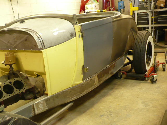

  18. I pulled this pic off a Model A build here on the hamb. I am going to use this solution as my steering shaft and exhaust pipe are trying to occupy the same space on my Model A build as well. I am using 2" outlet ramhorns but I think it would be the same for 2 1/2".
    I had a friend with a computerized plasma machine cut me some 3/8" flanges (we just scanned the gasket into the machines computer and changed the size of the center hole) . At NAPA Felpro flat gasket # for 2 1/2" ramhorns is 60117, the price is $1.80. It looks like the one pictured in the post above and takes a day to get them from their warehouse. Speedway sells "U" Bends in 2 1/2" for about $11.00. you can cut up and configure what ever you need. There are a couple of threads on here pertaining to that. Hope this helps you with your dilemma.
    I am using a Heat Riser ramhorn on the drivers side (no bevel for donut gasket) and a 1968 thru '72 chevy pickup ramhorn, that turns back, on the passenger side. The NAPA Felpro # for 2" exhaust flat gasket is 60083 with the same price of a $1.80

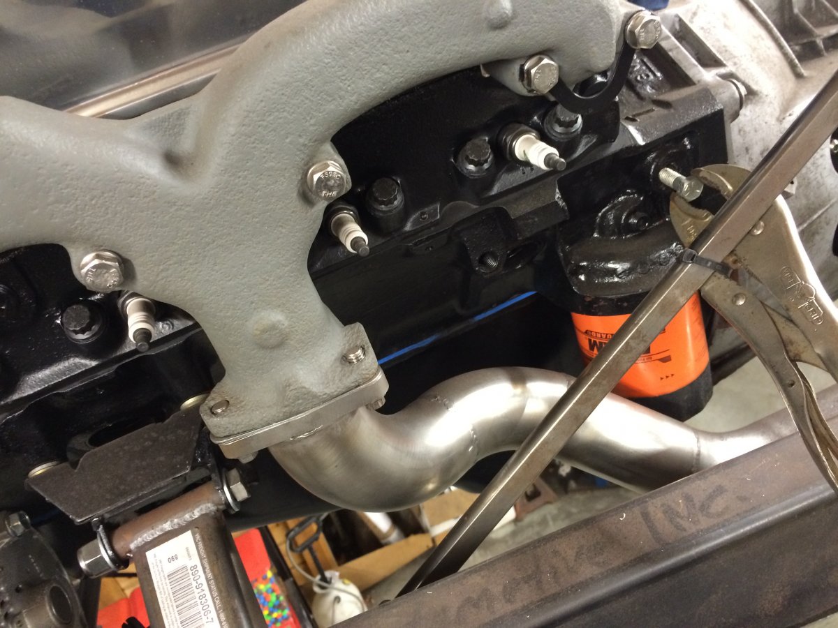

    Well, It took me a few days to gather up the parts I needed. I started out making the flange .
    I ordered the 2 1/4"street rod exhaust kit plus the tight ninety.
    While browsing the catalog I noticed the 2 1/ 2" to 2 1/4" reducers , so I bought them which worked out really well
    It allowed me to make a very quick turn right out of the gate
    I had to tack in my motor mount so I could put the weight of the engine. So the view is obstructed
    I want to thank all you guys for taking an interest in this part of my project .I guess it was a group effort. Thanks to all, I really appreciate it. Bill

    Thank you for returning to post your solution. Looks good.
