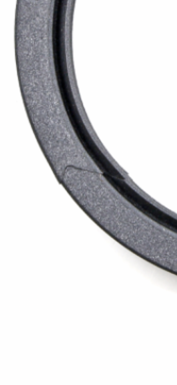

    Wondering how it goes in/procedure? Will it fit over the flywheel/flexplate flange?
    I guess it does, but not building engines daily. ;)
  15. Johnny Gee
    Joined: Dec 3, 2009
    Posts: 14,051
    Johnny Gee
    from Downey, Ca

  16. 427 sleeper
    Joined: Mar 8, 2017
    Posts: 3,310
    427 sleeper
    I don't think you can replace it with the crank in the block, not sure the crank will drop down far enough to let it roll in.
