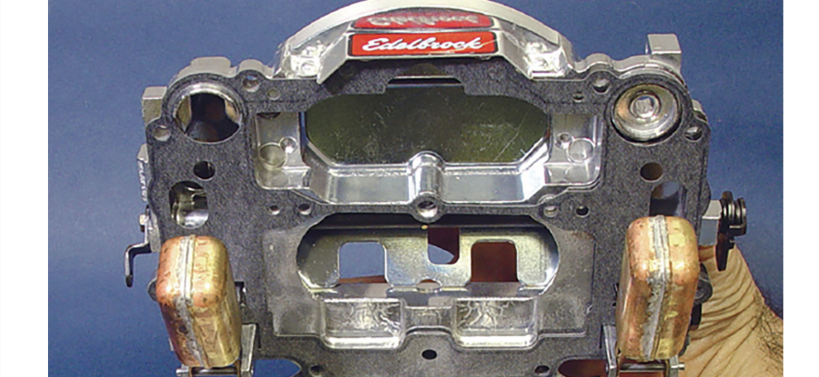

    ^^^^^ I’ve never opened an Edelbrock but have have to think the orifice at the needle and seat is larger because of the single inlet. If my hunch is true??? that would explain why Edelbrock carb needs lower pressure to seat valve correctly.
  12. Happydaze
    Joined: Aug 21, 2009
    Posts: 2,347
    Happydaze
    Hunchbusted!
    Edelbrocks have one inlet but the two bowls are fed from two separate valves. There's an internal transfer tube that runs across the carb directly behind the inlet port.
    Chris

  16. Johnny Gee
    Joined: Dec 3, 2009
    Posts: 14,273
    Johnny Gee
    from Downey, Ca
    No wonder to why these carbs are so w i d e. 4556C929-F28C-4F7E-AD8A-AD965CC9CA53.png
    mad mikey, 427 sleeper and Tim like this.
