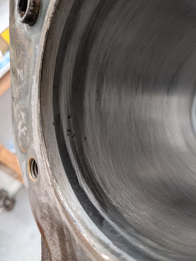

  16. Does not look good

    Looks like a sleeve would be a good idea.

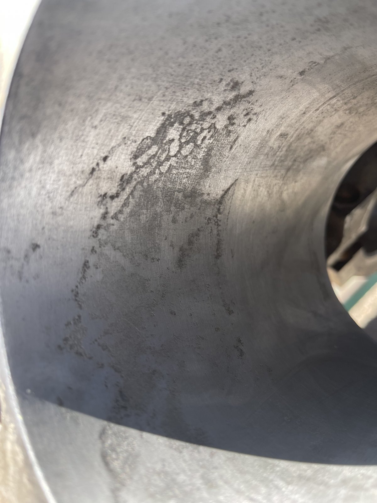

  20. Swapping to the other 30 over block I have

    Great pic !
    Do you have a little better pic,,,,,looks a lot like a stain,,,,,,and some minor pitting ?
    Looks like the worst spot is beside the shadow .
    Tommy
    BOSTONCAMARO and Algoma56 like this.
  23. NoelC
    Joined: Mar 21, 2018
    Posts: 669
    NoelC
    I think most would say that isn't casting porosity. Looks like left overs from a head gasket leak and sitting. I'd revise my opinion against the JB Weld for that and just run it knowing it'll foul the plug a bit more and it may blow slightly blue. I doubt however it would be clouds of the stuff.
