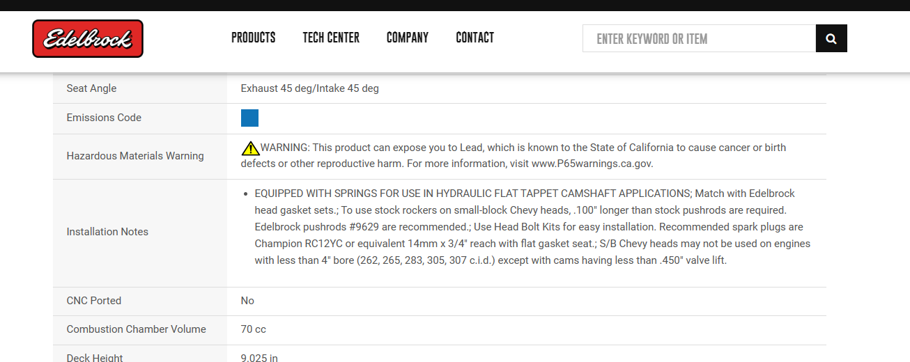

    Checking the info on the head, it does call for the RC12YC 14mm withthe gasket. What fits most Chevy 350's doesn't fly here.
    Screenshot (1804).png Screenshot (1805).png Screenshot (1807).png I don't know if there is a viable heat range comparision chart anymore with the one size fits a large area of heat ranges that they have now plugs. That particular AC plug R45XLS Fits 250 Chevy sixes but isn't listed for any small block.
    Outside of the larger hex and ?? heat range it does fit the head though.
