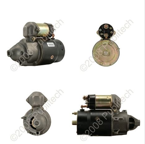

    I prefer the old 3 bolt style ( to the bell housing ) ... :)
    WAY less fitment issues. Plus they have IRON heads ... not aluminum :(
    Very easy to upgrade them to Big Block starter specs.
    Just use the IRON head from the 3 bolt starter and bolt it to the big block starter ( see the little brass spacer ). The big block starter is longer, tougher and cranks HARDER :D
    I have puller the engine ... without removing the starter ... with the 3 bolt style
