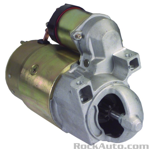

    Are you sure that's the right starter? It should look like this, yours is different. Get parts from the parts store, not a buddy who has something that you don't really know what it is.

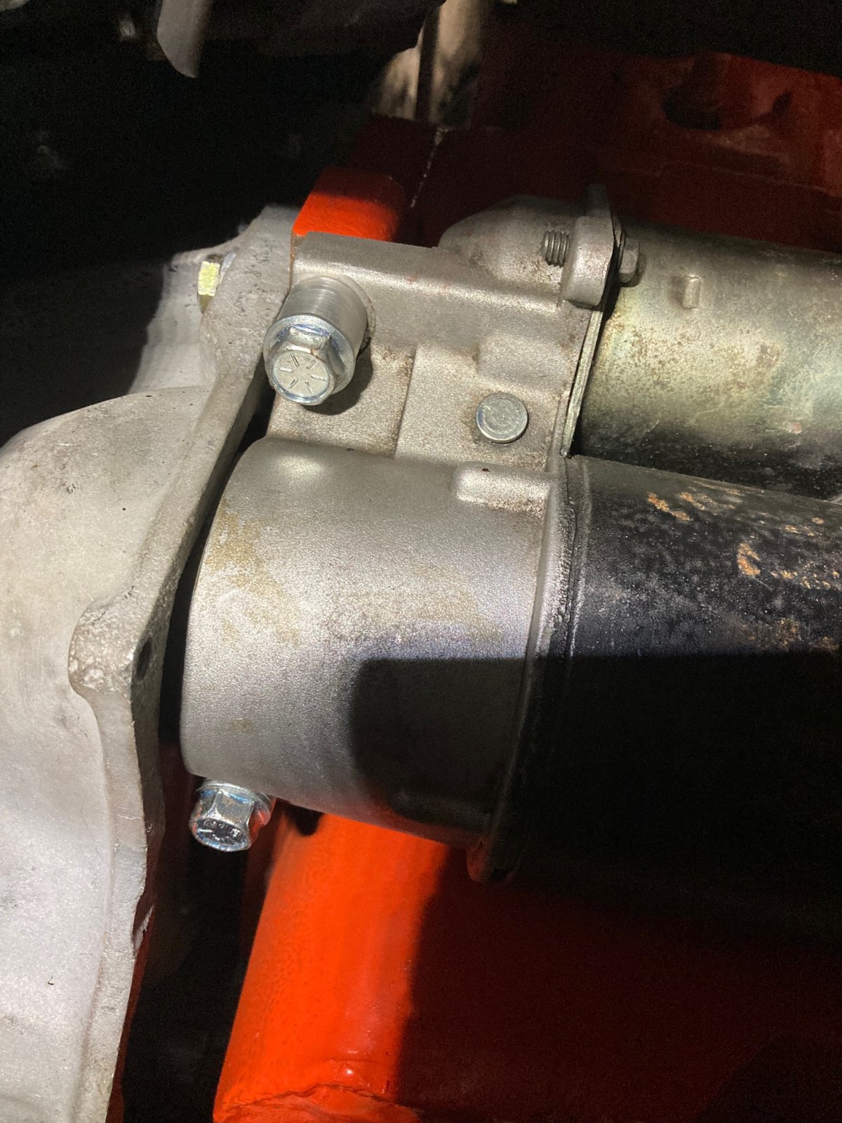

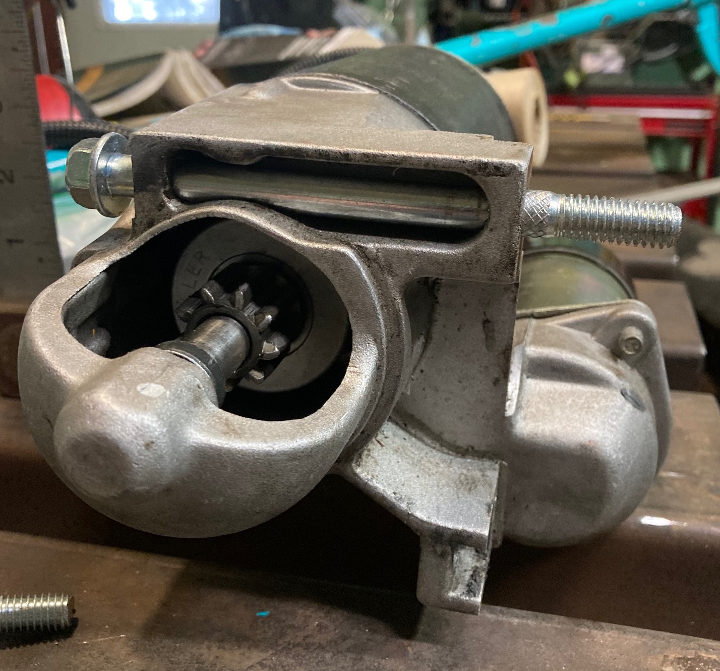

    My starter was definitely in a 1980 305 sbc. My engine's an 86 to 88 block. His was an auto, I'm using a manual. No idea if the starter was OEM to the 1980 305. Since I have a 153 tooth I figured the straight bolt pattern starter was worth a shot. I'm not opposed to buying another starter and bolts, that's just how it goes sometimes. I'll have quite a collection of parts to sell/trade when I'm done.
    But... I saw theboss20's reply first and now I see everyone else's replies. So, your probably not going to approve of what I did this afternoon. I am using sbc starter bolts. They're just too long. From what I can tell I need 4" and 1.5" bolts and I'm not seeing them available. I turned spacers to get the cross hatch aligned to the proper spots. I torqued to 35 foot lbs. A 1/8" Allen key slides perfectly between the starter shaft and the OD of flywheel teeth. Is this a hard no? Thanks for the replies so far. Sometimes googling gets you 70% there but just not quite the answers you're looking for.

    Looks good to me. I think you understand how it all works, and are taking the care necessary to make sure it does work.
    rock on!
