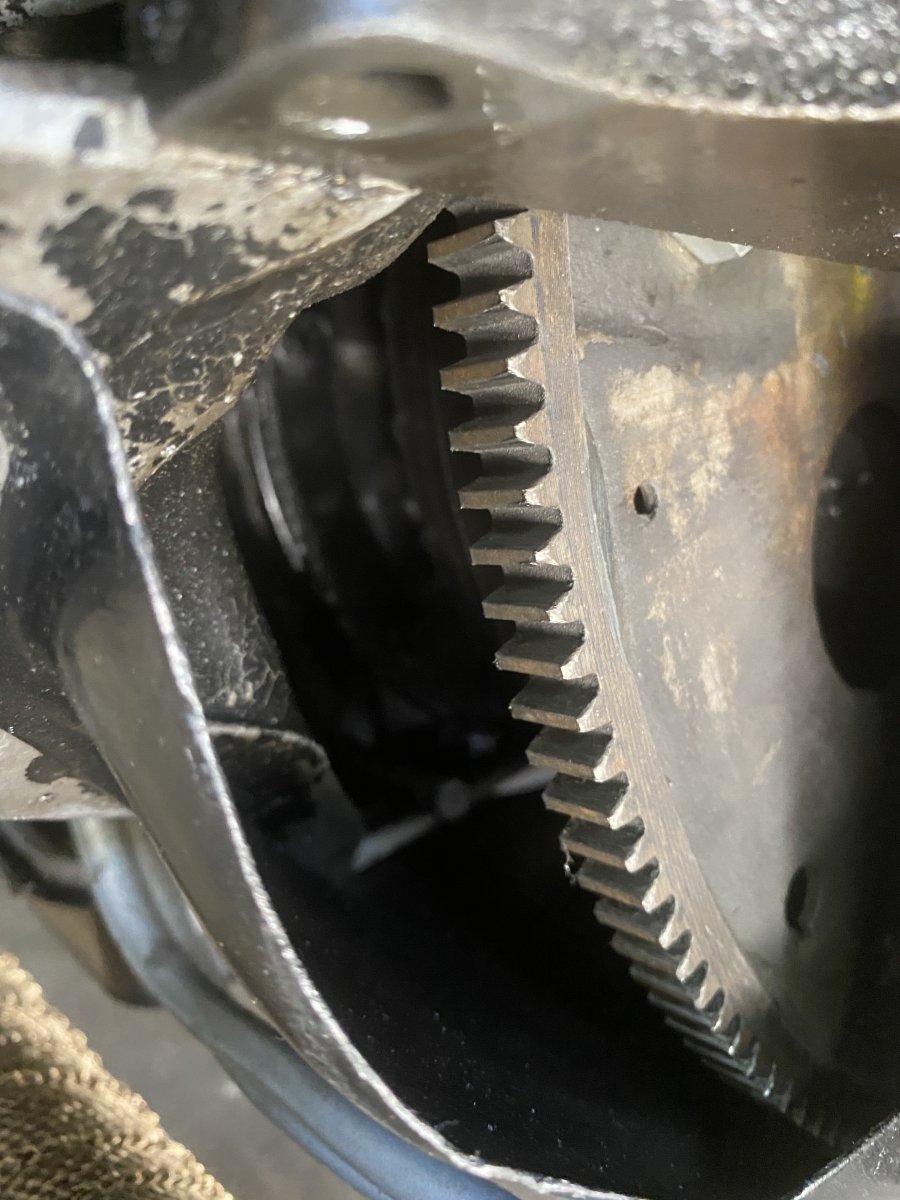

    I went and checked the clearance and found about 1/4” between armature shaft and flywheel. Well over the 1/8”. Any ideas whats going on here? IMG_0267.JPG IMG_0266.JPG

    But the gap is too big. How do you lessen the gap. The shims would widen the gap.
  13. wheeldog57
    Joined: Dec 6, 2013
    Posts: 3,912
    wheeldog57
    Your picture shows to me the starter looks too far away from ring gear, maybe the bolt holes have enough slop in them that you can loosen bolts, push starter forward, re tighten?

    I’ve had a few with a gap like yours and the gear on the starter still works fine just like your saying. Yours is a release problem and unless you can get a screwdriver or other tool to drive it in I would try the thinest shim and see what happens. If it’s better but not quite right add another thin one. I’ve never had an aftermarket starter not need a shim.
    Also since have such good photos. Lay under the car and watch it work if it goes in 1/2 way on the ring gear for me that’s been fine; it’s all we have on our Dart block race engine with 14-1. Disconnect the coil wire and have some one crank it for 10 seconds and film it with your phone. You then see if it falls out and the starter gear is all the way to the stop. Good luck.

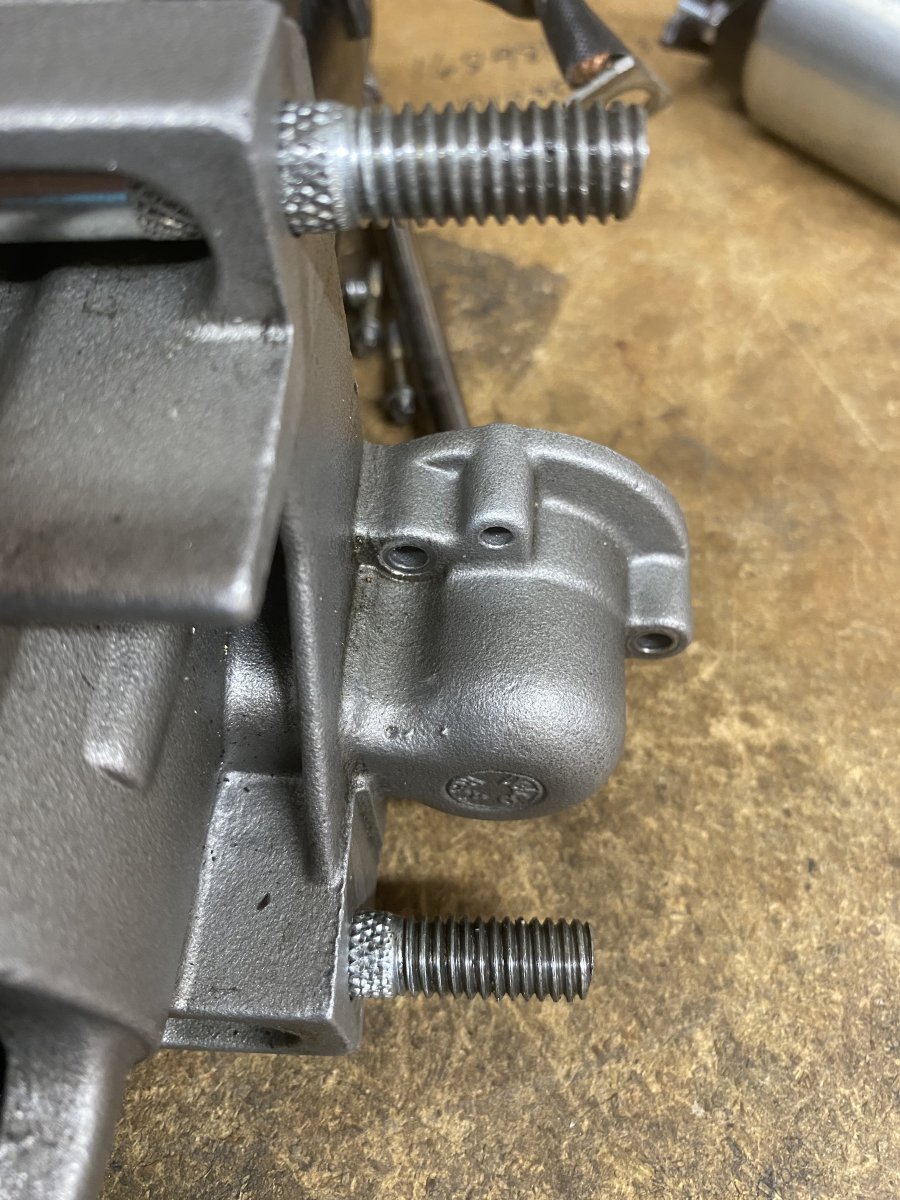

    Hard to see but the bolts don't look like the correct ones with the knurling on them--loose fit? I kinda see a gap between bolt and hole it goes thru in photo-correct bolts might help

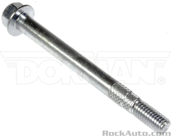

    Are the bolts of correct shank type?
    Example

    Show us full photo of starter to see if it's SAE or Metric (shank only not threads) size bolt holes.

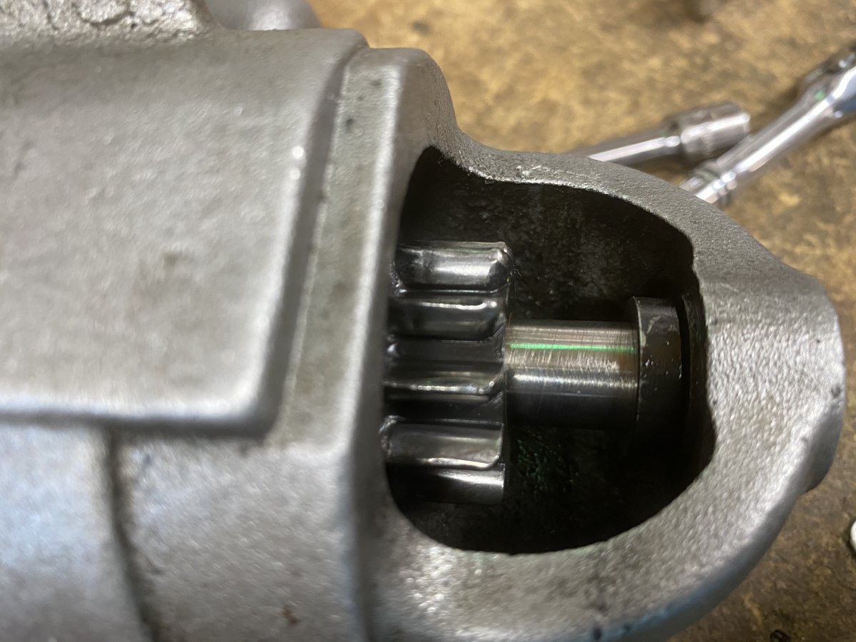

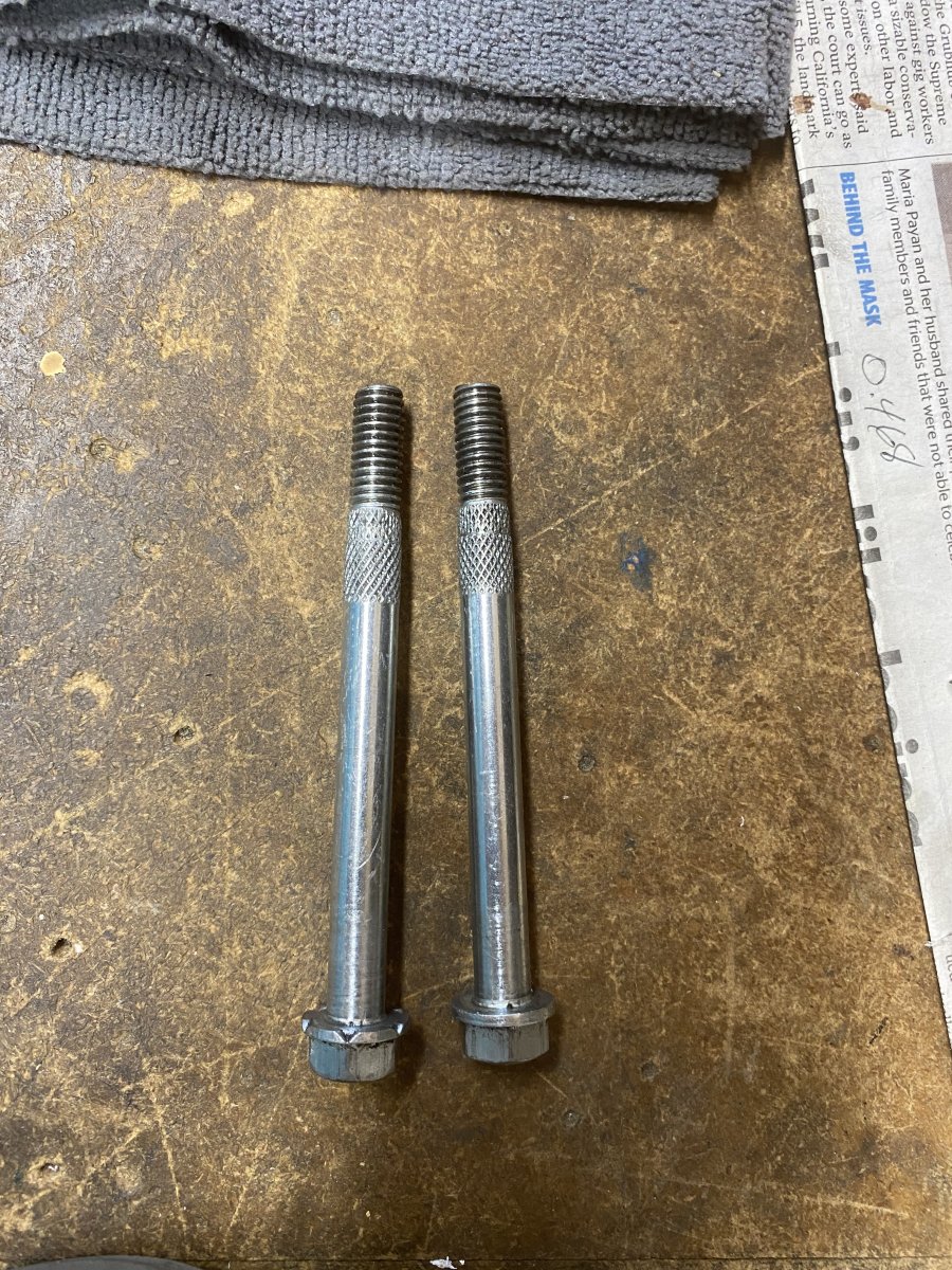

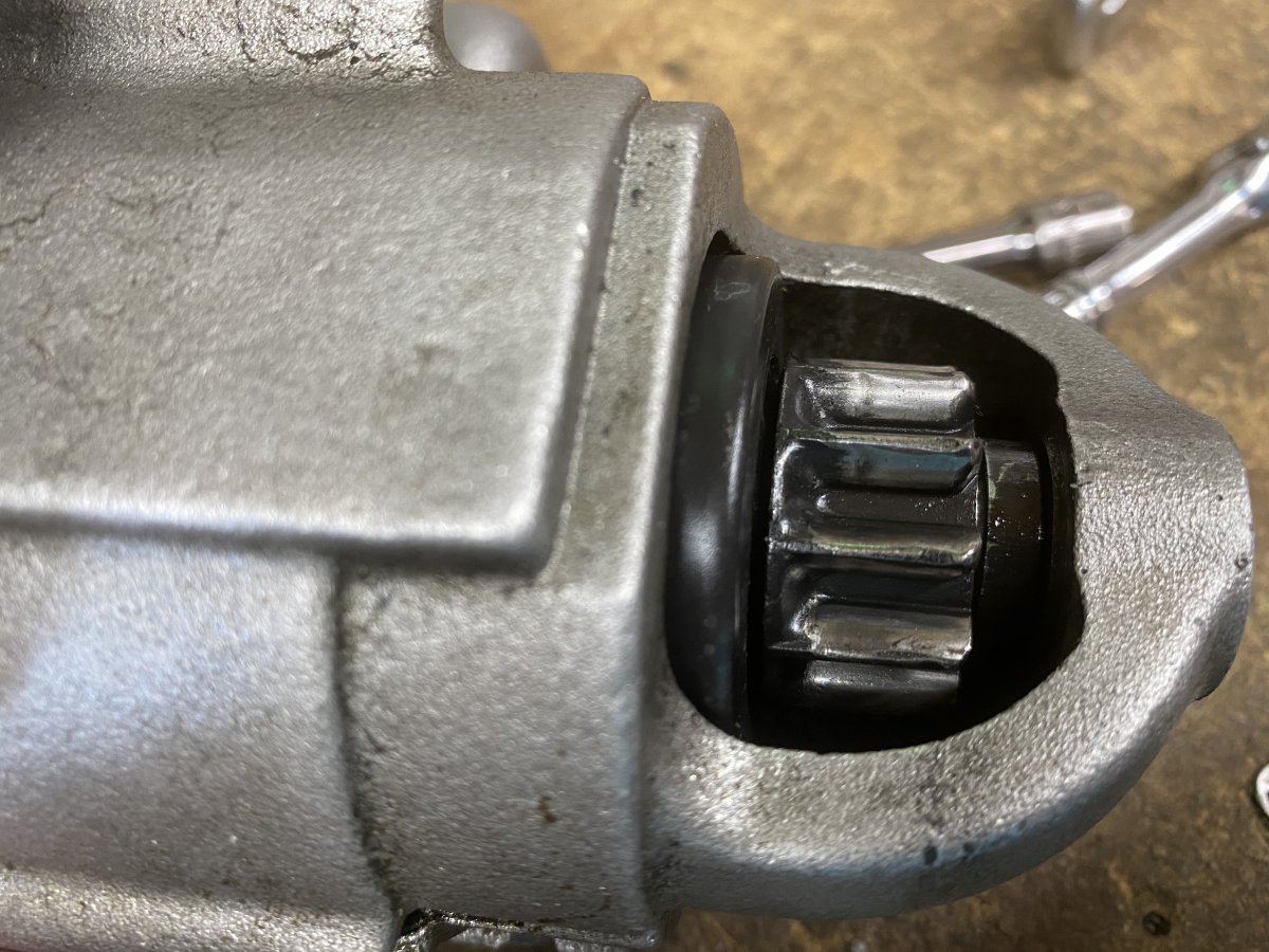

    removed the starter
    gear spins easily, no lubrication issues
    correct knurled mounting bolts
    ring gear like new
    solenoid is/ 66D0CE96-CE13-4DFF-9486-D0CC3FE48E37.jpeg 0C7E2E96-FCE5-4A96-B4A0-B5BCE43E467C.jpeg D202DAB5-0B8F-4DF7-9795-32EF4EA54FAA.jpeg 7857B47D-93EF-477D-93C3-3781BC2AC948.jpeg C6FEF0CC-AAEC-431F-9D13-C34C9F675F6A.jpeg was new about a month ago when I started chasing this issue
    also there is no tail end support bracket, could this be the issue?
    I mic'ed the starter shaft and its 0.468"...can anyone check a stock starter for this measurement...if they are 0.500, that would explain the approx. 1/4" gap between shaft and ring gear.

    The witness marks on the starter gear tells me your getting plenty of mesh maybe too much. Just try shims; like Jim says 1/2 of one mounted on the inside or outside bolt to get it to release when key is turned off. I think everyone is way over engineering this..

    And a shim will move it away and it will release. I also noticed some wear on the starter teeth you are showing. This may have sometimes do with it too. Good luck.

    The starter, what we can see of it, appears to be one of the newer permanent magnet starters? They use metric shank 10mm mounting bolts, and you have 3/8" shank bolts. The correct bolts for that starter have two different knurls, there is a 10mm shank, then it reduces to a 3/8" shank with 3/8-16 threads.

    thats why I love the HAMB......lottsa knowledge here.....these bolts are news to me thanks
