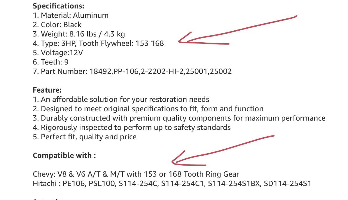

    I have a new Delco starter....the old starter has 11 teeth gear this new one has 9 teeth....the paperwork says the new starter works with either 153 or 168 tooth ring gear....it also says the 9 tooth is interchangeable with 11 tooth.....how can this possibly be true.

    both starters have exact same shaft centerline measured from bolt hole to block mating surface and both shafts mic out exactly the same.
