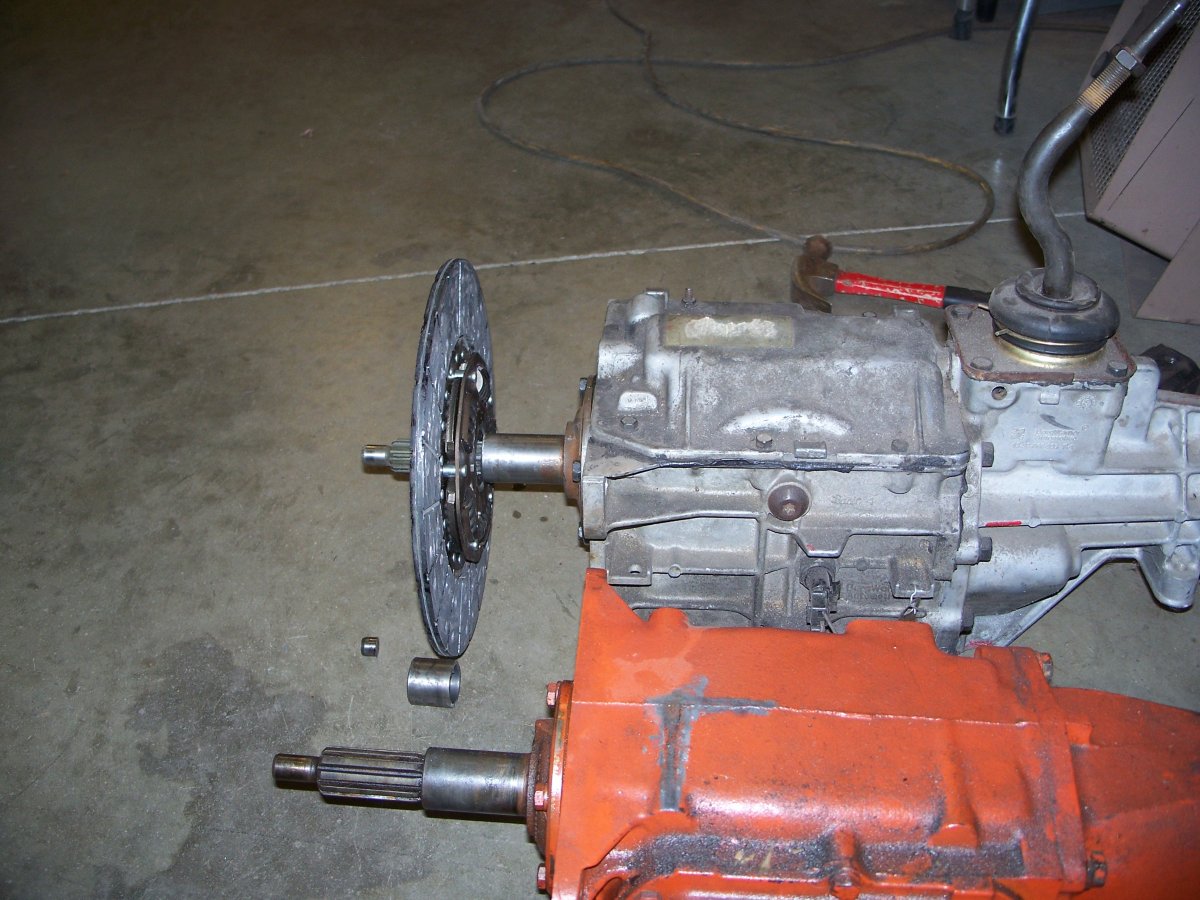

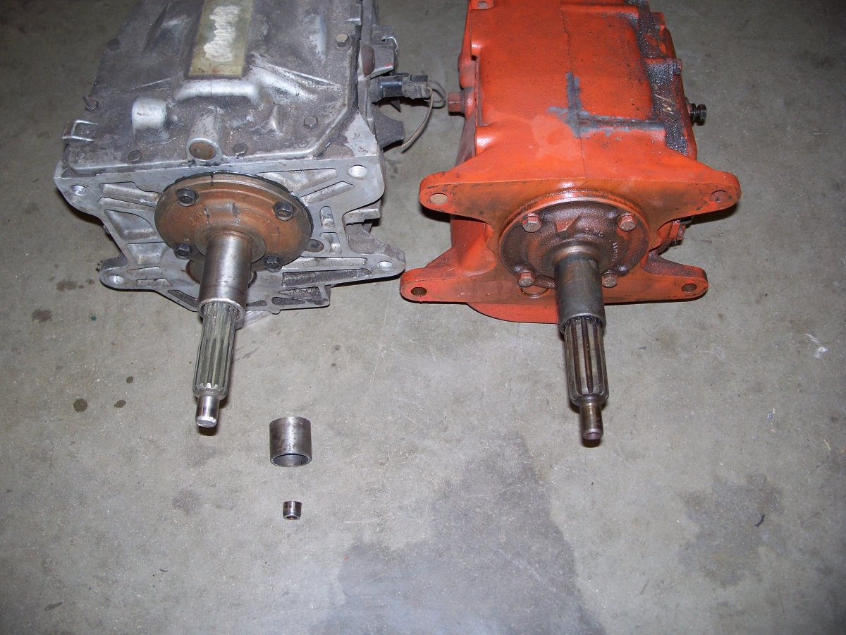

    If you have a S-10 T-5 you may have to cut a 1/2'' off of the input shaft collar, that the TOB rides on, as it may be pushing the pressure plat fingers and slightly engaging the clutch. Read that in the "Ultimate T-5" thread. I have an early S-10 T-5 , a 283 SBC with a mid '60 bellhousing., a 10 1/2" clutch and a spacer between the bellhousing and trans. I did it to mine.
    Lots of good info in that thread.
    Edit: My mistake, the input shaft collar needs to be trimmed because it may interfere with the clutch disc not the pressure plate fingers.
    If you look at S**** Metal 48's pics of how much he cut off the collar on his T-5 without using a spacer there looks to be enough to account for the spacer, usually 5/8" thick, and then some.

    I didn't use a spacer.. I cut the input shaft and cover down to match the 3 speed I replaced and also elongated the splines so the disc could slide back further... **clic pic** T5 install 007.JPG T5 install 008.JPG
    brEad and verno30 like this.
