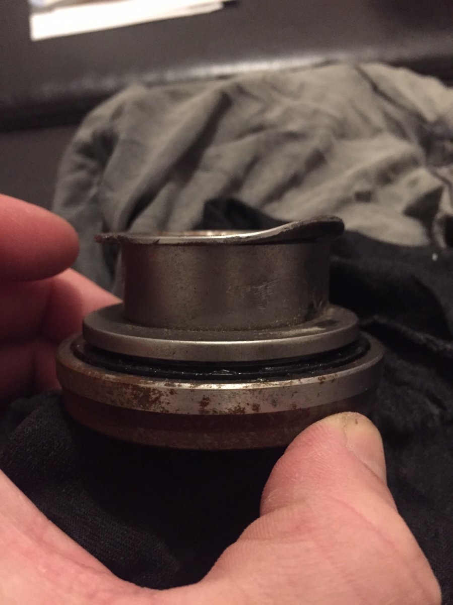

    Ok so don’t ask me how this happens bc it was starlight going in( famous last words) but it’s bent to ****. Got the ****** out and TO bearing, have to take the bell off tomorrow, have a dr appt and started losing feeling in my fingers and toes haha, but this is the beating and any theories how it got bent in open to haha. IMG_2111.JPG

    Bob that adjustable bearing looks like it would work perfect, between that and the adjustable pivot I should be able to get right where I need to be. The clutch is a mustang one bc I needed the same splines for a ford shaft bc the T5 is from a mustang, wanna say it’s an 11” you been back to studio 69 lately?

    I thought I had it pretty square on but obviously something was off, I’m going to pull the bell and clutch out tonight and check everything, but was not sure if I needed to measure anything before I dis***emble it. Figure I would take the bell to work and make a notch in it and then put it all back and check clearances and go from there and hopefully that will do it. Yes Cort left there but I might have Gina do some more work on me next month

    How hard did you pry on the fork? Was it in the direction that it is bent? D

    I didn’t wrench on the pry bar just gave it a tug to see if I had any more movement that it wasn’t fully throwing, but when I was under the truck I could see that it threw the fork pretty much to the bell with about 1/16” of a gap, so thinking it wasn’t the pushrod or slave not throwing it enough
