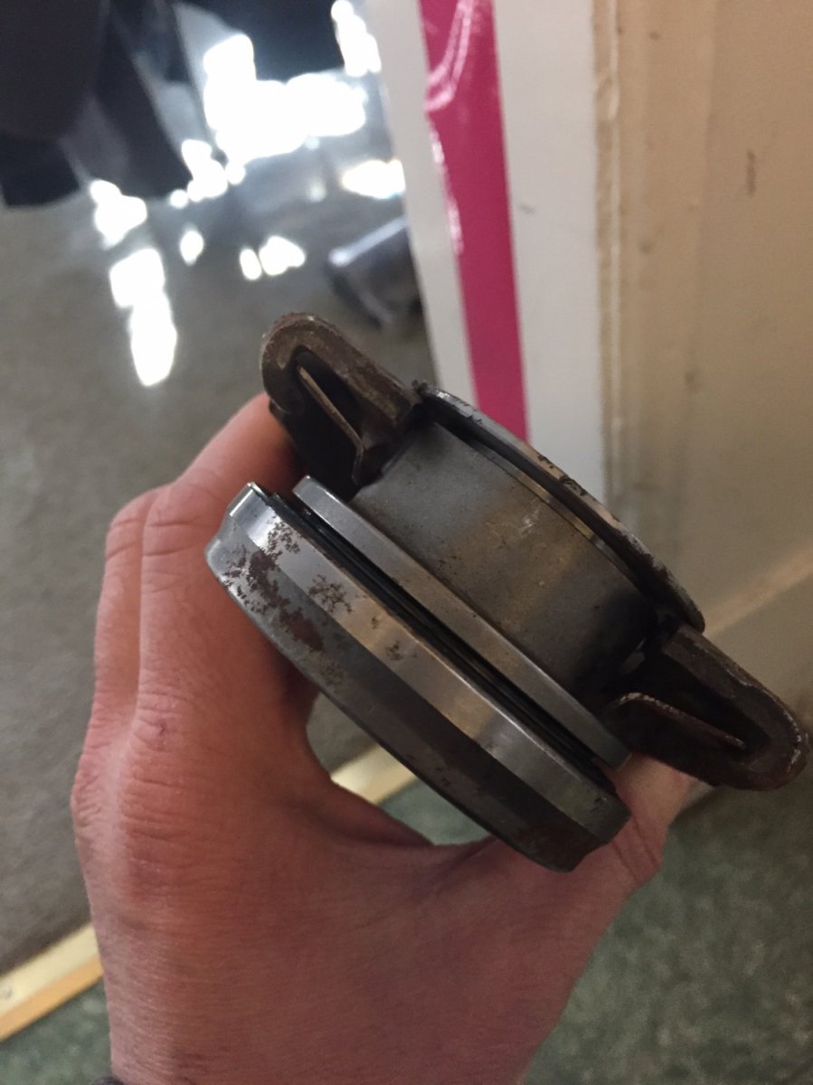

    Ok so got the clutch and pressure plate out and measured both, chances are it’s something obvious but my first time trying to set up a clutch from two different makes and models so go easy please haha, Bob I don’t know exactly where it bent the lip at bc I popped the bearing out when I took the ****** out not knowing it was bent IMG_2113.JPG IMG_2114.JPG IMG_2115.JPG IMG_2116.JPG IMG_2118.JPG

    T/O brg. doesn't go on the fork like that. Someone will post a picture on how it goes. I don't have any pics that I know of. D

    It's backwards and the fork should be in the groove

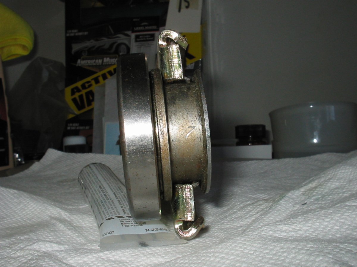

    I did have a fork and a brg. though! That rivet for the spring looks a tad long on the brg side also. D IMG_1332.JPG
    427 sleeper likes this.

    Dennis, you beat me again![emoji106] Jedd

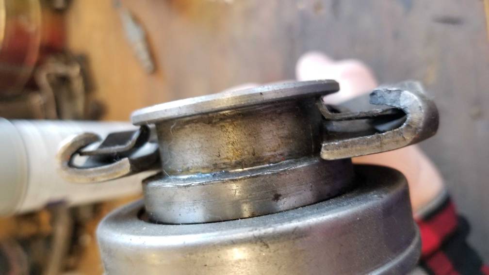

    I am just want to be sure I have it set up right before I do something silly again haha. but thats the correct way to set it in the fork right? will get a new one today, and I am guessing that would cause my problems also.

    The spring clip should be against the collar that got bent up.

    Put a small dab of wheel brg. grease on the end of your pivot ball before you install the fork in the bell. In the picture of your pressure plate, it looks like a ring on the inside of the pressure plate spring. What did it hit, and did it damage the clutch plate? Also, most T/O brgs. have a groove on the inside of the collar that should have grease in it also. Just enough to fill the groove, don't go overboard with it or it can end up on the clutch plate. D

    Center the brg in the fork and make sure the tail of that rivet isn't going to catch the edge of the t/o brg.

    I was concerned about the lip that was bent. Could be the camera angle. D
