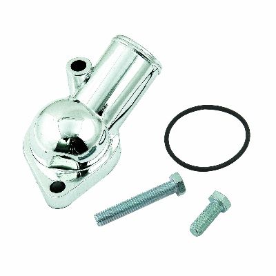

    I have a strange question. I was prefitting the Mr Gasket thermostat housing on my Fenton 3 deuce SBC manifold and it doesn't fit. The bolt pattern on the housing is just a little bit to narrow by about 1/64". I don't understand it. I thought Chevy used the same size thermostat and housing for many years from the W motor to the Gen II blocks. Am I wrong?
    Anyone ever encounter this before? Is there a simpler answer to this or should I just oblong the housing bolt holes? I want to make sure i am not missing something.
    Thanks for your help on this guys.

    I do not think it is the housing. I compared the bolt pattern on the manifold to a Fel-Pro gasket and saw the same thing. The housing and the gasket bolt patterns are identical. I think the housing is OK, I think the quality issue is with the NOS late 60's manifold, unless there is another thermostat housing out there with a wider bolt pattern.

    I know that would be the perfect solution, but for as little as it is off, oblonging the holes in the housing might be the easiest solution and still allow for proper sealing of the gasket.
    Someone on the HAMB has offered to let me try an original housing. That will tell me if it is the housing or the manifold.
    Experimenting on a $13 housing is a lot easier to handle than experimenting on an NOS Fenton manifold.

    My experience with the cheapo die cast chinese housings is that they tend to corrode through and start leaking. If they ever seal at all.

    That particular housing may last one summer,then sitting next winter it will be leaking because it warps.Sorry,but it is a pos.

    Bingo!!! This happened to me recently with a two year old Mr. gasket T-stat housing, I am lucky I was close to home because the engine lost most of the water. Absolute junk. Buy a cast iron one and be on your way.

    I will be buying a proper OE type of housing, one that has enough material around the bolt holes to open them up a little. You guys have convinced me not to use the Mr gasket or anything like it. I have a billet specialties one with an o-ring on another motor and it has been great. No leaks and it has been on and off several times. They are just too big to go under the 3 deuces. Thanks for all the opinions I appreciate the help.

    I barrowed an OE housing and it too was too narrow. It is without a doubt the manifold. I used some calipers and got a real measurement. The manifold bolts are 0.28" too wide for the housing. Just ujnder 1/64 on each side. I am just going to oblong the bolt holes until it fits. Going to order a cast iron unit. Thanks everyone.
