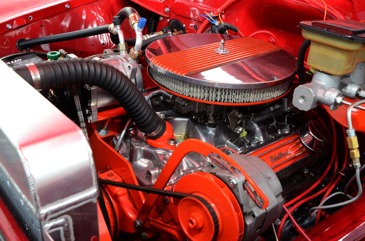

    I agree....the better the car runs.....the better the gas mileage .
    I does sound like the carb needs an accelerator pump....take the air cleaner off, look in the front section of the carb and quickly give it gas...you should see two streams of gas going into the carb from close to the top of the carb in the front barrel section....if no gas streams shoot out....then fix the carbs pump.
    One way to set timing on a chevy is to let the engine go to normal heating....advance the dist a little, when it barely turns over, retard the timing until it starts without going "runt..hesitate...runt" ( turns over like the battery is really weak).
    My vette 327 is set at about 12 plus btdc...and my 283 in my 49 is set at about the same...both run great and start great. engine.jpg
