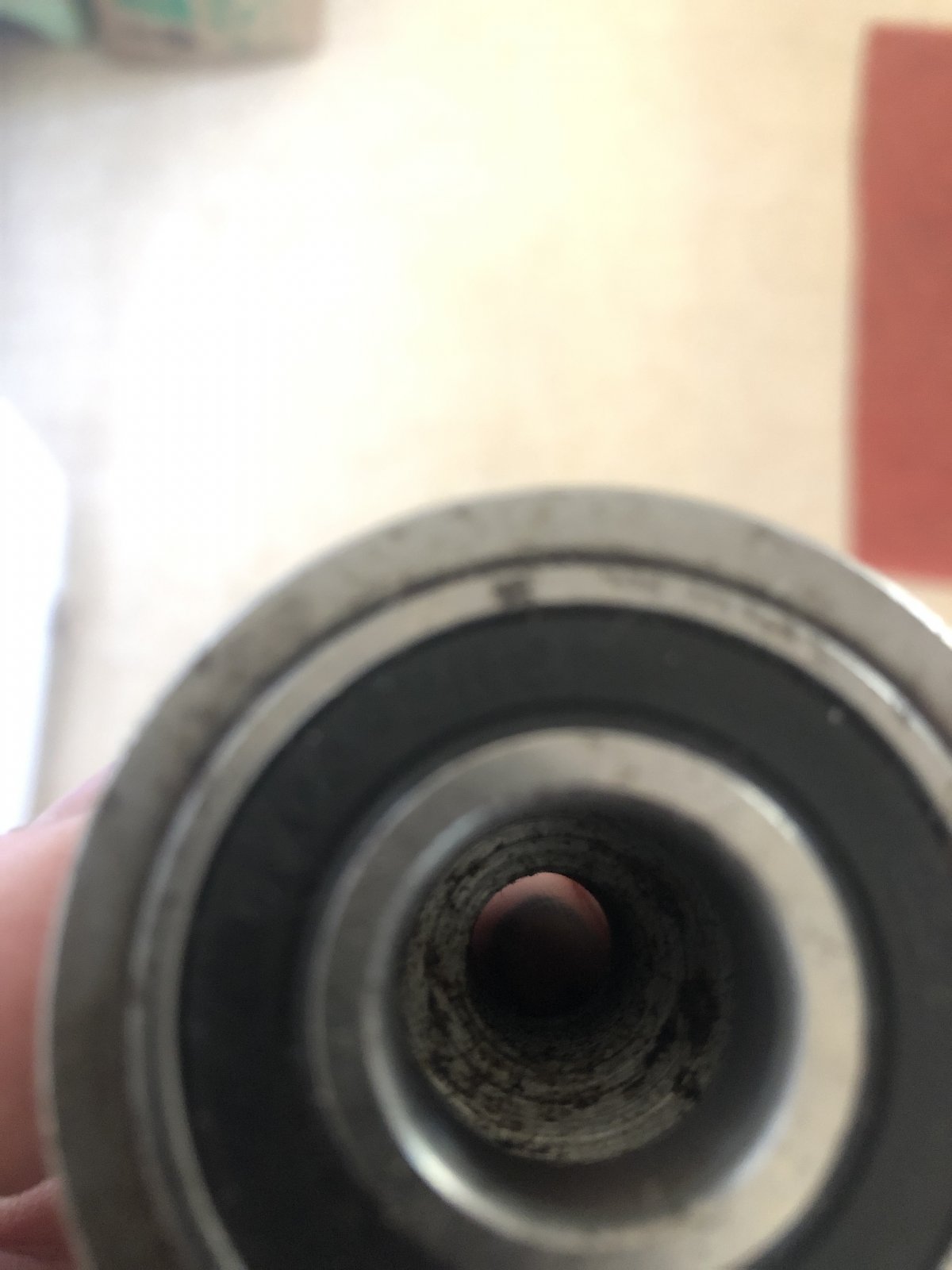

  2. hotdamn
    Joined: Aug 25, 2006
    Posts: 2,651
    hotdamn
    This is the one I have currently.
    53FD67A3-3502-45BB-95BD-2E4C7C1C7D38.jpeg C8A45FD7-7DAA-4384-81E4-139C7CA1632C.jpeg

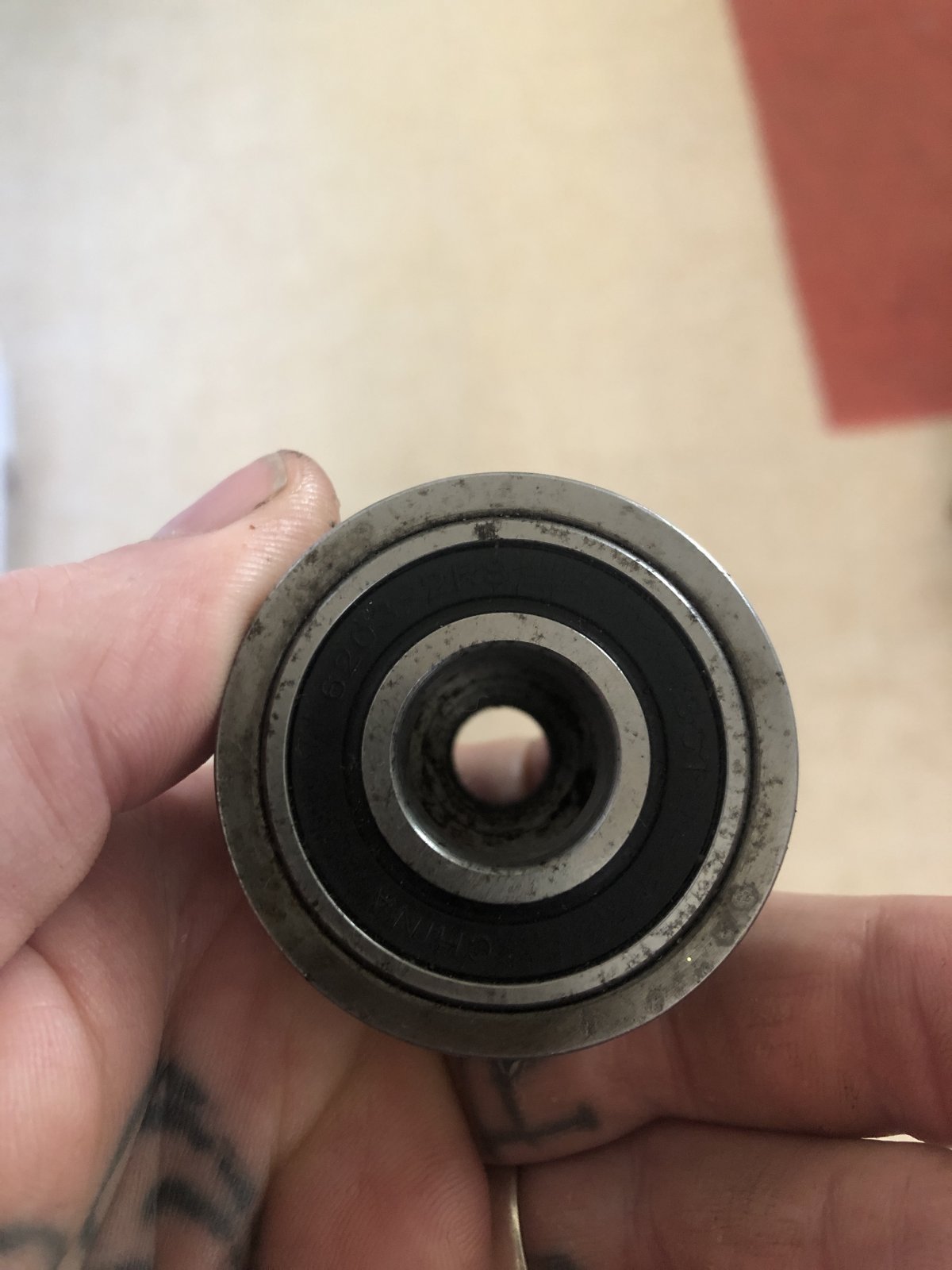

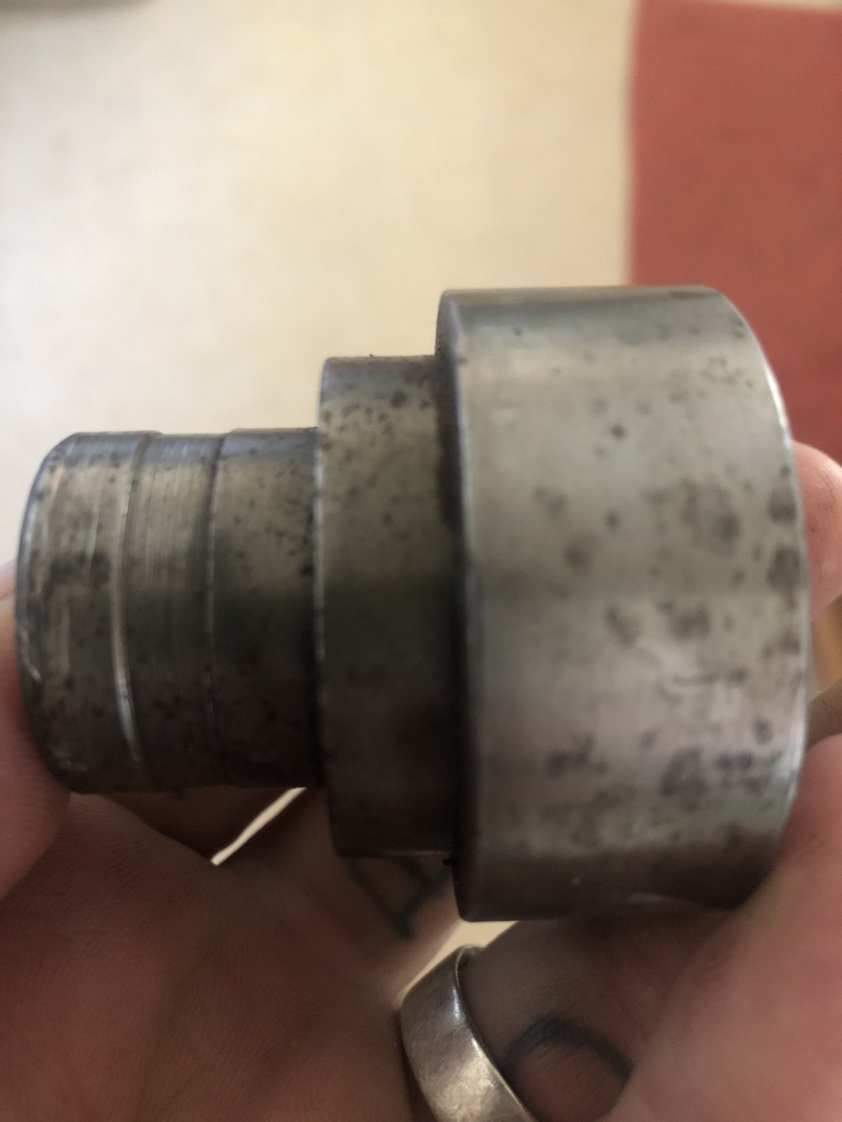

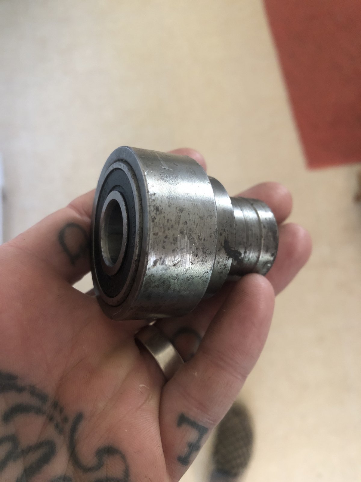

  3. hotdamn
    Posts: 2,651
    hotdamn
    What I’m looking for is something more like this one I have to put an olds motor in front of an early ford trans.

    Chevy used bronze bushings for years without issue so I guess the question is why is this application wearing the bushing out faster than normal?
    Measure the outside diameter and the inside then grab a bearing catalog start looking at the size OD sizes to see if one has the the ID and width you need, stacking 2 thin bearings may be a route to take if needed.

  15. hotdamn
    Posts: 2,651
    hotdamn
    yeah I’m just going to have to make one.
    It’s not just the bearing ID and OD it’s the length too.

  22. hotdamn
    Posts: 2,651
    hotdamn
    Based on how the one for the olds motor is made it steps up so I don’t think that will be much of an issue. image.jpg image.jpg

    A ball bearing isn't going to work.
    The measurements of the Speedway bushing are
    • 1.093" O.D.
    • .671" I.D.
    • 1.45" long
    Johnny Gee and Desoto291Hemi like this.

    that’s a fair point that I hadn’t thought of.
    That said I also know that the input shaft isn’t long enough to completely engage on this set up too hence the length in the adaptor so I’m feeling suspect about that.
    All that said ben shared that his Yblock in his car did the same thing and once he swapped it
    For a roller bearing he hasn’t had any issues since. The belief is that the adaptor made from bronze has too much deflection in it and one made from steel would obviously have less. Makes sense in theory
