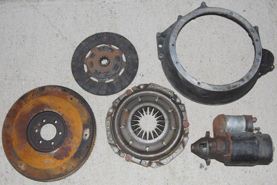

  11. Rem
    Joined: Mar 6, 2006
    Posts: 1,257
    Rem
    This is a set-up I have for a project-in-waiting. The flywheel and starter are Chevy, I'm sure, and the clutch disc appears to be early Ford, but I don't know about the pressure plate? It doesn't look like any of my Ford ones?
    This was a set-up from a running car I'm told, so should just bolt in. Is there any reason why the block-mounted Chevy starters can't be used with these? The nose is presumably in a similar location as the flywheel will be the same as a later Chevy? It would make life easier for the adaptor, and also be easier to source a replacement starter if needs be?

  13. Koz
    Joined: May 5, 2008
    Posts: 2,774
    Koz
    Rem, Looks like you have a Chevy diaphram PP there. It should work as long as it lines up and is at an acceptable height to work with the Ford throwout bearing. You can use the later Chevy starters with the later adapter as well. You usually have to do a bit of "clearance" work with a die grinder on the Cragar style 'bell you have there. I will say the earlier three bolt starter is readily available and works much better. You have to drill the top starter bolt hole to take a 3'8" thru bolt on most of the adapters. Putting them on without doing this is an absolute PITA!
    I've used a number of different PP thought the years, the Merc. being the easiest and works the best. The Ford with a redrilled flywheel is eaqually good, and the easiest to find. Everything else is a bandaid to one degree or another. Remember the Ford/Merc PP was designed to work with the clutch geometry in the early Ford trans and as such, just seems to work best with the least amount of rigging.
    We have had some success in using 11" GM PP with a 10 1/2" Ford disc in the earlier adapters using the Powerglide ring and a 1/4" aluminum spacer against the block, This was pretty much "race only" territory though.
    PM me if there's anything I might be able to help with.

  27. Rem
    Joined: Mar 6, 2006
    Posts: 1,257
    Rem
    Thanks very much for your help on this. Just for reference, do you have a pic of the earlier type adapter set-up that you mention?

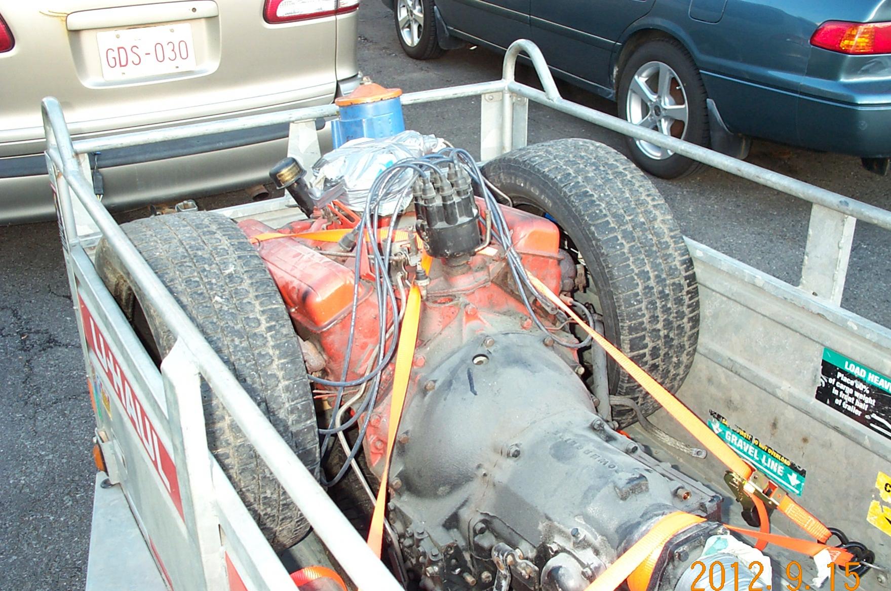

  30. 2935ford
    Joined: Jan 6, 2006
    Posts: 3,848
    2935ford
    Here is my 265 w/PG trans. Is that adapter used for the PG what I need for the Ford top loader?
