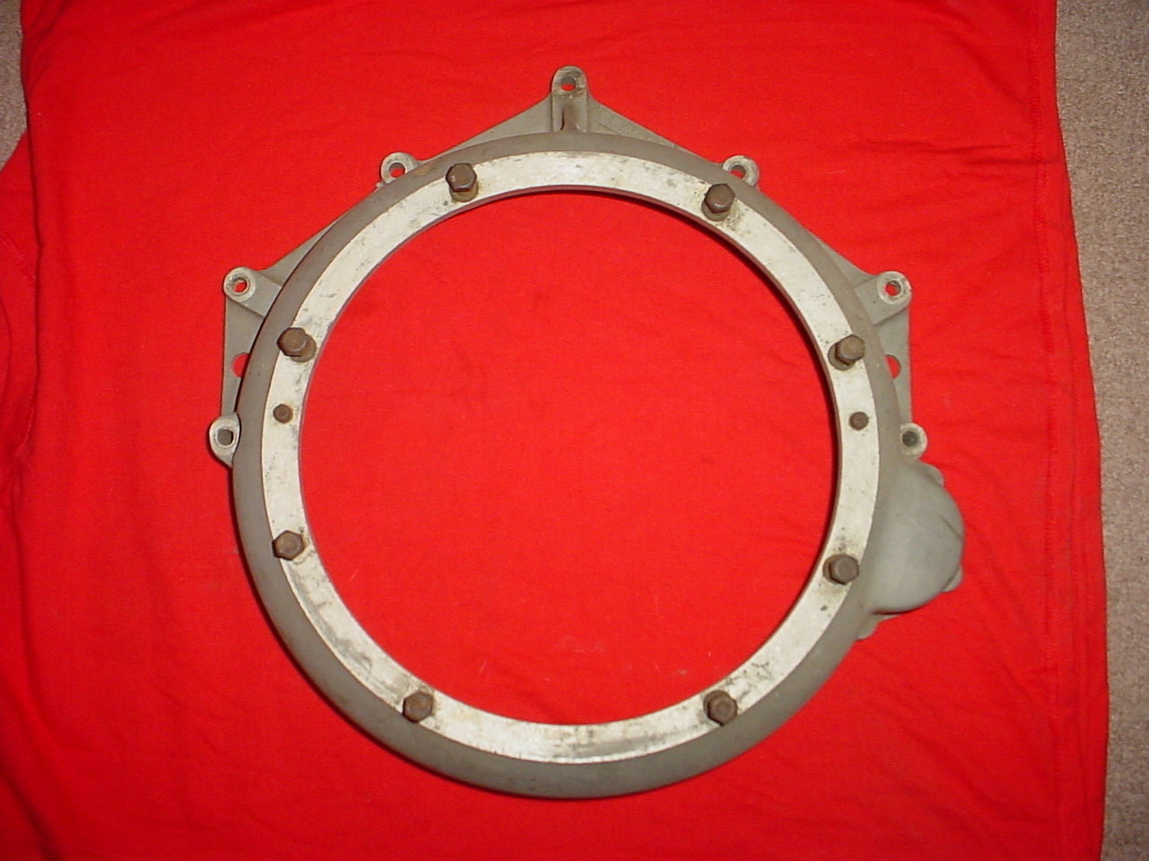

    Or this is what I need?

    The Mercury PP was used because it bolted up to the Chevrolet flywheel. The only flywheel Chevy made back then. So you were forced to use the 3 bolt starter motor to turn it over....the only starter motor they made back then.
    Sure you can redrill a newer flywheel to take the Mercury clutch and use the modern bolt to the block starter motor to turn over the modern flywheel. The throwout bearing is determined by the clutch fingers. Sounds like a lot of trouble to me when the old parts are not that hard to find. Why complicate it when it was all worked out before you were born.:D

    I'll be getting the adapter and I already have a Ford PP and 10" clutch disk. I will also need the pilot bushing from Speedway.
    I can adapt this to either of my two of my current projects and I need to decide which one. I'm thinking now it will be to my '29 Roadster as it has a rebuilt 78 open drive case with a rebuilt '39 banjo converted to open drive.

    Thanks for the pic of the P/G adapter - I'd never seen one before. As not every other car over here runs an SBC, all that I'd ever seen or dragged out of a scrapyard had aluminium P/G, TH350 or manual boxes. And in 30 years since my first Chevy, the 3-bolt starter in that set I bought was the first one of those I'd ever seen :)

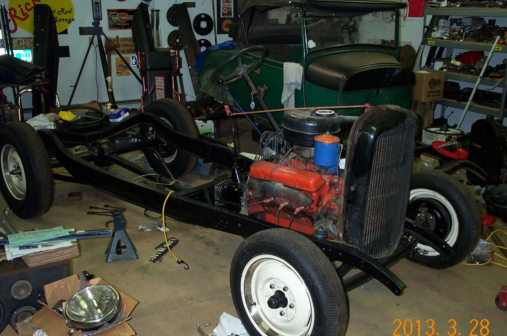

    Well, I have the engine/Cragar trans adapter and Hurst mount all mocked up with the rail mounts in. Sure is a nice fit so far.
    Question:
    Just for giggles....I put the chatter rods through the inside holes and it sure looks like it oughta just bolt right up to each of the side bolt holes over from top on that Cragar adapter! Yes.....no?
