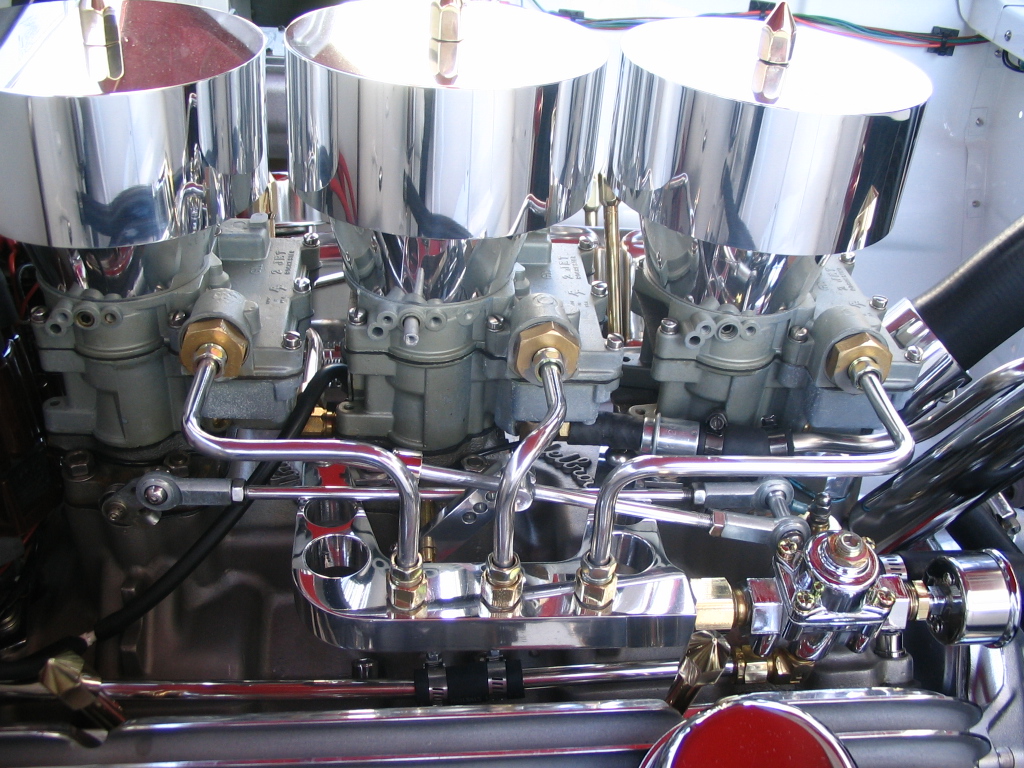

    Here is a pic of mine, I have been running this set up for several years. You can see the regulator just in front of the block deck, its shiny with a touch of orange silicone to keep the knob from rattling. I have to run it or the stock pump overcomes the needle and seats and it will flood. I also run mine with only 2 pounds of pressure. I believe the reason for this is my stock model A tank has a pretty good head pressure when it arrives at the pump. Never any problems with vapor lock but I am running hoodless so no built up heat involved.

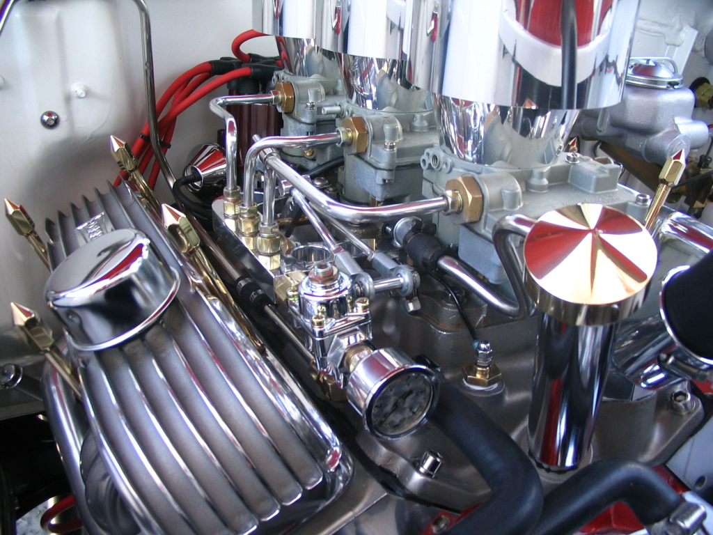

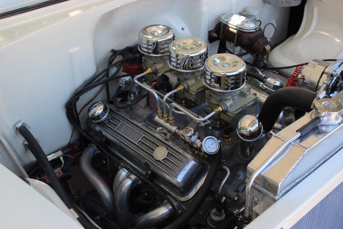

    You can see in the pics that I'm routing the fuel line back from the pump up to the filter on the firewall, then down along the area between the valve cover and intake to the "low pressure" regulator. Never had an issue with vapor lock or anything yet and its seen plenty of extended highway driving. One thing I don't like, and this may be because of the restrictiveness of the regulator, is that when under full throttle it will "run out of gas" by draining the carbs faster than the regulator can pass fuel on to all three carbs. I could barely complete a full 1/4 mile pass with this setup. Probably need a seperate regulator for each carb to solve the problem?

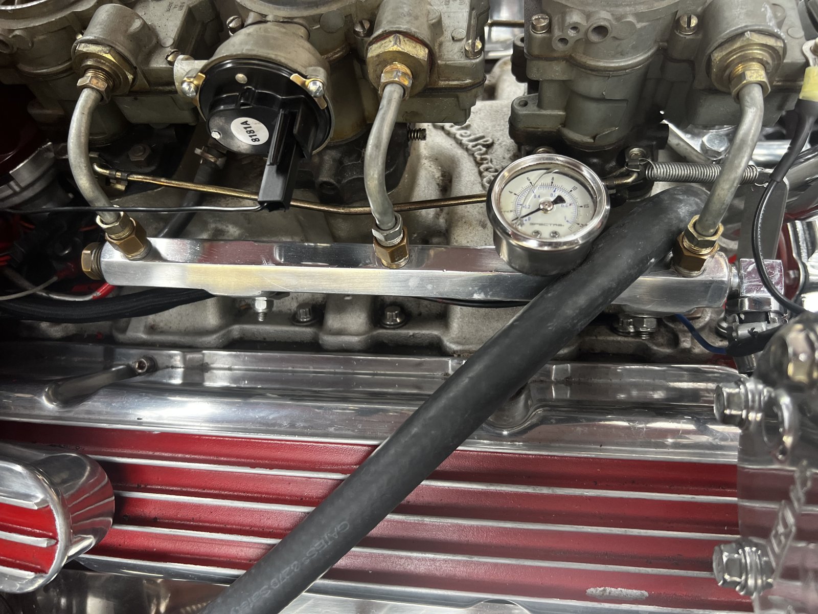

    Yes, Get a good modification kit and change the base plates and butterflies so that they seal and only work as dumpers. The kit with all linkage and the fuel bock and lines is about $400 and well worth it. If you look close, you can see that all of the old screw holes are plugged and capped. I run 5-6 1/2 psi on mine and it does just fine without any regulator. The 2GC and 2G carbs were made to run that pressure. My tank is in the rear and just a bit above the engine. Coupe engine right side.jpg

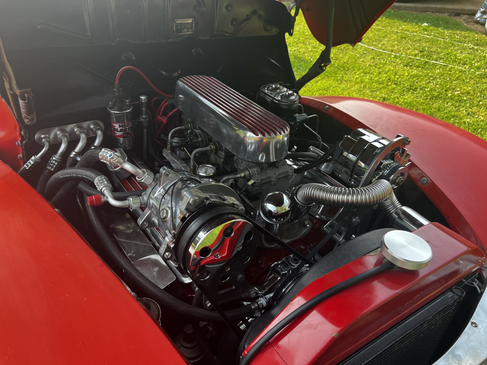

    I have tri power setups on a sbc in my '40' Ford and my '55' chevy. I use a regulator on both with pressure set between 3 and 4 pounds. Both run and idle great with progressive linkage. IMG_0222.JPG

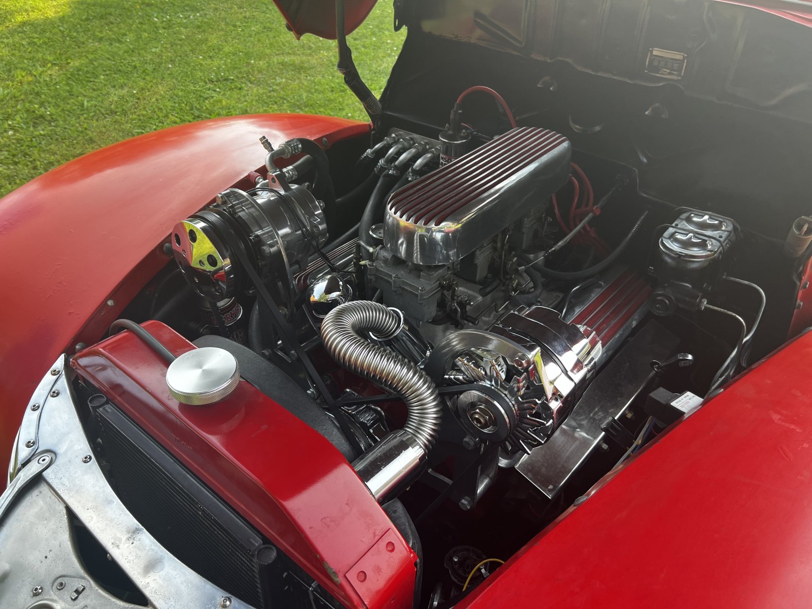

  21. I'm having some issues with my 40
    I’m having some issues with my 40 Ford running Rochester 2g setup. It always ran a little rich and I couldn’t do parades because it would backup. I’ve added AC and some other things now of it is too warm out(everyday in Tennessee) I’m not even able to enjoy my AC because my temps are getting to hot. My fuel is boiling if I have to drive someplace slow like in a park or I have to sit too long at a light (everyday in Tennessee) my heat rises and about 190-195 it has a hard time running. The fuel starts backing up and flooding. 195 isn’t really even close to hot but my fuel isn’t liking it in the slightest bit. I had put on a tri-power single helmet air cleaner and went back to my frog face air cleaners, I installed Phenalic Risers from Dashman. When I installed the AC I also installed the proper parts that go around the radiator and the pan under it that I never had before to direct all of the air directly into the radiator. I have a Walker radiator but was told to go to an aluminum radiator because it will run cooler. I have a regulator I’m getting ready to install but I’m trying to find a place to install it at and where to run the lines as in before or after the pump. The new fuel pump I put in says I’m running 7psi and from reading that is about double of what I should be running. I don’t know if the gauge is right or not but I’m sure I will see when I put in the regulator because it has a gauge as well. IMG_8765.jpeg It’s strange I never had this problem in the last 4 years other than parades and such. Where is the best place to run the regulator after the fuel pump or before it? I am going to run it deadhead
