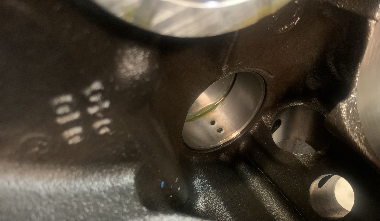

    That rear bearing with two holes in still has me concerned or am I overthinking this?? IMG_4569.jpeg

    You need to knock that rear bearing out and check how the block is machined. That's the wrong bearing for any 350 SBC, and should have a single hole centered. The 2 hoes wont align with the oil p***ages and can cause major issues.

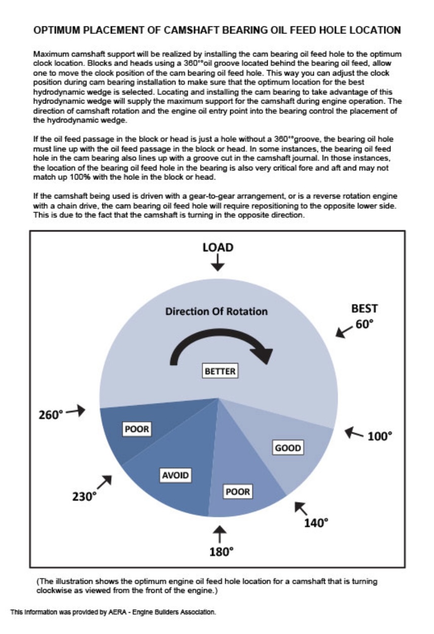

    Exactly. Get that bearing and the others out of there and put in a standard set for a 350. As for the oil hole location, 350's have the cam bores in the block grooved in the center all the way around. You'll get oil anywhere you clock the bearing BUT it works very well to put the oil holes at about 2 o'clock as viewed from the top front of the block. Just make sure the holes line up in the grooves.
    Just.dale and Johnny Gee like this.
  4. Johnny Gee
    Joined: Dec 3, 2009
    Posts: 14,422
    Johnny Gee
    from Downey, Ca
    ^^^^^ Never place oiling hole at 6 o’clock!

    I was always told to put it at the 4 o'clock position to introduce a better cushion of oil to the journals. Any truth to this? It makes sense to me, in a strange way...

    Interesting. Most of the SBC’s I’ve seen over the years had the oil feed holes around the 100* mark.

  16. Ericnova72
    Joined: May 1, 2007
    Posts: 673
    Ericnova72
    from Michigan
    Make sure you got that rear cam bearing correctly installed....the location of the one with 2 holes, as pictured, is not driven in far enough by nearly 1/4" to 3/8"....you can see part of the annular feed groove machined in the block showing broad daylight right behind that bearing!
    ATK didn't even install the wrong bearing correctly, it would have a huge internal oil leak out the back edge of that bearing.
    Always take a wire or hooked pick to feel and be certain the oil hole is aligned over the feed groove correctly.

    Thanks, I used a small Allen wrench to make sure I was in the groove on each bearing.
